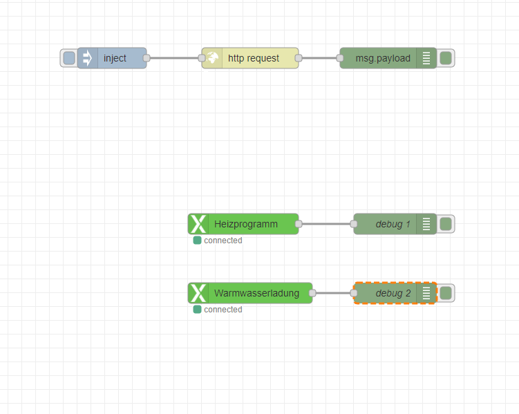

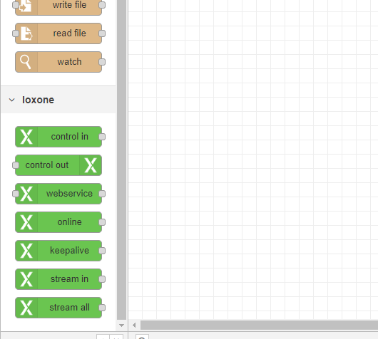

    Ok, i just installed that. Now i've got the loxone nodes on the left side and I'm receiving the numbers from Loxone. How can i connect the input from Loxone to the inject button?

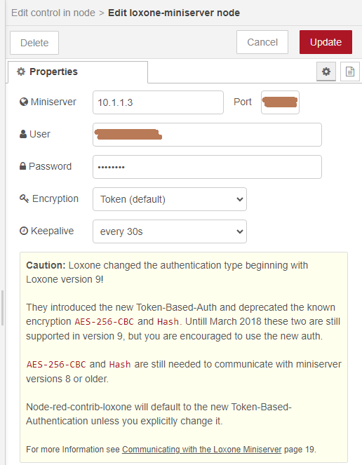

      In Node-Red, drag in a Loxone 'control-in' node. Click in the control-in node and select the Miniserver entry and 'add new loxone-miniserver'. Select the edit button and add the credentials for the Miniserver including IP, Port, Loxone Username and Password, Token etc.
Name: Miniserver credentials.png
Ansichten: 143
Größe: 43,3 KB
      Select Update, then do a Deploy in Node-Red. From this point, you should be able to link anything that is visualised within Loxone.

        Ok thanks, I managed it to get the values from Loxone to Nodered. How can i forward the value to the inject button?
    • Tico
      • 31.08.2016
      • 1035
      Try this flow connected to your existing control-in node -
      Klicke auf die Grafik für eine vergrößerte Ansicht  Name: Full flow.png Ansichten: 0 Größe: 13,0 KB ID: 434707
              "id": "4606eeeab464f2f0",
              "type": "inject",
              "z": "e2778122e634373b",
              "name": "",
              "props": [
                      "p": "payload"
              "repeat": "",
              "crontab": "",
              "once": false,
              "onceDelay": 0.1,
              "topic": "",
              "payload": "2",
              "payloadType": "num",
              "x": 150,
              "y": 260,
              "wires": [
                      "3bdb74c4ed8d45c4"
              "id": "3bdb74c4ed8d45c4",
              "type": "change",
              "name": "Set OID and Value",
              "rules": [
                      "t": "set",
                      "p": "payload",
                      "pt": "msg",
                      "to": "$string('{\"OID\":\"/1/15/0/3/50/0\",\"value\":\"') & $string(payload) & '\"}'",
                      "tot": "jsonata"
              "action": "",
              "property": "",
              "from": "",
              "to": "",
              "reg": false,
              "x": 340,
              "y": 260,
              "wires": [
                      "adc9bb5d3e224e97"
              "id": "adc9bb5d3e224e97",
              "type": "http request",
              "name": "",
              "method": "PUT",
              "ret": "obj",
              "paytoqs": "ignore",
              "url": "http://192.168.178.71/api/1.0/datapoint",
              "tls": "",
              "persist": false,
              "proxy": "",
              "insecureHTTPParser": false,
              "authType": "digest",
              "senderr": false,
              "headers": [],
              "x": 540,
              "y": 260,
              "wires": [
                      "96ea6ace2ef8df97"
              "id": "96ea6ace2ef8df97",
              "type": "debug",
              "active": true,
              "tosidebar": true,
              "console": false,
              "tostatus": false,
              "complete": "false",
              "statusVal": "",
              "statusType": "auto",
              "x": 740,
              "y": 260,
              "wires": []
      Zuletzt geändert von Tico; 16.06.2024, 15:11.
      • Fendt43
        Fendt43 kommentierte
        Thank you very much! Now it works perfectly fine!
