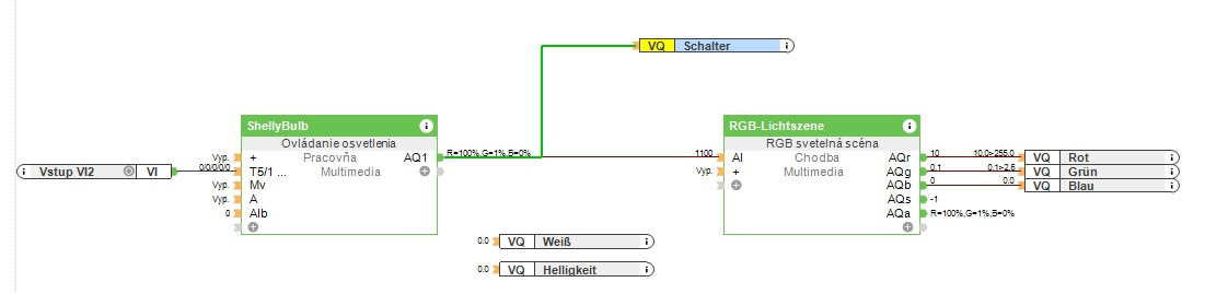

        Hello Guys, Sorry for english
        I have read almost all regarding shelly bulb here. Many thanks for help especially to AlexAn
        I have tried to implement bulbs to Loxone based on loxwiki templates and all is working but to be honest is so much confusing I suppose.
        To Opet
        He wrote: If I tap the light bulb (light control) in the lox app and want to change something, nothing works anymore.
        It was also me case and it confuse me. If I understand to Opet well he means if he change in loxone app for example color of bulb of course nothing works becasue Light controller output AQs is connected to switch (Schalter) and if you change color of bulb in any scene manually in loxone app output AQs =-1 and it means switch is off so thats why bulbs do nothing,
        I am aware that it is only suggestion config from AlexAn and each one can do it any way. But to avoid any confusion It should be so nice if anybody can share final config for bulb and RGBW2 where you can control from loxone app as it is Loxone device (mean no additional outputs in loxone light controller as schalter, Helligkeit and Weis dimmer...)
        to Gast
        In this threat on page 26 he wrote how he did it and I have also tried (see picture below) same and looks like it is working well (except some small issues) but I am sure you have already final working config.
Name: 01 forum.jpg
Ansichten: 1310
Größe: 42,7 KB
        So can somebody post final working config for Shelly Bulb and RGBW2 dimmer to be able to controll them from loxone app as it is original loxone device please?
        Many thanks for help.

        Ehrlich gesagt ist die Leuchtkraft der Bulb ziemlich schwach und ich möchte da keine Energie mehr reinstecken.
        Lösung für den Schalter hab ich einfach so umgesetzt in dem ich die aktuelle Szene den Schalter aktivieren lasse wie im Wiki:
        Klicke auf die Grafik für eine vergrößerte Ansicht  Name: Bulb.PNG Ansichten: 0 Größe: 50,7 KB ID: 248968
