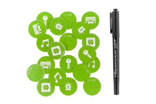

    wir haben den Zutritt zu unserem Haus über den NFC Code Touch geregelt. Am Schlüsselbund haben wir jeweils die NFC Tags von Loxone. Dies funktioniert auch sehr gut.
    Nun unterstützt das iPhone leider die Entsperrung der Tür über das NFC Modul. Gibt es vielleicht ein sehr dünnen NFC Tag? Oder einen Aufkleber, den man an die Hülle kleben kann? Um damit über den NFC Code Touch die Tür zu öffnen?

    Von Loxone gibt es ja auch die aufkleber, muss ja nicht der schlüsselanhänger sein.
    z.B.
    With the new NFC Smart Tags and your Android device you have Smart Home functions to stick on! By touching a smart tag with an Android smartphone, you can carry out any action at lightning speed: open the garage door, activate or deactivate the alarm, navigate to a position in the app ... lightning-fast control of light, garage door, shading and much more.lightning-fast navigation in the appjust stick it anywhere - on the wall, in the car, under the tableSimply create commands via the Loxone app and save them on NFC TagAuthentication via the Loxone app. For security-critical applications, we recommend using our encrypted NFC tags.25 robust NFC tags to stick on with smart home icons and to label yourself (with a suitable permanent marker)  NFC Smart Tags - Smart Home functions for sticking on Get even more functionality into your smart home with your NFC-enabled Android devices. You can stick our new NFC Smart Tags everywhere and carry out Smart Home functions at lightning speed or navigate to the app! Perform functions at lightning speed Use the NFC Smart Tags to trigger functions in your smart home at lightning speed. Approach your NFC-enabled device to the day, e.g. next to the garage, to open your garage door Navigate in the app Use the NFC Smart Tags and your NFC-enabled device to quickly navigate to a room or category in the free Loxone app to operate your Smart at lightning speed.   Here’s how it works Simply deactivate the lock of your smartphone and hold it with a sticker, the app starts automatically and navigates to the desired destination, such as video intercom or executes commands. Simply teach in commands How to turn the NFC Smart Tags into smart helpers in the Loxone Smart Home. STEP 1: Open the app Under Settings you will find under Tools “NFC”. Open this menu item. STEP 2: Choose action Would you like to select a position in the app to which the NFC tag should lead you or to execute a command - lights on or blinds down ...? STEP 3: Record Navigate to the desired position or execute a function and save it. STEP 3: Learn the day - done. Now take a pre-printed day or label an unprinted one for your Smart Home function to stick on.   scope of delivery 25x NFC stickers printed (see pictures) 1x waterproof permanent marker
    Du kannst auch andere NFC tags verwenden ...
    Chipsatz: NXP MIFARE® DESFire® EV1 2K
    z.B.
    https://www.nfc-tag-shop.de/NFC-Stic...te-weiss/68316
    ich kann nicht sagen, ob statt 2k speicher bei loxone auch welche mit 4k speicher funktionieren. wüsste nicht weshalb nicht, müsste man probiern.

      Mehr Speicher ist kein Problem. Es wird ein verschlüsselter Code darauf geschrieben - muss nur etwas Platz darauf sein (falls schon für andere Zwecke genutzt, bei neuen Medien kein Problem).

      Achso, also funktionieren auch die Aufkleber genauso wie die Tags von Loxone?
      Ich dachte die funktionieren andersrum. Man hält sein Handy dran und dann wird eine Aktion ausgeführt....
        simon_hh kommentierte
        geht beides:
        Du kannst mit Android die Aufkleber einlernen und dazu eine Aktion in der app starten ODER
        den Aufkleber, wie den Anhänger nutzen und einem Nutzer bzw. NFC Code Touch Taster zuordnen und damit die Haustüre öffnen, oder Alarm deaktivieren.
        Ist auf der Webseite etwas verwirrend. Ich dachte genau so, wie Du... weil es auch so auf der Webseite beschrieben ist. Aber es funktioniert beides...

        Moment mal ... da gibts 2 verschiedene ...
        Diese sind NXP NTAG 216
        Nutzen Sie die NFC Smart Tags um blitzschnell Funktionen in Ihrem Smart Home auszulösen.
        und diese da sind NXP MIFARE® DESFire® EV1 2K
        https://shop.loxone.com/dede/nfc-sma...s-encoded.html
        Musst die richtigen kaufen.
        du benötigst natürlich dann die desfire-dinger

            Ich hätte sonst diese hier an mein Handy geklebt:
            Aber stimmt schon.. Wahrscheinlich gibt es dann Probleme mit dem Bezahlen mit dem Handy!

              Ich bezahle mit dem Handy (iPhone) in dem man die obere Ecke an den Kartenleser hält. In der unteren Ecke habe ich in die iPhone Hülle einfach den NFC Klebetag von Loxone geklebt. Demnach braucht man zum Tür öffnen das Handy nur mit der unteren Ecke an das NFC Touch zu halten. Beides klappt ohne Probleme. Der Bezahlvorgang ist dadurch nicht beeinträchtigt.

                Meine Frau Verwendet den Aufkleber innerhalb einer dicken Silikon Handyhülle (iPhone)
                Ich hab ihr den Aufkleber aber nur reingelegt ohne ihn anzukleben. (im unteren bereich vom Telefon)
                Funktioniert prima, auch mit ApplePay

                  Hintertupfing Welchen NFC-Aufkleber von den oben genannten hast du in die Silikon-Handyhülle reingelegt?
                • Hintertupfing
                  Hintertupfing kommentierte
                  Dass ist der Grüne dünne Aufkleber mit dem Schlüssel drauf. War im CodeTouch mit dabei.
                  orli kommentierte
                  Genau der ging bei meinem iPhone mit Lederhülle garnicht.

                Ich hatte vor langem auch mal ein Tag in der Hülle.
                Wichtig war das der Tag für metallische Oberflächen geeignet ist, sonst schirmt das Handygehäuse anscheindend zuviel ab.

                  Die Loxone Aufkleber unten am iPhone und das ganze in einer stabilen Hülle funktioniert tadellos!
                  Die Antennen für Apple Pay sind ganz oben eingebaut, daher kein Problem!
