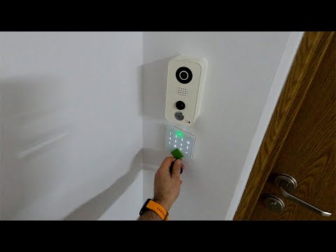

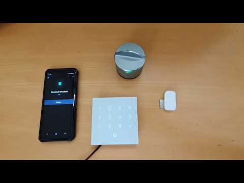

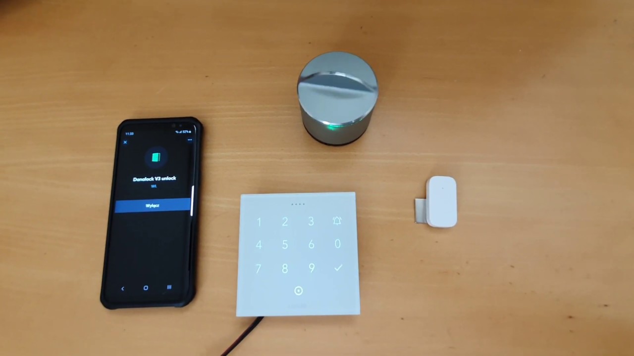

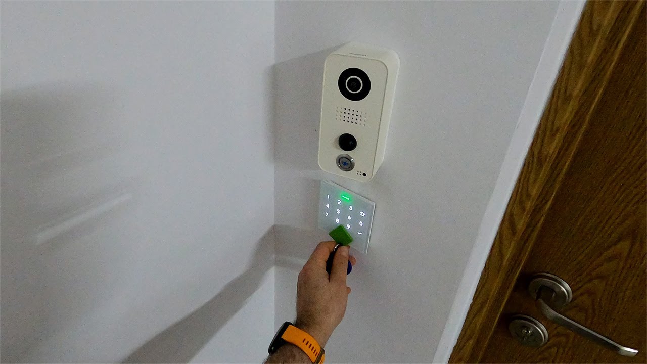

                Ich möchte keinen neuen Thread starten, also schreibe ich hier dass ich Danalock in Loxone integrieren konnte.
                I didn't want to start a new thread, so I'll just write here that I was able to integrate Danalock with Loxone.
                Featuring: Loxone NFC Code Air, Danalock V3 Z-Wave (branded as Gerda Lock V3 Z-Wave), Aqara Door Sensor ZigBee.
                Made with FHEM + Z-stick Gen5 and deCONZ + Conbee II.
                Communication with Loxone over MQTT using MQTT Gateway (LoxBerry plugin).

                  And that's how it works in real life:
