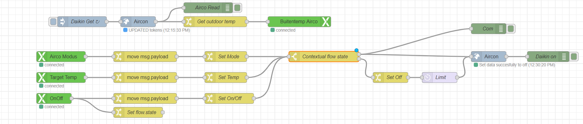

            Hi @Maarten.Provo,
            großartig! Kannst du uns bitte die Anbindung über NodeRed näher erklären. Welche Flows importierst du dazu? Was braucht man dann insgesamt um von NodeRed auf die Daikin Geräte zu kommen.
        • #37
          Is it ok if I write it in English? Otherwise I'll have to use Google translate.
          You need these two palettes in Node-RED:
          • node-red-contrib-daikin-cloud
          • node-red-contrib-loxone.
          Input you need in Node-RED from Loxone:
          • Mode (auto, cooling, heating ...). I have a seperate climate controller for the daikin unit which is hooked up to a status function block which determines the mode.
          • Target temperature, I use the actual target temperature from the intelligent room controller
          • On/off switch for the unit, I use the HC2 output from the intelligent room controller
          Note: If you send a mode change to a daikin unit it will power on. So I've set up a flow state that when the unit is off a mode change can't be sent to the unit.
Name: NodeRED Daikin.PNG
Ansichten: 54
Größe: 87,7 KB
