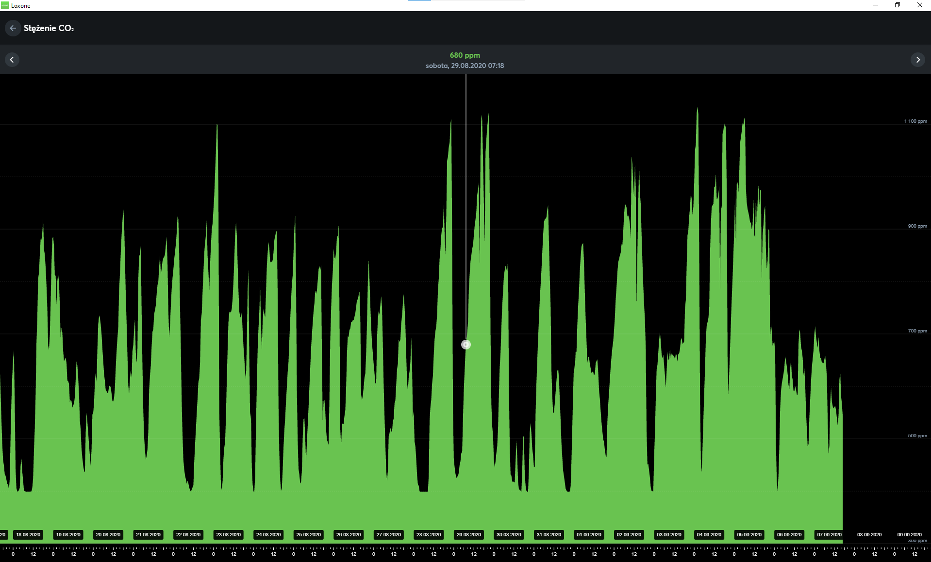

    I have a self-made CO2 sensor with MH-Z19B component inside. This controls my 2-gear extraction-only kitchen Helios ventilator with custom logic (using CO2 and Humidity, two threshold each, each with hysteresis). I almost never exceed 1200 ppm with that system.

    • herrnik
      herrnik kommentierte
      Nice!
      How did you make the CO2-sensor?
      Is there any how-to, what is needed?
