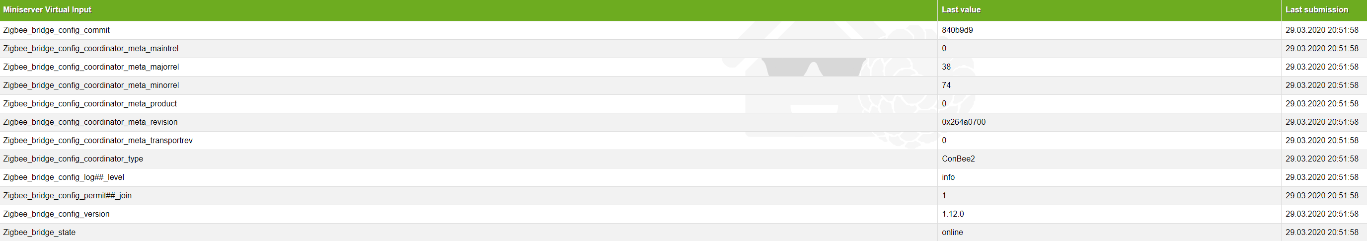

    • 4681
    Es lebt schon mal

      I'm having trouble setting up the Aqara curtain motor ZNCLDJ11LM.
      I have: Raspberry Pi 3B + with LoxBerry V2.0.1.3 installed, MQTT Gateway v1.1.1 and Zigbee2Mqtt Plugin.
      Everything works and the ZNCLDJ11LM device pairs to Zigbee2MQTT stick successfully.
      For debugging I use MQTT Explorer. I can change the following parameters: reverse_direction, hand_open and reset_move, but I can’t understand how to manage the states: open, close, stop, position.
