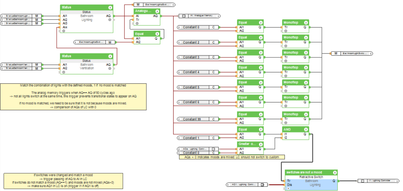

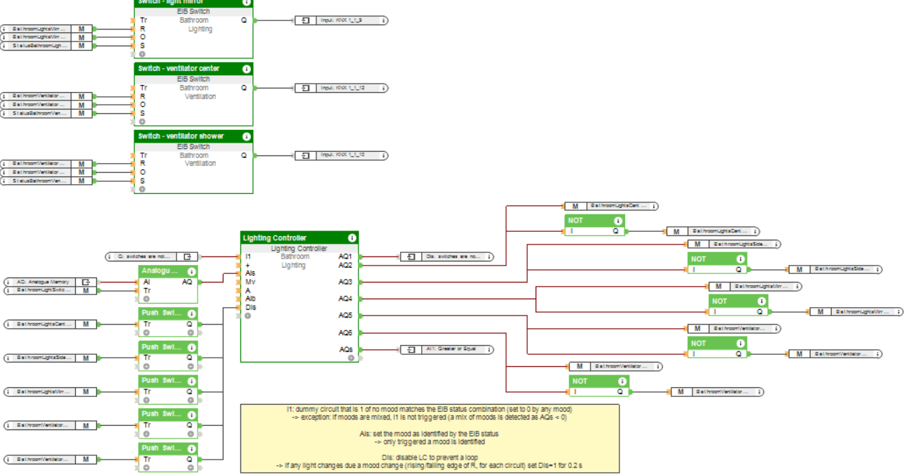

          Just to come back to this: my solution that seems to work.
          First off: in KNX, I have a message that allows me to trigger an actor, and there is a sensor that tells me the current status of an actor. As such, in Loxone, I have a memory flag that allows me to trigger an actor, and a memory flag that allows me to see if a light is on/off.
          The idea of integrating the lighting controller is the following:
          1. the lighting controller triggers the EIB switches using the R and O outputs of an EIB Switch function block. Both on/off are connected to the AQ output, but the off has a not. I do not use a trigger as it became too complicated. The circuit I1-AQ1 is used as an indicator, AQ1 is connected to the disable of the retractive switch on the second page: if AQ1=1 and we need to have it on, it means I1 should not be triggered.
          2. any combination of switches is translated into a status number; this number matches with the numbers of the moods. I use 0 for all off, 99 for all on, 1 to indicate that no mood matches, and then the numbers from 2 and up for to mood numbers. If the combination matches, we trigger an analog memory to send this mood number to the lighting controller (input AIs);this will make the lighting controller show the current mood. The fact that we use O and R to switch the EIB Switches means we will not get into an on/off loop. I have to retrigger the analog memory everytime a mood changes, which is why I have all the equal-blocks and the monoflops; I could not find a better way. If the status number is 1, it means the combination does not match a mood. This can have 2 causes: we are mixing moods in the lighting controller, or we are making changes with the EIB switches. In the latter case, we want to update the lighting controller to tell it we are in manual mode; this is done by making sure AQ1 is on, which is done by triggering I1 when needed. In the first case, the current mood number (AQs on the lighting controller) will be negative; in this case it means we don't want the lighting controller to change to manual, so we do not trigger I1 (nor do we send AIs).
          The output of the status block is compared against a memory block that holds the same value 50 cycles ago: the reason for this is that not all the lights switch at the same time, and we don't want any states during the transition of one mood to another mood to trigger the lighting controller. (as a status block has just 4 inputs, I needed 2 of them)
          We also disable the lighting controller for 0.2 seconds as soon as any lights change due to the lighting controller (it is enough to test the on signal of each output, as the pushbutton translates both rising and falling edge to a pulse.
          I think this should clarify the figures below (2 EIB switches are missing as I could not fit them on the screenshot; but they are similar).
          Click image for larger version  Name:	knx1.PNG Views:	0 Size:	190.9 KB ID:	198391
          Click image for larger version  Name:	knx2.PNG Views:	0 Size:	191.3 KB ID:	198392
          The effect is that the lighting controller shows the current situation (if it matches a mood), or manual if it does not. Use of the lighting controller correctly updates the status of the light switches and even the mixing of modes using the controller is possible.
          edit: the system goes wrong if buttons are pressed too quickly; I tried to minimize the delays (0.2s during which the lighting controller is disabled, 50 cycles for the status output) but if someone triggers faster than those times, there may be an issue. I took the delays from experiments, they may still be shorter (or may need to be longer if you have more circuits). The lighting controller and eib switch status are de-synchronized when it goes wrong, but this fixes itself on the next usage of either of them (another benefit of using O and R rather than trigger on the EIB switch blocks).
          edit2: there is no reason not to start number the moods from 2. I changed it so that the moods are numbered 0 (off), 99 (bright) and then from 1 to as many as needed. The status is -1 if the combination does not match a mood. No difference in functionality but perhaps a bit more readable.
          Hope this helps someone!

            Just thinking that I made it too complicated: the pushbuttons to the left of the lighting controller serve to disable the lighting controller while the lights are changing (to avoid intermediate combinations of states due to the switches not switching at the same time). But the analog memory (right of the status on page 2, the one with the 50 cycles delay) serves the same purpose... So maybe those pushbuttons can be removed. I'll test it as soon as I can.
            edit1:
            The part that connects to the disable input of the lighting controller block can be removed; delaying the status value with 50 cycles and checking if it matches the status value is enough to prevent the system of triggering on intermediate values. So it becomes quite a bit simpler.
            First tests for the dimmer seems to indicate it also works, but I need a bit more of testing before as my knx dimmers are software limited to 70% (otherwise they have issues driving the low loads as I have leds connected). So I need to capture that in the system as well.
            edit2:
            The same approach works for the dimmers: just send the AQx from the lighting controller to the EIB value input. And in the status block, check for a value rather than just 1/0.
