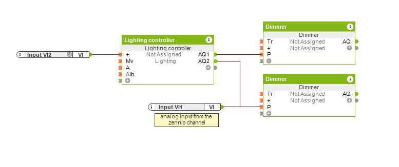

    I am trying to configure spheres with the loxone light controller which is working very well with the loxone interface (on android smarthpone) and the push buttons are configured as regular push button (send a command at rising edge and at falling edge). These inputs are connected to the light controller input and are also working very well. However, I want to use the z41 display to send precise dimming values to the dimmers, but also to the light controller from loxone.
    Is there a way to send precise dimming values to the loxone light controller?

        I've tried to send precise dimming values to I1-I12 of the light controller but it seems that the light controller interprets a value >0 as being a button pressed and 0 as being the button released. If I thus send the value 50%, the light starts dimming until it reaches 100%. If I send another value, the light dims until 0%.
        I still haven't found a good solution for this...

          I have to apologize! It does not work as I thought. I was able to replicate the issue, but found no solution. In case you want to send precise dimming values to Loxone, you may need to use a different function block, e.g. "Push-Button +/-" or "Dimming" (I don't know the exact name of this function block in english, because my Loxone config is german and it does not appear in the online help). Both function blocks have an input "P" for a direct value, but also +/-. I'm sorry, but I thought that the light controller works in a similar way. Maybe you have to adjust your buttons to have "+" on one and "-" on the other button. My KNX buttons are connected to either select a specific scene or to toggle to the next/previous scene.

              version 8 still doesnt do what you want, but you can achieve this by putting separate dimmer blocks on the outputs of a lighting controller
              set the lighting controller as normal with scenes, and connect the input from your z41 to the P input of the dimmer block - do the same for each light channel
              the dimmer blocks are normally controlled by the channel outputs from the lighting controller, but using the z41 to select a precise light value will set the dimmers but not update the scenes set in the lighting controller.
              selecting a new scene from the lighting controller will override the z41 settings
