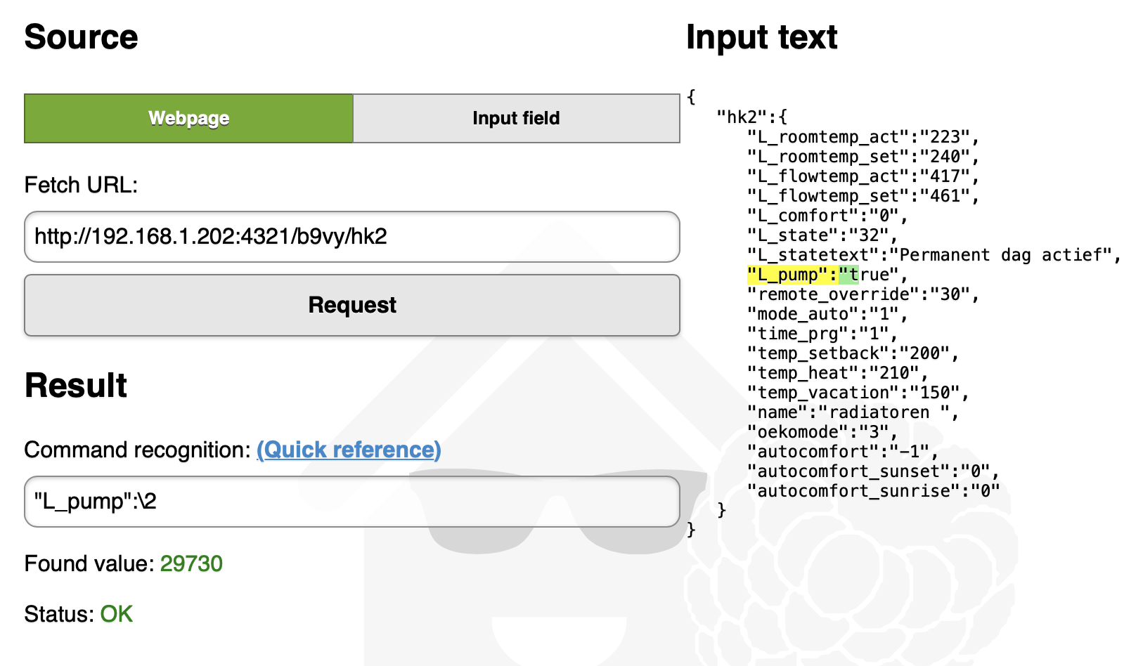

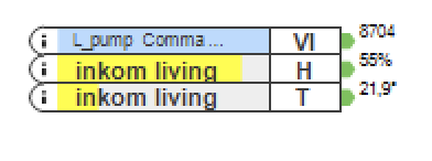

        Hi all,
        i want to do something as well if my pump gives a result of true or false.
        in the command recognition of loxberry i get a different value result as in the miniserver:
        i've attached some screenshots

          \2, \3 and \4 is a known issue of the plugin (see wiki).
          Simply use
          "L_pump":"\1

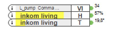

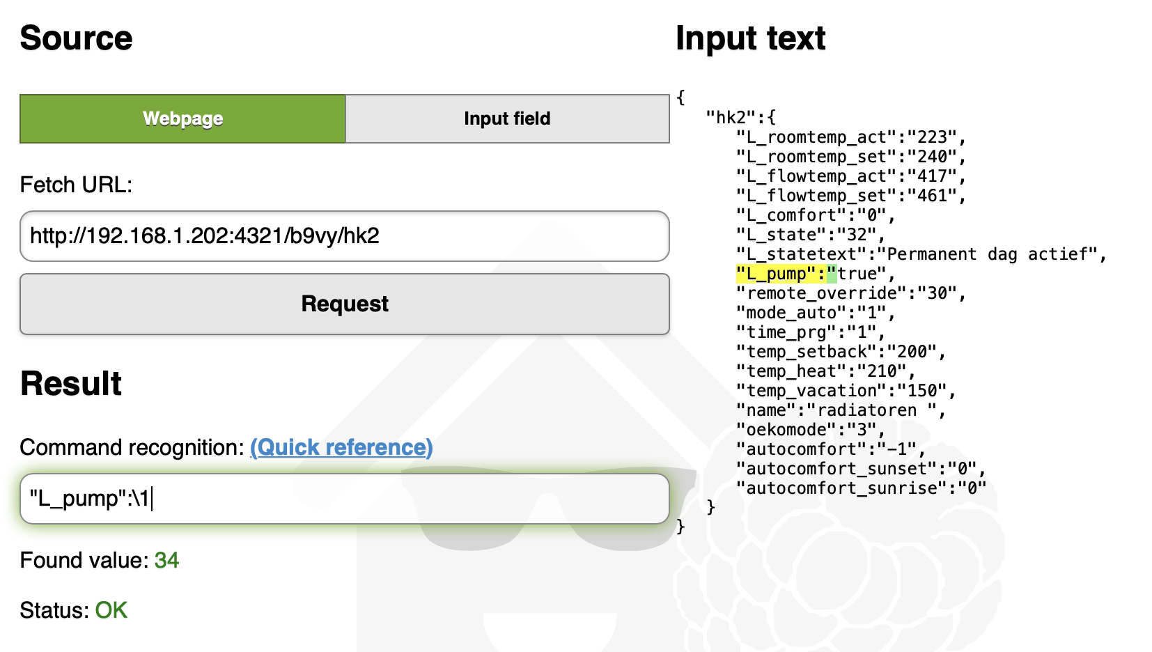

              Hi All,
              I've tried the above but the result stays the same...
              if my L_pump is true the value is 34 (also in loxone) .... if my L_pump is false the value is also 34 (also in loxone)

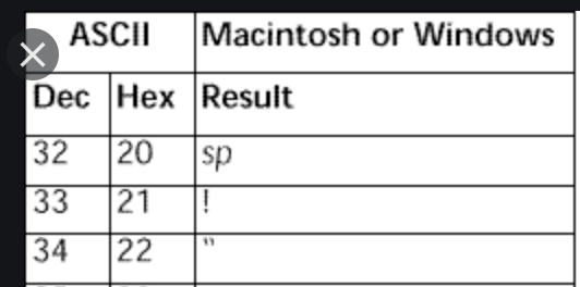

              I now understand why it stays the same... ASCII 34 has value "

              How can I get the command to move 1 character further so that it detects the letter t or f (true or false)
              thanks in advance!
              Jimmy
                Double-Check the syntax in my post!
                  facepalm! let me copy paste and try again...thanks Christian!!
                    Thanks again Christian, this works now !! I have 2 different values now , 116 when true , 102 when false... much appreciated !!
