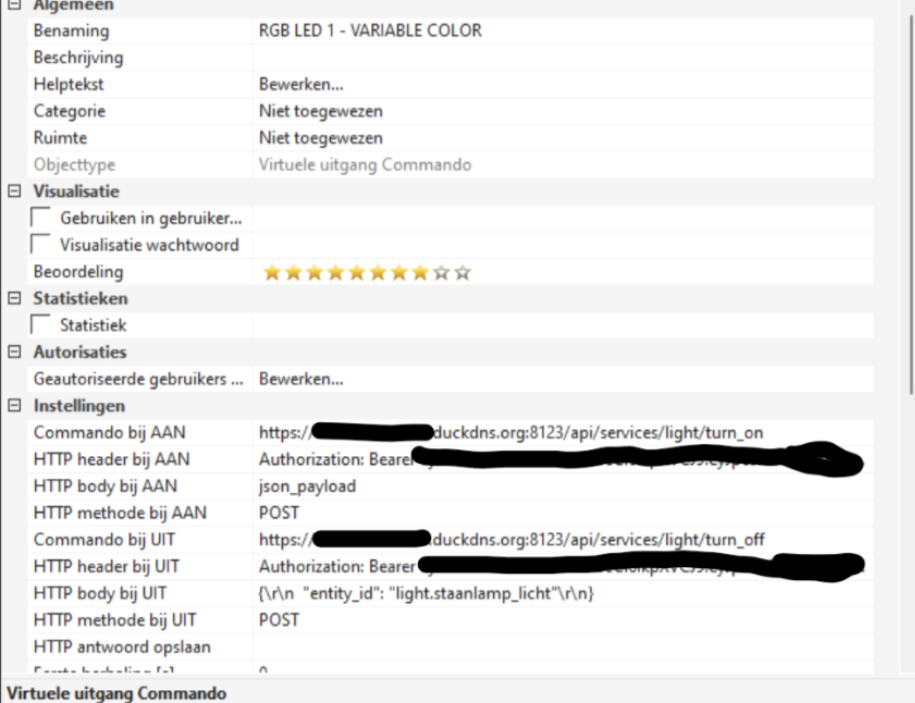

            I am trying to control rgb lights that are implemented in home assistant from Loxone.
            I have already managed to control them with a fixed color.
            Now I am trying to do this with variable text using an rgb lighting controller.
            If I enter the following at http body for on it does not work. How do I make sure that it correctly retrieves the v1, v2, v3?
            HTTP body by on:
            "entity_id": "light.staanlamp_licht",
            "rgb_color": [<v1>, <v2>, <v3>],
            "brightness": 255

              I don't think that you have three inputs on an HTTP virtual output. I recommend to use a status block to combine the three input values, maybe the whole HTTP body and forward that output to the http virtual output by using <v> in the body or the square brackets from your example.
              Node-RED: IKEA Tradfri
              • Gillisk87
                Gillisk87 kommentierte
                Thanks worked perfectly!
