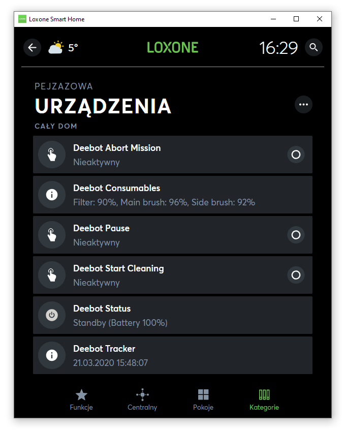

    I've managed to integrate Ecovacs Deebot OZMO 950 robot vacuum cleaner with Loxone. According to experts, Ozmo 950 is currently one of the best cleaning robots on the market and I believe this might be true as after 3 months of use I'm constantly satisfied with it. The device is quite new so unfortunately there are no many integration options. But I've finally sorted it out, in the best possible style (using MQTT both ways). This little how-to below is somehow reverse order: first you see the final result and screenshots from the app, then goes Loxone Config diagram and finally all "internals". It was not the easiest integration I've made but thanks to this description it will be easier for you now. Have fun!
    This video shows how you control Ozmo 950 from Loxone App:

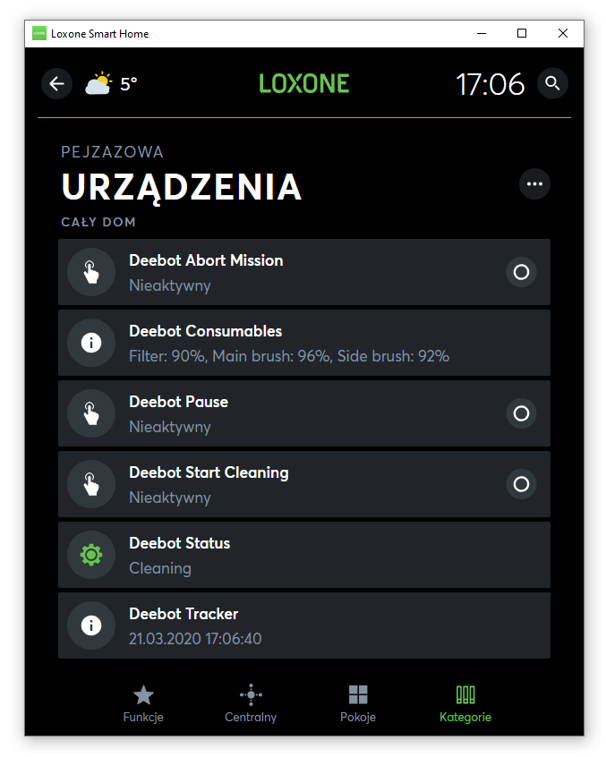

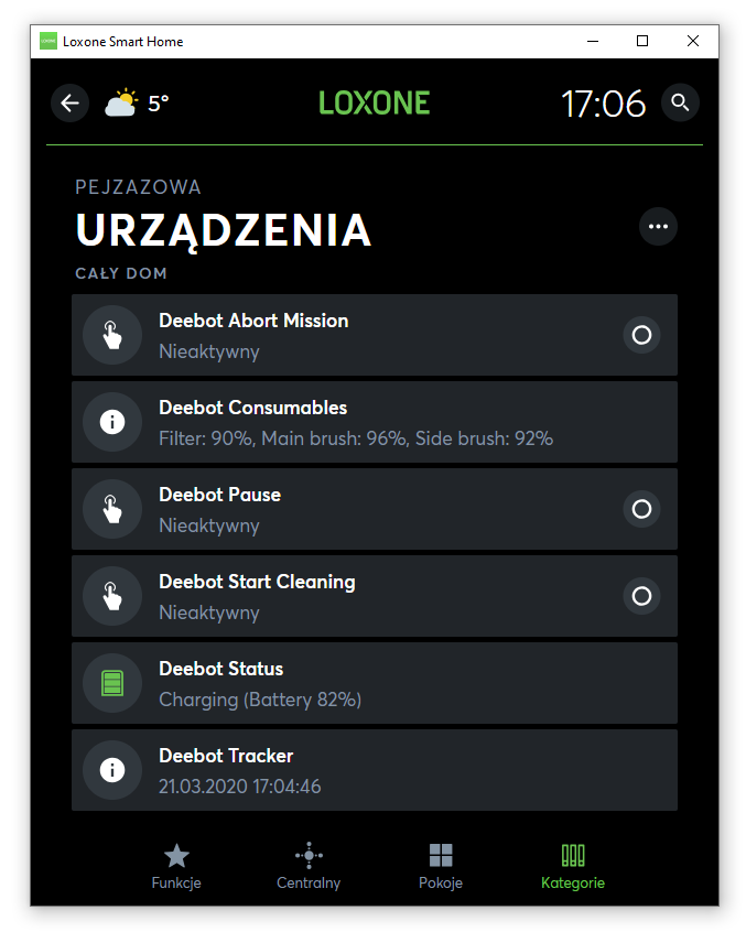

    There are 6 fields in the Loxone App. Three push buttons for basic operations (start, pause, abort cleaning), current robot status, cleaning history (in form of a Tracker) and info on consumables lifespan:
Ansichten: 3983
Größe: 77,2 KB

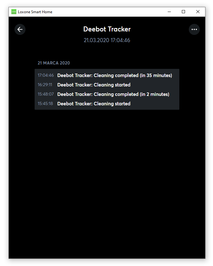

    Tracker shows last cleanings and how long did they take:
Ansichten: 3334
Größe: 35,5 KB
    Status field is instantly updated with one of 14 combined states robot can be in.
Ansichten: 3291
Größe: 74,1 KB
    When finished the job Ozmo enters "Returning" state, then "Charging" after he docks. When battery hits 100% it changes status to "Standby".

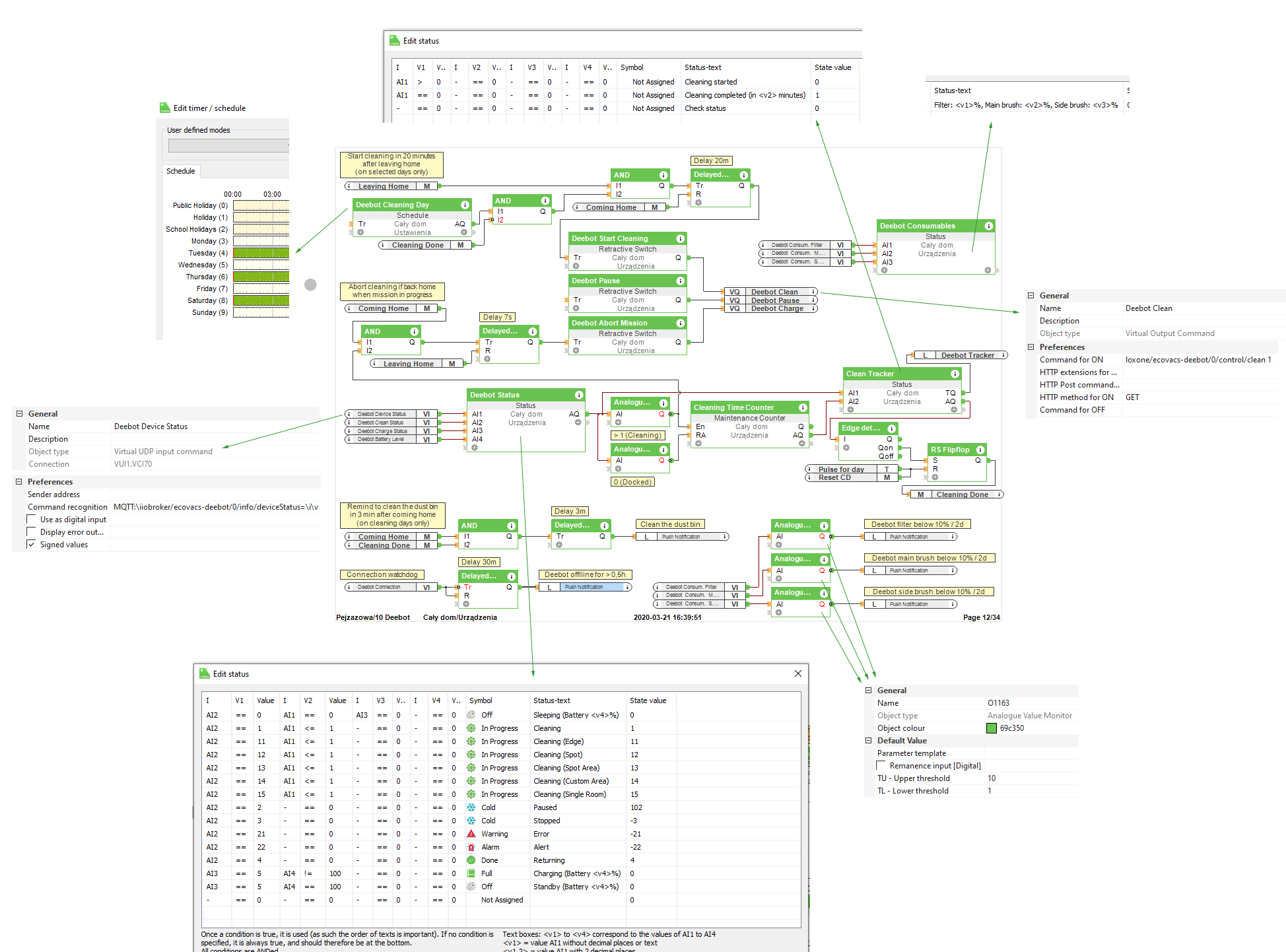

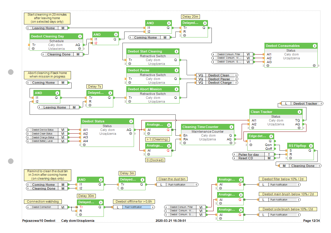

    Here comes the logic diagram I made, I hope it's clean to understand. Correct state/status detection based on three different virtual inputs is most challenging here.
    Robot starts to clean 20 minutes after leaving home pulse but only on selected cleaning days (Wen, Thu, Sat). Cleaning my apartment takes 35-40 minutes.
    If I come home before cleaning is finished, Ozmo aborts its mission and returns to docking station.
    If I come home after cleaning (usually), Loxone app reminds to clean the dust bin. It also notifies when filter or brushes require replacement.

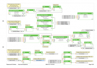

    This is the same diagram with visible configuration of not obvious blocks. Image is large so you might need to download or open it in new window.
    The most complex element here is the status block detecting robot combined state.
    All communication with robot is done over MQTT, using ioBroker run in Docker on LoxBerry and of course with MQTT Gateway plugin.

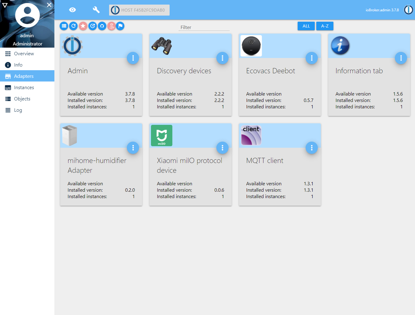

    I have not used ioBroker before but was forced to use it this time as probably no other tool has support for Ozmo 950 yet.
    I must say ioBroker is a great tool especially for integrations.

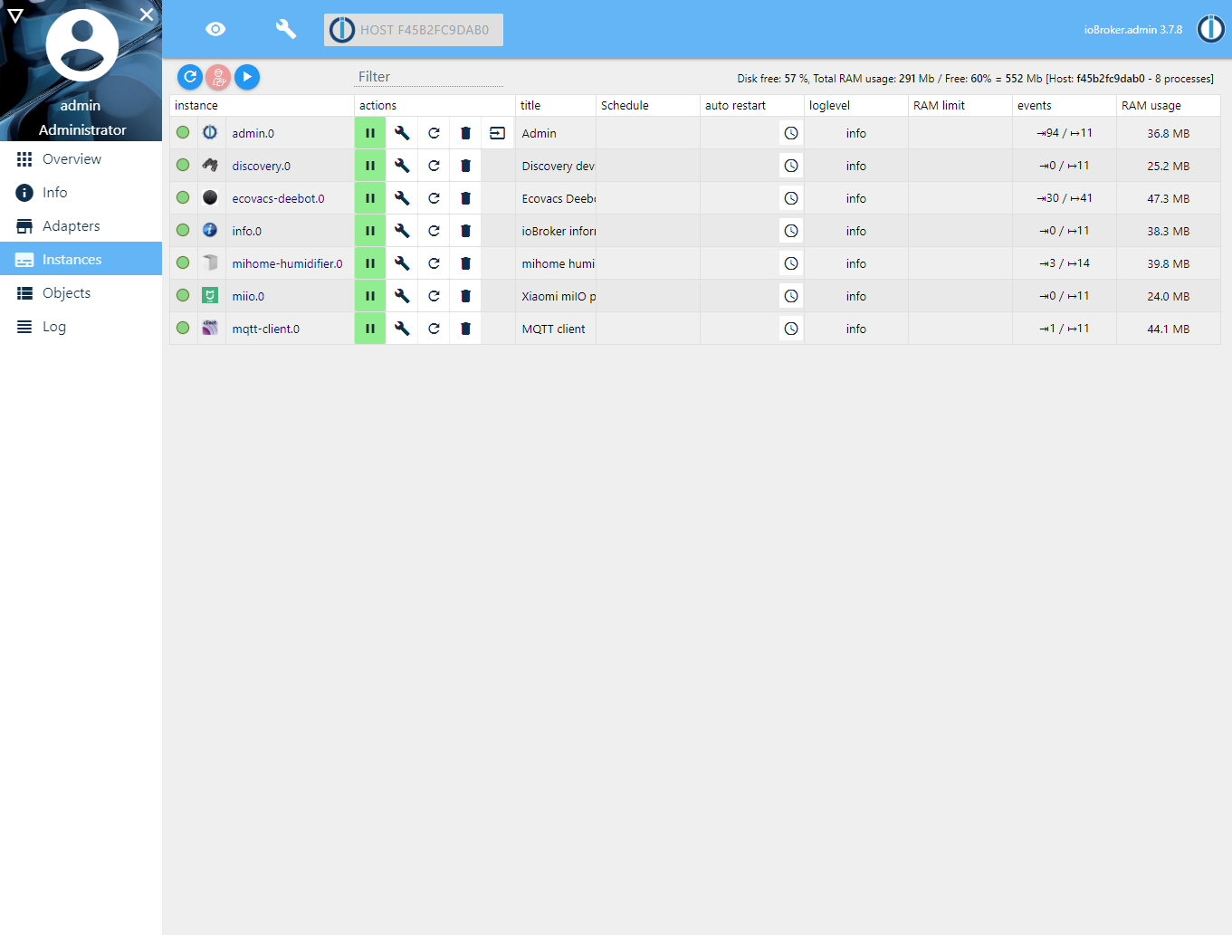

    It's based on modules/plugins called "adapters", that support given protocol or device. Amazing how many devices are already supported.
    In this integration I've used two adapters: Ecovacs Deebot and MQTT-client:

    Each adapter creates at least one "instance" that you usually need to configure. Instance of Ecovacs adapter needs login and password to Ecovacs cloud (same as Ecovacs Home mobile app).

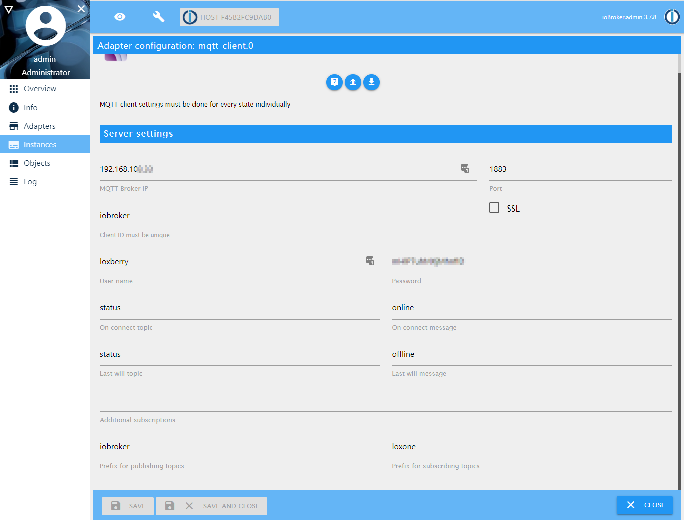

    MQTT-client instance requires MQTT server IP, login and password:
Ansichten: 4054
Größe: 99,0 KB

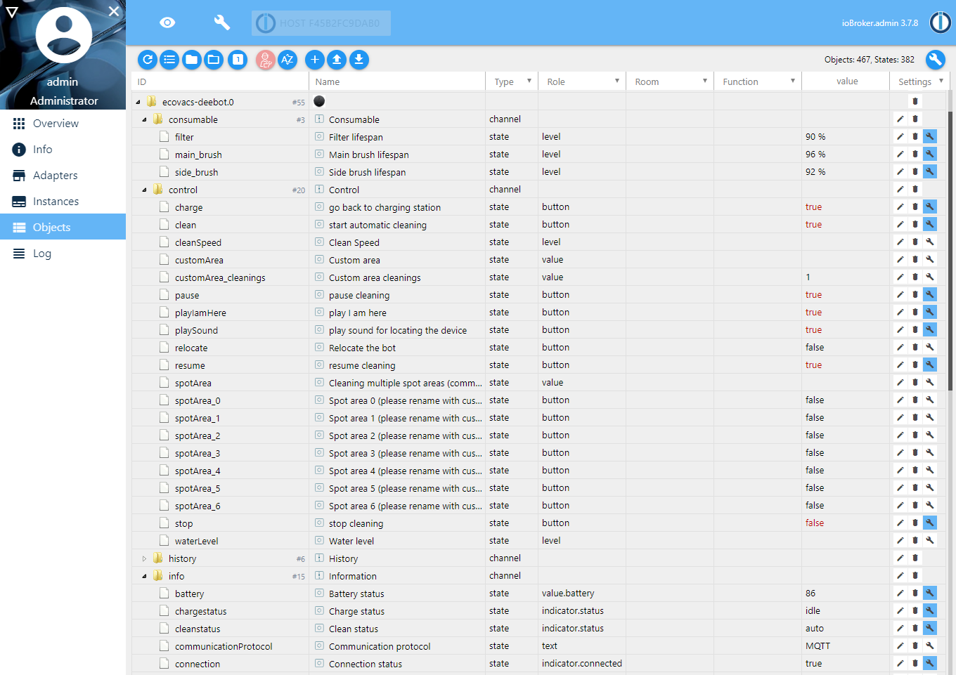

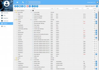

      After completing the configs you move to "objects" and all device states already there. You may publish selected states to MQTT broker or control states subscribing to MQTT topics.

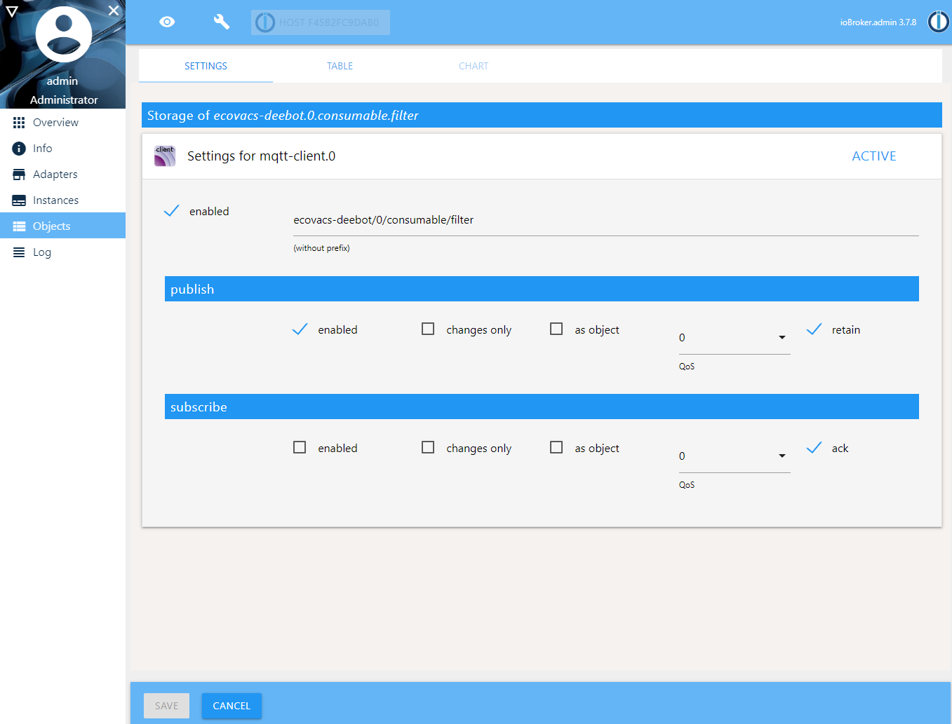

      Configuration of stats that is to be published to MQTT (filter lifespan here):
Ansichten: 3376
Größe: 91,3 KB

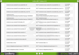

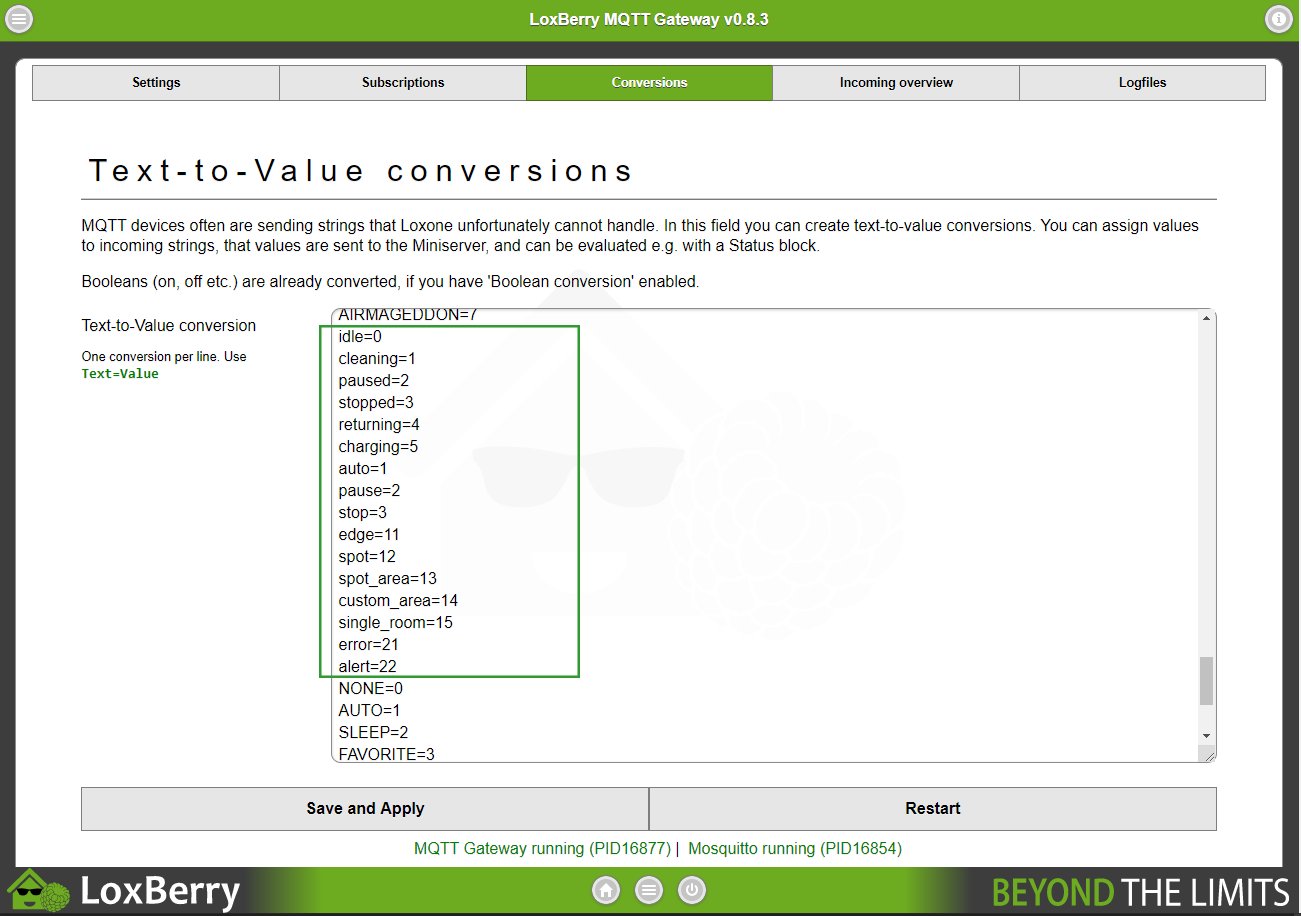

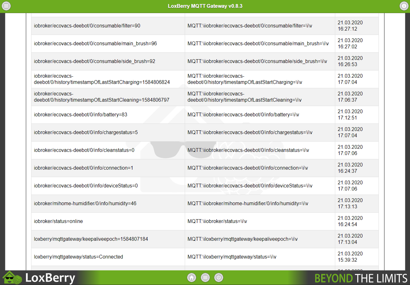

      When states are successfully published to MQTT you need to do some string conversion in MQTT Gateway plugin. I marked relevant conversions:
Ansichten: 3382
Größe: 115,7 KB
      Then you just add iobroker/# to MQTT Gateway subscriptions and you're done:
Ansichten: 3382
Größe: 160,2 KB

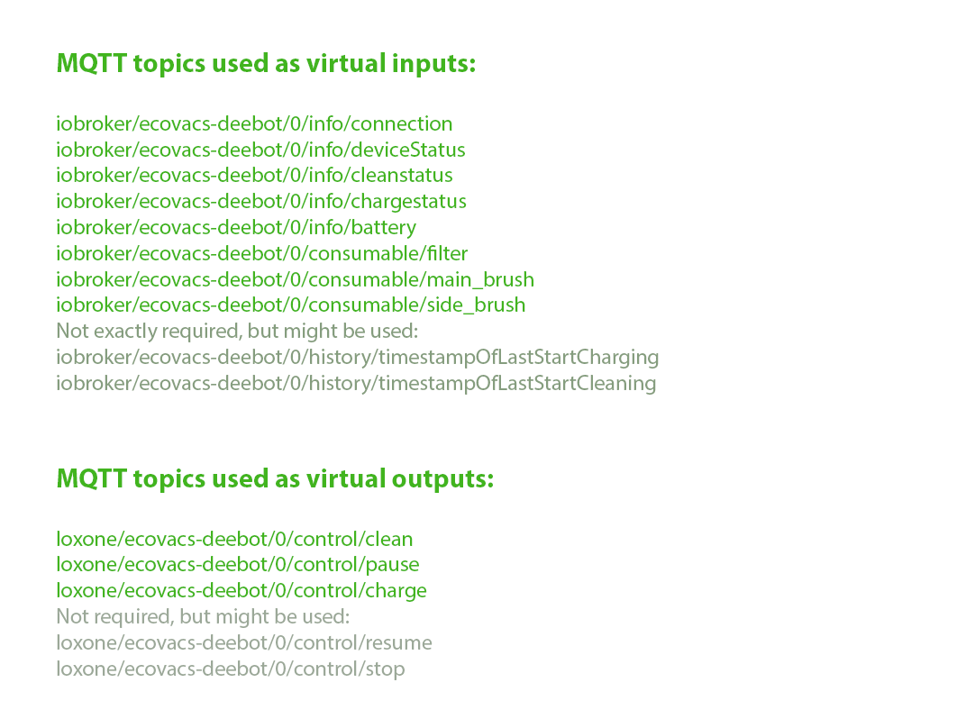

        Summary of MQTT topics I've used to monitor and control Ozmo 950:
Ansichten: 3230
Größe: 101,0 KB

            I believe I'm not good enough in those npm issues.
            I have never installed any adapter to ioBroker via commandline. I just use admin panel and click "install"
            Adapter i use is in version 0.5.7 but I have noticed minute ago there is already an upgrade to version 1.0.
            I have just tried to upgrade it and it failed. So seems version 1.0 is broken. Just try 0.5.7 - it works.

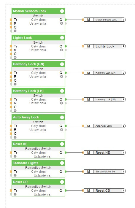

            Where does the memory flag "Reset CD" come from?
            • TomekWaw
              TomekWaw kommentierte
              Reset "Cleaning Done"
              I made Deebot run only once a day.
              But you might need it run more than once, for instance:
              - you want to clean it again one day
              - when you return home during its job and it will be aborted - you might want to do it all over
              - during test.
              So I set this VI as push button and put it to Category Settings to make it possible

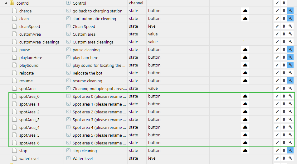

              TomekWaw if you send commands to ioBroker over the Adapter "Simple Restful API", it is possible to integrate custom area cleaning. I tested it and it is great!
              • TomekWaw
                • 25.07.2019
                • 446
                Yeah, most probably same with MQTT control. One just need to activate subscriptions for those object:
Ansichten: 2619
Größe: 76,3 KB
                I will add it to how-to.
