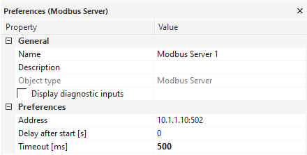

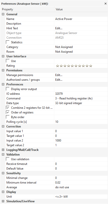

                  I don't have a Huawei inverter but offer the following suggestions for general Modbus connectivity -
                  The Modbus Server should have the Raspberry IP address and port (change the IP to the appropriate number).
                  Set the Timeout to 500ms initially, then increase in 500ms increments if you don't have success.
                  To set a sensor, the IO address needs to be -1 from that published. In the following example I am referring to the Modbus address for "Active power" (Serial Number 36, address 32080).
                  The Huawei document refers to that value having a 'Gain' of 1000. I assume that might mean you need to divide by 1000 to get the actual kW value. The Correction might need to be changed if the value is out by a factor of 1000.
                  Zuletzt geändert von Tico; 30.03.2021, 11:08.
