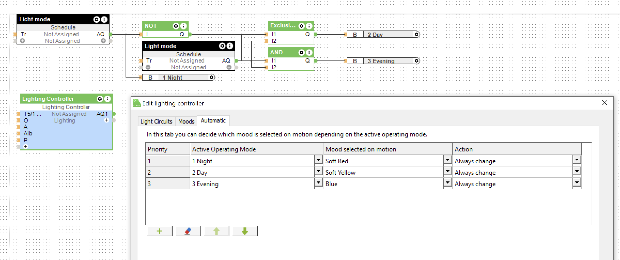

Hello All, i am currently installing my Loxone installation piece by piece and i struggle to find information on the following. I have a ceiling light air in an upstairs hallway and would like to be able to set different colours depending on time of the day. For instance from 8am till 6pm i will use yellow bright , from 6pm till 10 a soft red and from 10pm till 8 am it should be blue .
There must be a way but so far and despite searching the net i did not succeed in making this work. Any suggestion from the more experienced forum members?
It will use a motion sensor as a trigger and no wall switch.
No wonder i could not make it work, i really have to learn the logic behind this or will forever be using Loxone in it’s simplest configuration which cannot be the intention. Thank you Kwarts
