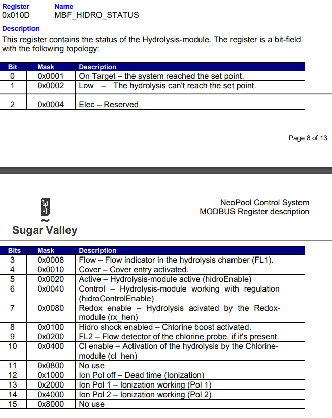

    Hello, i'm reading following modbus value (address 269) into a digital analogue sensor.
    How can i convert this register into a bit field?
    I tried this procedure :
    https://www.loxwiki.eu/display/LOX/E...+Bits+zerlegen
    but this cant be right , ionization is not working atm, so the bits aren't correct
    anyone to help me out?

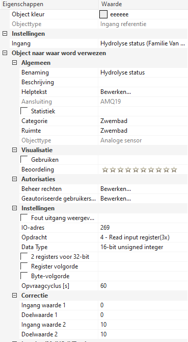

    Can you provide a screenshot of the Modbus sensor properties from Lox Config? That might confirm whether the sensor is set up correctly.
Ansichten: 50
Größe: 25,9 KB
      See image, i tried 16bits signed integer aswell, didnt made much difference.
      System was on target and first bit was 0
      I thank you for looking into this Tico
      • #4
        The Modbus Register 0x010D converts to decimal 269. Loxone Modbus sensors normally need -1 from the published decimal value. So Config IO-Address = 268.

        The Sugar Valley Modbus document I googled doesn't provide any guidance on signed or unsigned integer. Some experimenting may still be required...

          First address for sugar valley is 0, so -1 is not needed.
          I am reading PH value and redox value and these are correct only these one is using a bit field .
          I'm going to try command try and experiment a bit..

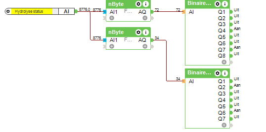

        • #6
          The screenshot you provided with the value 8776 converts to -
          0010001001001000
          This agrees with the output of the binary converter blocks (when read top to bottom / right to left).
          Your screenshot is missing Q8 on the 'Higher 8 bit', but I'm assuming it is zero.
          Try here for other values -
          https://www.binaryhexconverter.com/d...nary-converter
          I would be inclined to turn on/off the various functions and see what bits change. Perhaps the Sugar Valley document is in error?
