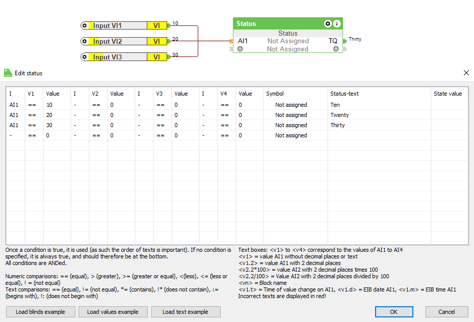

      I'm a bit unclear on what you want to do. How are the multiple inputs being measured as changing? Are the multiple inputs numeric values that you wish to trigger a particular voice command for?
      Have you looked at the Status Block? You can have any value input correspond to a desired text output. There are multiple lines available that can hold hundreds of desired voice commands.
      Zuletzt geändert von Tico; 23.08.2022, 08:14.
      • Tico
        • 31.08.2016
        • 1035
        In the example below, I have three Virtual Inputs. The input that has the last change is the one that is being assessed at input AI1.
        Within the Status Block, the first line that satisfies the comparison will output the applicable Status-text output (TQ). For example, I can change Input VI3 to count from 0 to 30. When it lands on value 10, the text 'Ten' will be output. When it lands on value 20, the text 'Twenty' will be output etc.
        If value 30 is maintained on AI1, but a subsequent value change occurs on a different Virtual Input (the subsequent value change being not equal to any of 10, 20 or 30), then no text is output.

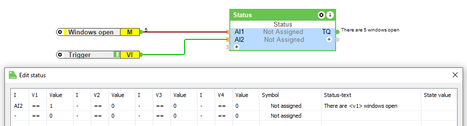

            The Status Block would still be your go-to choice. I haven't got an Audioserver to test this on, but I use the same technique for broadcasting to Google Home devices.
            Using a Sequential Controller seems a bit of overkill to generate the text messages. A simpler method is to use the Status Block as follows -
Ansichten: 942
Größe: 18,7 KB
            I've included a trigger on AI2 for demonstration purposes. You can also remove the trigger condition and each value change on AI1 will also update the text output.

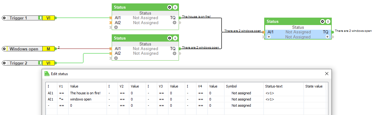

            Combining all your TQ outputs on a single Status Block before the TTS Input would look like this -
Name: The house is on fire.png
Ansichten: 662
Größe: 33,2 KB

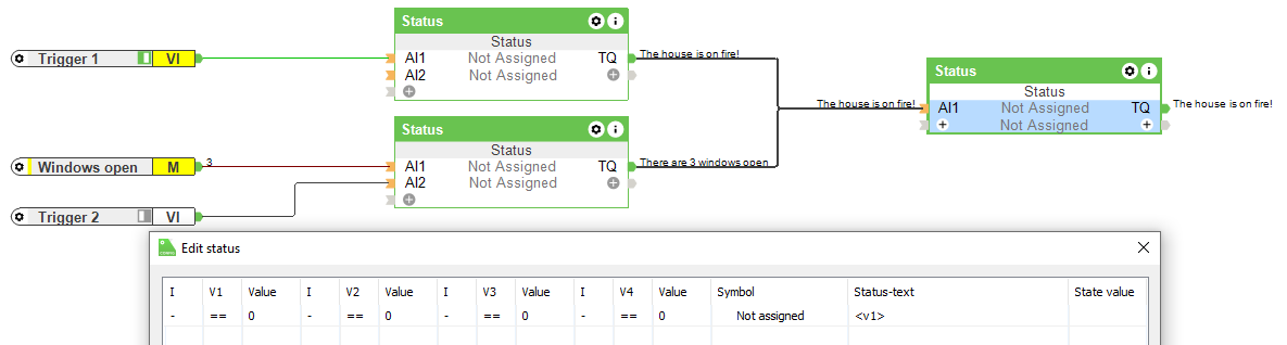

            You can also selectively use Text comparisons to only verbalise a subset of messages. The image below will work exactly the same as the image above, but will only let the listed messages through. Note the use of the comparison *= (contains). The explanation is at the bottom of the Status Text block.
Ansichten: 677
Größe: 37,1 KB
              Yes, that did the trick. I was not aware that the Status block input would be able to recognise the different text inputs. In the sequential controller, combining multiple texts results in a '1' on the input.
              ...I really should look into the status block a bit more!
              thanks for the help!
