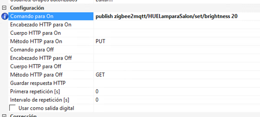

    Hi, I'm trying to send commands to a Philips HUE lamp using UDP virtual outputs.
    With an MQTT client the command is well recognized by the lamp but I can not work from the Miniserver.

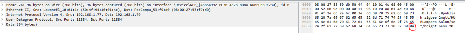

    Zigbee2mqtt always returns an error and, using Wireshark and a MQTT client I have been able to verify that the problem is that the frames sent by the miniserver end with the character 0x04 (EOT).
    Seems that MQTT is not able to eliminate that character before passing the frame to zigbee2mqtt.
    Do you know what I'm doing wrong?
    I tested MQTT Gateway version 2.1.0 and 2.1.199
    Best regards

      Hi, thanks for your response Christian.
      Yesterday I haven't access to my home system but now I can share here my case with images.
      This is my Loxone UDP output command.

      This is the Wireshark capture where you can see the last character 0x04
Ansichten: 181
Größe: 139,1 KB

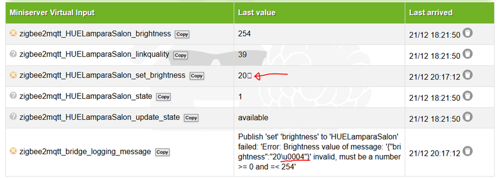

ID: 371773Then Loxberry MQTT Gateway dashboard shows the error
Ansichten: 189
Größe: 345,4 KB

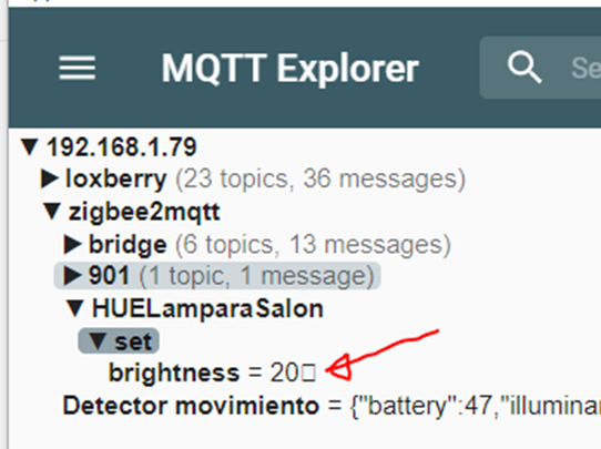

      And with ​​MQTT Explorer I read the same value in the ".../set/brightness" topic-
Ansichten: 363
Größe: 121,3 KB

        But...
        If I send the same command trough MQTT Explorer all is working good
        And the Loxberry MQTT Gateway dashboard now show how the lamp received the correct value "20" and adjusted its brigtness at the value 20.
        With these informations, do you know how can I resolve this problem? Maybe writing a transformer?
        Best regards.

          Try to change the PUT to a GET.
          The Miniserver usually doesn’t send a 04.
          Regards, Christian
            Regards, Christian
            Thanks Christian, this was my mistake, with GET the frame is sended wihout EOT character, now the Philips HUE response quickly at Miniserver virtual outputs.
