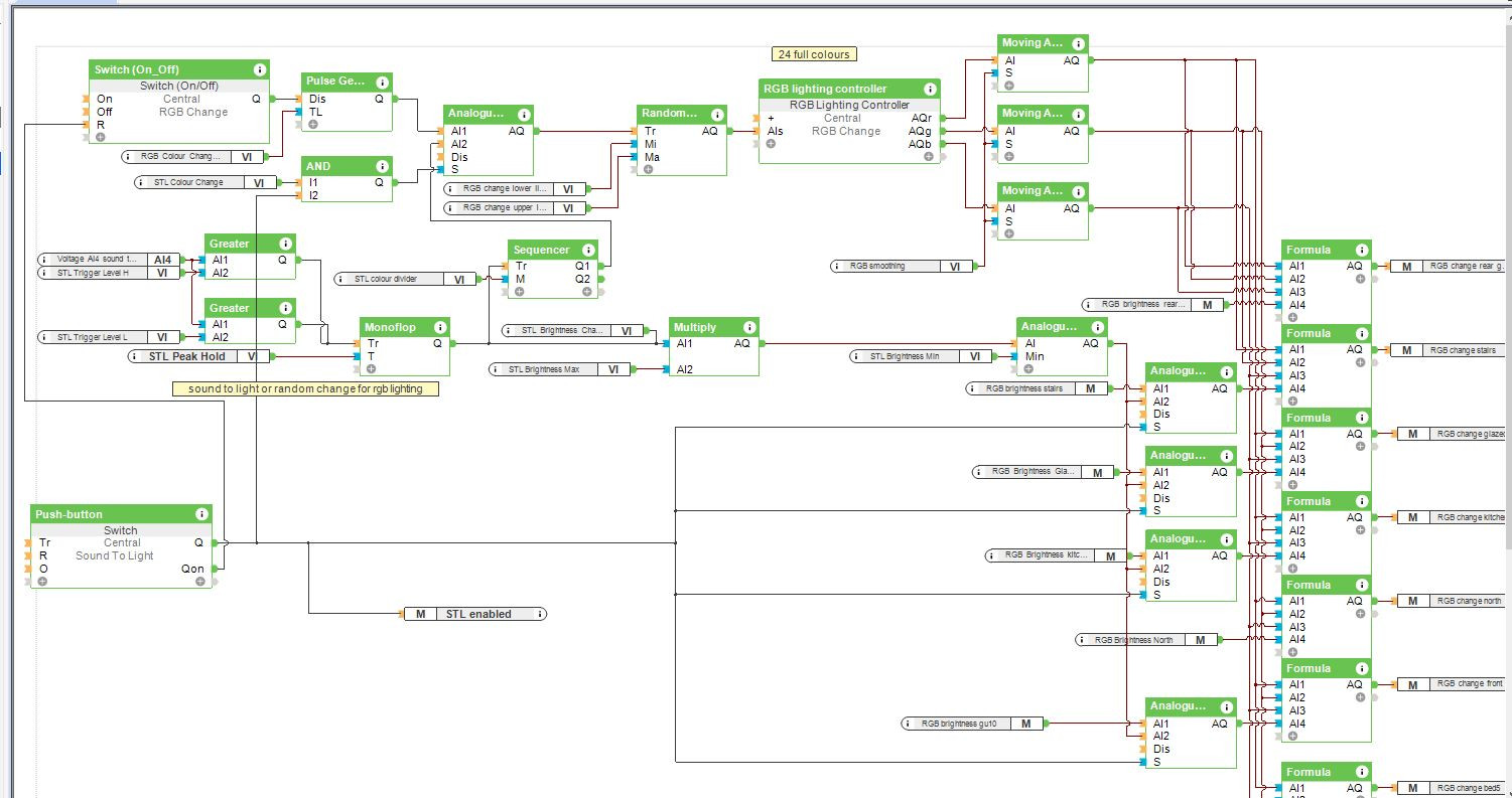

      • duncan
        • 322
        this has rgb changing and also rgb triggered by sound via an analog in
