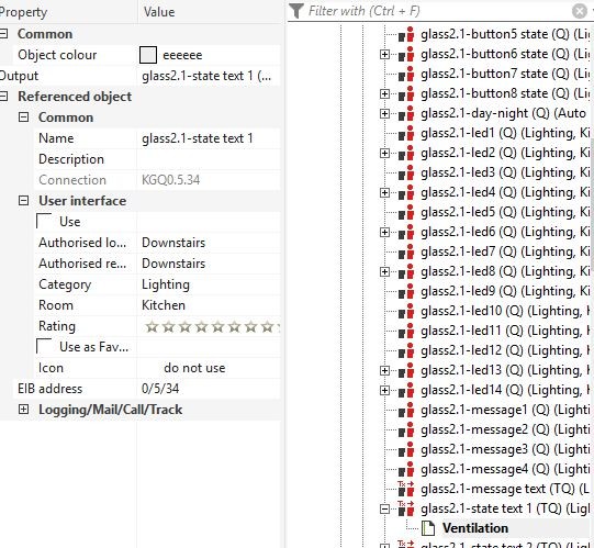

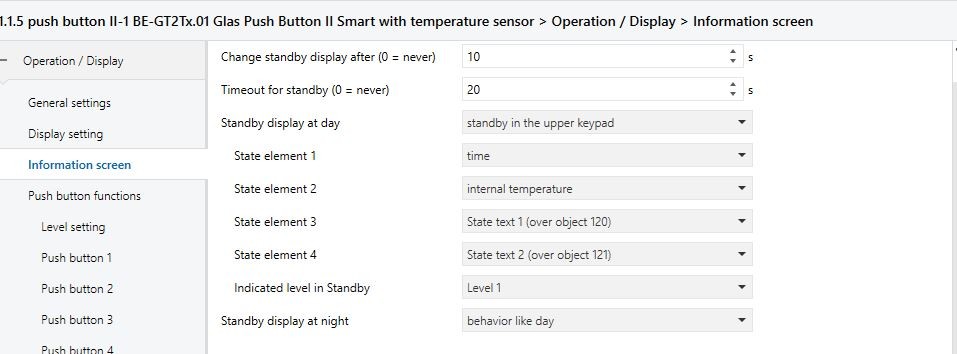

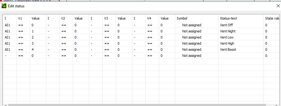

    sorry to answer in english:
    create a group address for state text 1 and possibly state text 2
    config the glastaster to show the state text objects in standby
    create a knx text actuator for the state text 1 and 2 items
    create a loxone state object and configure it with the correct text to be send to the state text knx objects
    attach state text 1 and/or 2 to the text output of the loxone state object
      Perfect, thank you very much!
      I tried it and it worked directly.
