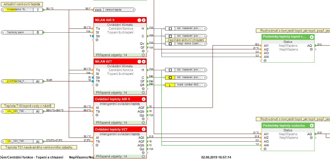

    I own Nilan Compact P AIR 9 heat pump and through modbus I control from Loxone how to heat, cooling, ventilation, etc.
    Is here anybode else with same heat pump?
Name: loxone nilan 4.jpg
Ansichten: 970
Größe: 74,0 KB
Name: loxone nilan 3.jpg
Ansichten: 930
Größe: 71,4 KB

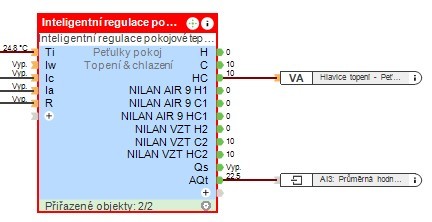

ID: 203213My problem with this compact device in Loxone is, that there are two heat pumps inside - first internal for ventilation and second one in external heat pump unit. First one is used for ventilation and because is active, can heat or cooling and moreover can heat water tank. Second one is classic heat pump for floor heating and floor cooling.

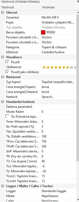

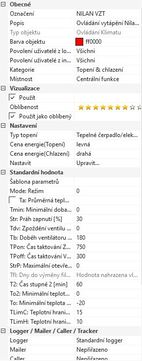

    In Loxone I have two climate controllers and two Intelligent temperature controls. In both situations - heating and cooling - is internal (ventillation) heat pump prioritize above external unit, what is more powerfull. I can understand it in heating situation, beacause I set external unit AIR 9 as more expensive over cheap ventillation source. For cooling I set it in oposit way.
    I haven't any situation when external unit start cooling. And i don't know how to force it. :-(
    Have somebody any experience with two heat pump source in one loxone project?
    Can somebody help mi pls? Thanks for any advice.
