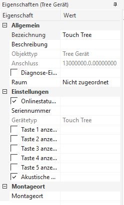

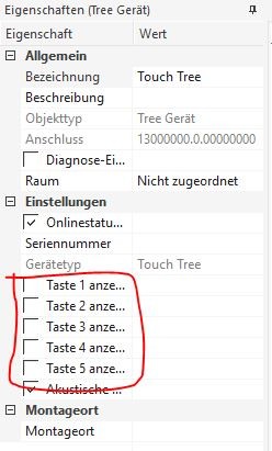

    Hello! I'm looking for a workaround to configure the buttons T1, T2, T3, T4 of a Touch Tree to dim lights (Up and Down) (using T5 to scroll through the scenes). I'm not using Music Server, so these buttons are not used. Can anyone help me or give me an example how to fix this?

    Hello
    When you click on the touch tree in the config, then you can activate the buttons and use it as you want.
