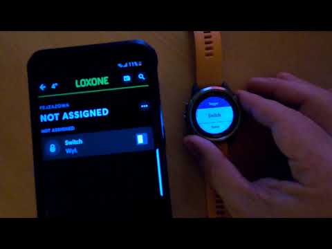

    Loxone on a Garmin smartwatch for the first time ever!
    Just kidding I made a simple integration for proof of concept.
    HassIQ => HA => MQTT => Node-RED => Websocket API of Loxone Miniserver
