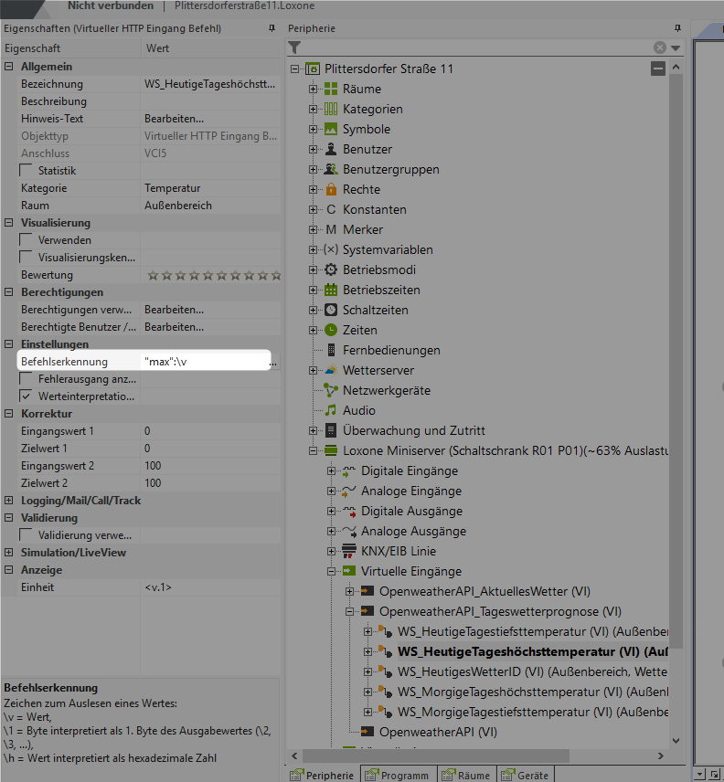

    Hallo Leute,
    ich komme bei meinem Problem leider nicht mehr weiter und hoffe, dass einer hier um Rat weiß.
    Ich benutze eine Wetter-API und möchte aus dem Response, den ich vom Server bekomme, Werte (Temperatur) auslesen.
    Folgenden Response bekomme ich:
    {"lat":48.8961,"lon":8.1968,"timezone":"Europe/Berlin","timezone_offset":3600,"daily":[{"dt":1611226800,"sunrise":1611213019,"sunset": 161 1245184,"temp":{"day":10.23,"min":3.91,"max":11.77 ,"night":9.54,"eve":8.78,"morn":6.32},"feels_li ke" :{"day":2.59,"night":1.55,"eve":3.87,"morn":0.2} ," pressure":1001,"humidity":73,"dew_point":5.65,"win d_speed":9.49,"wind_deg":213,"weather":[{"id":500,"main":"Rain","description":"light rain","icon":"10d"}],"clouds":100,"pop":0.87,"rain":2.63,"uvi":0.39 },{ "dt":1611313200,"sunrise":1611299360,"sunset": 1611 331677,"temp":{"day":9.07,"min":3.35,"max":9.54,"n ight":3.35,"eve":5.92,"morn":8.42},"feels_like":{" day":4.63,"night":-0.9,"eve":2.46,"morn":1.32},"pressure":994,"humidi ty":77,"dew_point":5.31,"wind_speed":4.81,"wind_ de g":217,"weather":[{"id":501,"main":"Rain","description":"moderate rain","icon":"10d"}],"clouds":100,"pop":1,"rain":5.06,"uvi":0.66},{ "dt ":1611399600,"sunrise":1611385698,"sunset":161 1418 171,"temp":{"day":5.26,"min":1.35,"max":5.68,"nigh t":1.35,"eve":3.23,"morn":3.1},"feels_like":{"d ay" :0.83,"night":-1.25,"eve":0.61,"morn":-1.03},"pressure":999,"humidity":78,"dew_point":1.8 8,"wind_speed":3.87,"wind_deg":221,"weather":[{"id":501,"main":"Rain","description":"moderate rain","icon":"10d"}],"clouds":100,"pop":1,"rain":3.27,"uvi":0.55},{ "dt ":1611486000,"sunrise":1611472035,"sunset":161 1504 666,"temp":{"day":2.8,"min":0.34,"max":2.8,"night" :0.34,"eve":1.05,"morn":1.08},"feels_like":{"day":-1.52,"night":-2.92,"eve":-2.03,"morn":-3.39},"pressure":1003,"humidity":80,"dew_point":-1.02,"wind_speed":3.27,"wind_deg":248,"weather":[{"id":601,"main":"Snow","description":"snow","i con ":"13d"}],"clouds":81,"pop":1,"snow":10.38,"uvi":0.58},{ "dt ":1611572400,"sunrise":1611558369,"sunset":161 1591 161,"temp":{"day":1.08,"min":0.49,"max":1.31,"nigh t":1.31,"eve":1.25,"morn":0.49},"feels_like":{" day ":-4.38,"night":-4.34,"eve":-4.9,"morn":-3.42},"pressure":1012,"humidity":90,"dew_point":-1.25,"wind_speed":4.89,"wind_deg":241,"weather":[{"id":601,"main":"Snow","description":"snow","i con ":"13d"}],"clouds":99,"pop":0.96,"snow":7.72,"uvi":0.61} ,{" dt":1611658800,"sunrise":1611644700,"sunset":161 16 77657,"temp":{"day":2.42,"min":1.18,"max":2.45,"ni ght":1.9,"eve":2.11,"morn":1.18},"feels_like":{"d a y":-2.38,"night":-3.55,"eve":-2.22,"morn":-4.49},"pressure":1020,"humidity":90,"dew_point":1. 09,"wind_speed":4.22,"wind_deg":236,"weather":[{"id":600,"main":"Snow","description":"light snow","icon":"13d"}],"clouds":100,"pop":0.78,"snow":3.31,"uvi":1},{ "dt ":1611745200,"sunrise":1611731030,"sunset":161 1764 154,"temp":{"day":6.71,"min":2.31,"max":6.71,"nigh t":5.48,"eve":5.62,"morn":5.65},"feels_like":{" day ":1.15,"night":0.64,"eve":1.38,"morn":0.58},"p ress ure":1018,"humidity":81,"dew_point":3.72,"wind_sp e ed":5.98,"wind_deg":259,"weather":[{"id":500,"main":"Rain","description":"light rain","icon":"10d"}],"clouds":90,"pop":1,"rain":6.05,"uvi":1},{"dt" :16 11831600,"sunrise":1611817357,"sunset":1611850651, "temp":{"day":8.68,"min":4.62,"max":8.68,"nigh t":7 .32,"eve":8.21,"morn":5.62},"feels_like":{"day":2. 2,"night":2.44,"eve":3.19,"morn":-1.17},"pressure":1012,"humidity":79,"dew_point":5. 41,"wind_speed":7.72,"wind_deg":224,"weather":[{"id":500,"main":"Rain","description":"light rain","icon":"10d"}],"clouds":100,"pop":1,"rain":5.88,"uvi":1}]}
    Nun möchte ich die heutige Tageshöchsttemperatur ermitteln und die morgige Tageshöchsttemperatur.
    Beide Zahlen stehen hinter folgendem String: "max":
    Den ersten Wert (also die heutige Temperatur) bekomme ich ohne Probleme mit der folgenden Befehlserkennung ermittelt: "max":\v
    In dem obigen Beispiel ist das der Wert "11.77".
    Aber wie zum Teufel komme ich an den zweiten, also die "9,54"? Hat jemand eine Idee?
    Ich bin ratlos. Hab schon einiges probiert.

    Romildo hat das ganz gut erklärt:
    https://www.loxforum.com/forum/germa...787#post175787
    Wert 1: "max":\v
    Wert 2: "max":\imax\i\v
    Das heißt dann finde "max" und springe zum nächsten "max", musst Du mal probieren und schauen, ob da noch ":" dazu muss.
    Ich habe das auch nur irgendwo hier mal gelesen, also kann es Dir nicht 100% sagen.

      Vorschlag für den 2. Wert: \i"max":\i\i"max":\i\v
        Wow, das ging schnell mit den Antworten.
        DAAAAAAAAAAAAAAAAAAAAAAAAAANKE, es funktioniert mit \i"max":\i\i"max":\i\v
        Ihr habt mir den Tag gerettet
        Das beste war: ich habe den Loxone-Support gefragt und die Antwort war: "Das geht garnicht". Vielen Dank fürs Gespräch.
