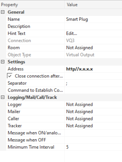

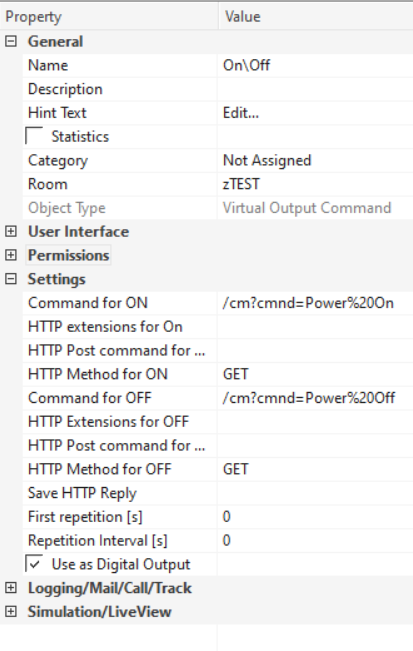

    I have a smart plug which has been flashed with Tasmota v9.4.0 and connects easily to my wifi network so I am able to send http commands to it.
    However, although I can successfully send http commands through a browser to switch on/off, I can’t seem to get the same commands to work in Loxone through a Virtual Output.
    I attach screenshots of my Loxone VO config in case I’m doing something obviously wrong.
    Cheers
    Rob

    Hy,
    you need to replace the IP x.x.x.x will not work.
    If you used the x to anonymise check the VO xml from the loxwiki : https://www.loxwiki.eu/display/LOX/E...Tasmota+Sonoff
    Mine works with the VO without any problems.

      There is no colon after http in the address. If this is also the case in the real address, then it cannot work
        Ohhh, well spotted!!
        Schoolboy error from me...........added the colon and all working.
        Thanks so much
        Rob
