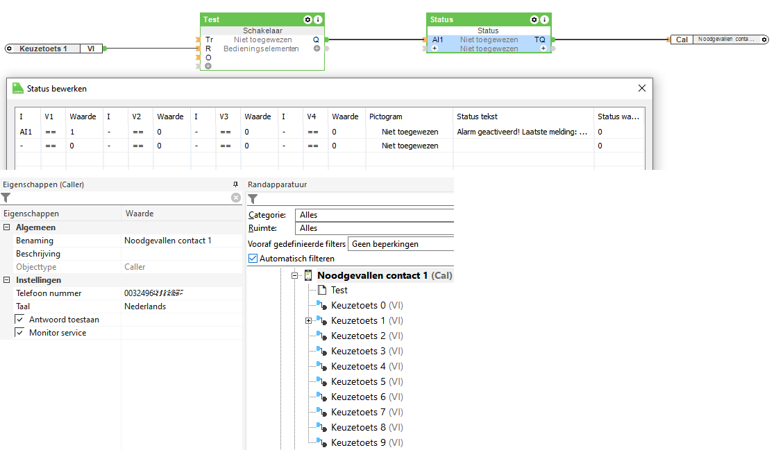

    I activated the Loxone caller service trial before I purchase a year caller service key.
    I set up everything in my Loxone config project as it should be (knowledge base).
    But mentioned the alarm caller service call to my cellphone (0032496xxxxxx) was not received always.
    I create a simple Loxone config to monitor the Loxone caller service reliability (Loxone config with simple test in attachment).
    A switch, with output the caller service to my cellphone and as input the caller key press "1" to reset the switch to "off" position.
    I used this basic test to perform a test occasionally.
    I mentioned the same result, not every caller service trigger is received on my cellphone.
    Which makes the Loxone caller service unreliable to use as an additional alarm notification
    Any other noticed the same issue already?
    Loxone ticket is already created, I will keep this forum thread up to date with their feedback / response...
    2021-11-28 +/- 13h30m20s CET Not received!
    2021-12-01 +/- 09h22m30s CET Not received!
    2021-12-01 +/- 09h53m29s CET OK
    2021-12-01 +/- 11h26m05s CET OK
    2021-12-02 +/- 15h49m23s CET OK
    2021-12-04 +/- 12h57m31s CET Not received!
    2021-12-06 +/- 09h13m14s CET OK
    2021-12-06 +/- 12h35m58s CET Not received!
    2021-12-08 +/- 09h26m06s CET Not received!
    2021-12-08 +/- 09h40m13s CET OK
    Loxone config with simple test in attachment.
    All advice is welcome!

        Created a Loxone ticket 7 days ago, still no response
        So want to ask the community for similar / related issues in the meantime.
        Will keep this forum thread up to date with the response from Loxone (root cause).
