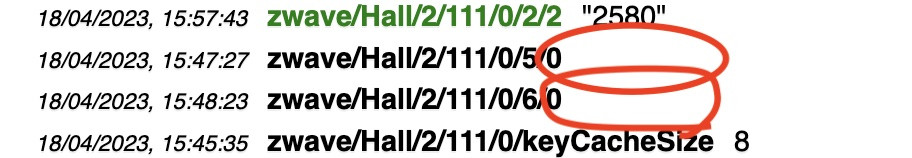

    Hey all
    I'm trying to integrate a Ring V2 keypad as there seems to be limited options on the market to have a dedicated keypad for the alarm.
    I have the pad connected and configured via Z-Wave JS (The only way to support S2 devices). I am then sending all the info via mqtt.
    The problem comes where my skills are lacking. The default message type is via json. Which is ok when reading values as they are expanded and easy to read. Where I stuggle is able to send messages via json from loxone to be able to trigger features on the keypad.
    I am able to have a small workaround for this by using 'value only' option in Z-Wave JS which solves my writing issue but commands from the keypad now show with no value and just the time stamp gets updated so then there is nothing to read and use as a trigger,
    See here:

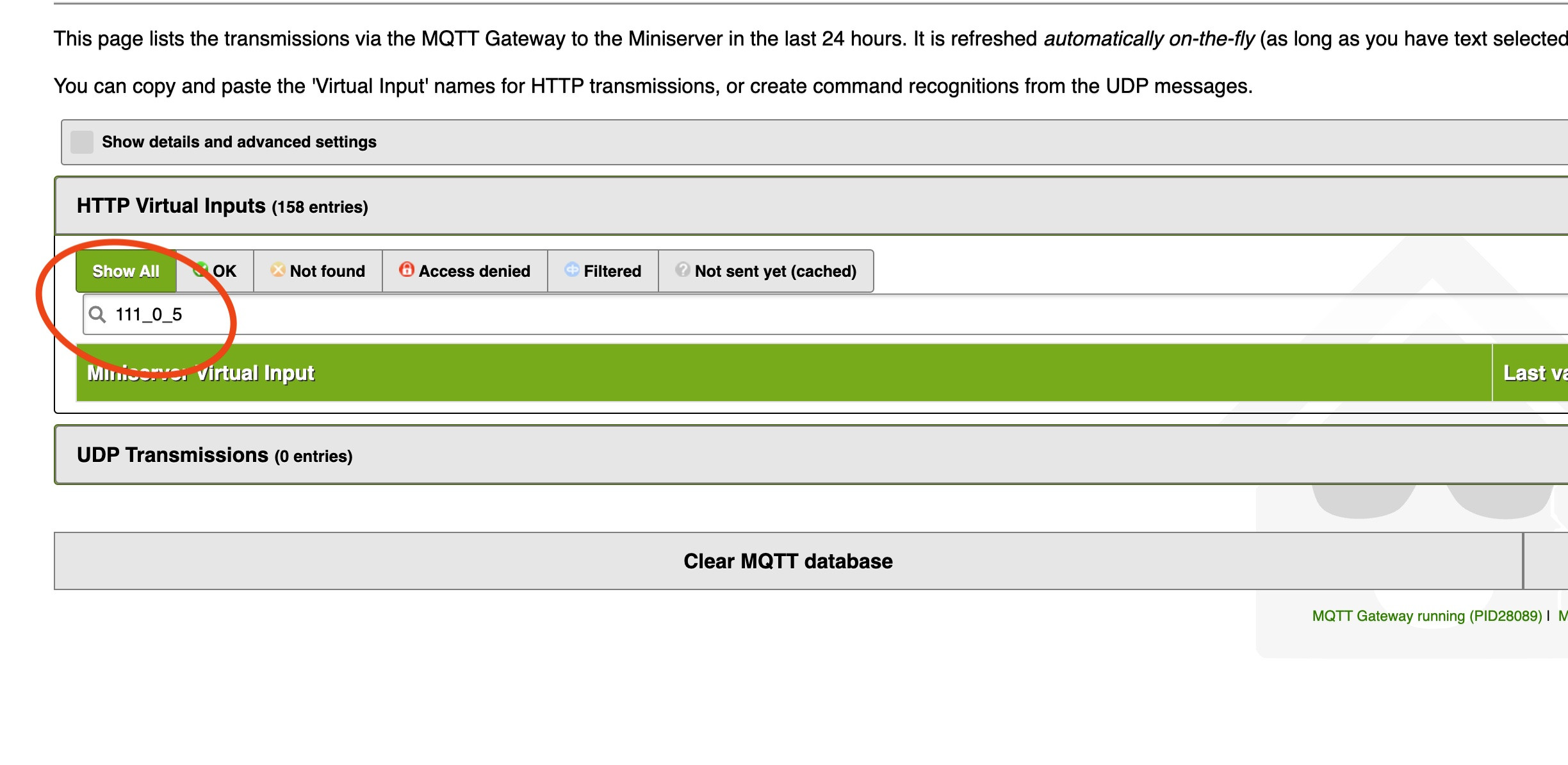

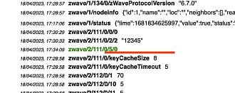

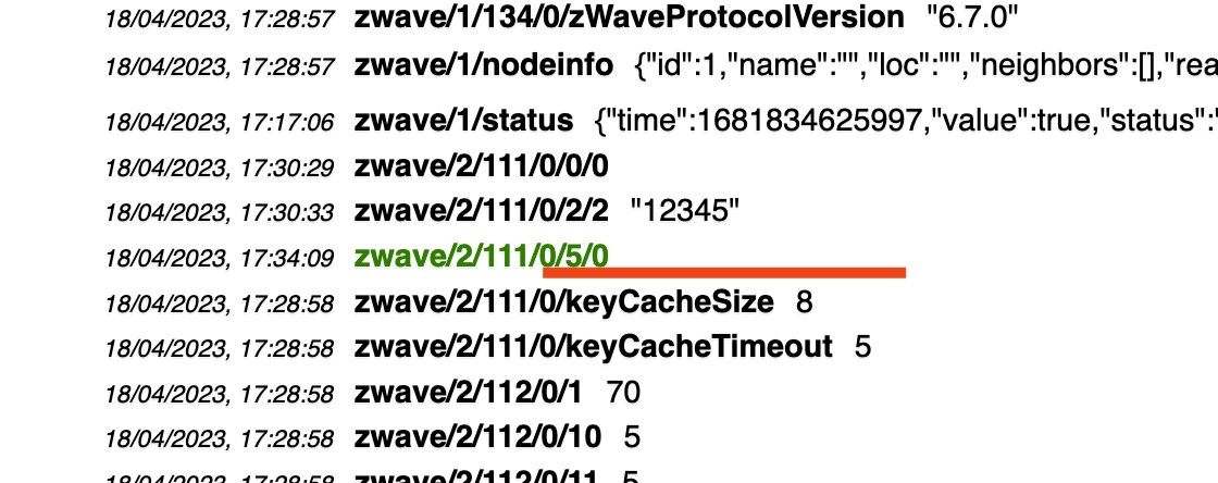

      Thanks for the JSON clarification.
      As for the topic with no value see below. I can see the trigger in the incoming overview. But then as there is no data or it's happening too quick then nothing is being populated in the gateway and I can't use it as a trigger in loxone
      See below:

        Check the MQTT Gateway Log, what data have arrived and have been forwarded.
        You won't see pulses that immediately are overwritten in these views.
        • edipseamm
          • 03.02.2020
          • 60
          19:55:16.140 OK: MQTT IN: zwave/2/111/0/5/0:
          19:55:16.141 zwave/2/111/0/5/0 is cached
          19:55:16.141 zwave/# matches zwave/2/111/0/5/0, send to MS 1
          19:55:16.142 HTTP: Preparing input zwave_2_111_0_5_0 (using cache):
          This is what is received

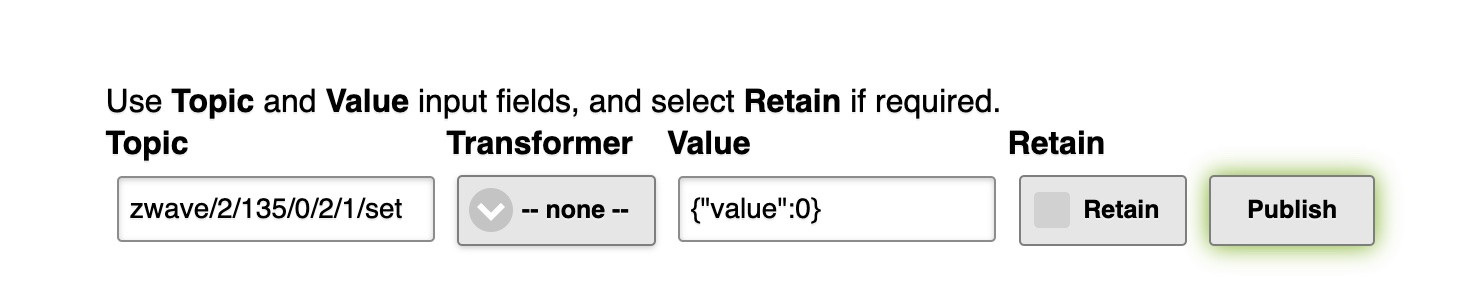

            Ok. Changed the config a little but using json
            I'm able to write what I need via this. Pretty simply
Ansichten: 282
Größe: 56,1 KB
            The only thing is the button presses just come in as epoc time stamps.
            I'm just using this as a DI input and using the 'reset after send' function in the incoming. Is there a better way to do this?
              When it is working that way, then it's fine?

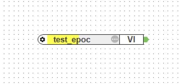

                    Yes this should work and I did try this before but the max value allowed in loxone via a VI is 2147483647 and my epoc value 1681718477549 for example so the value is to large.
                    Arghhhhh
                    Any other ideas?
                      Possibly this works with a Virtual Text Input, but presumably not…
