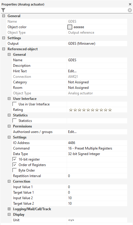

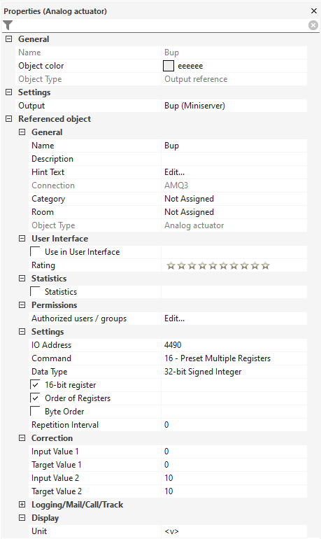

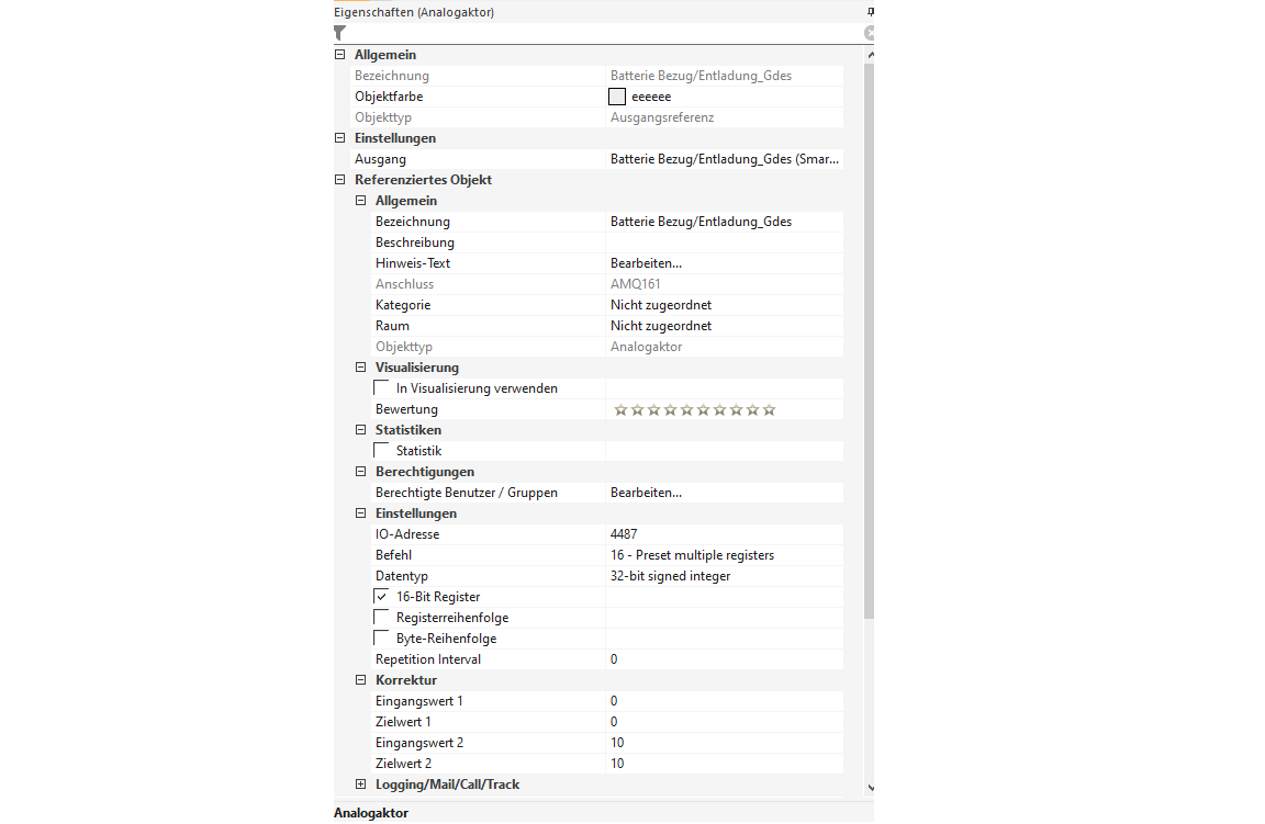

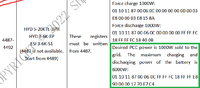

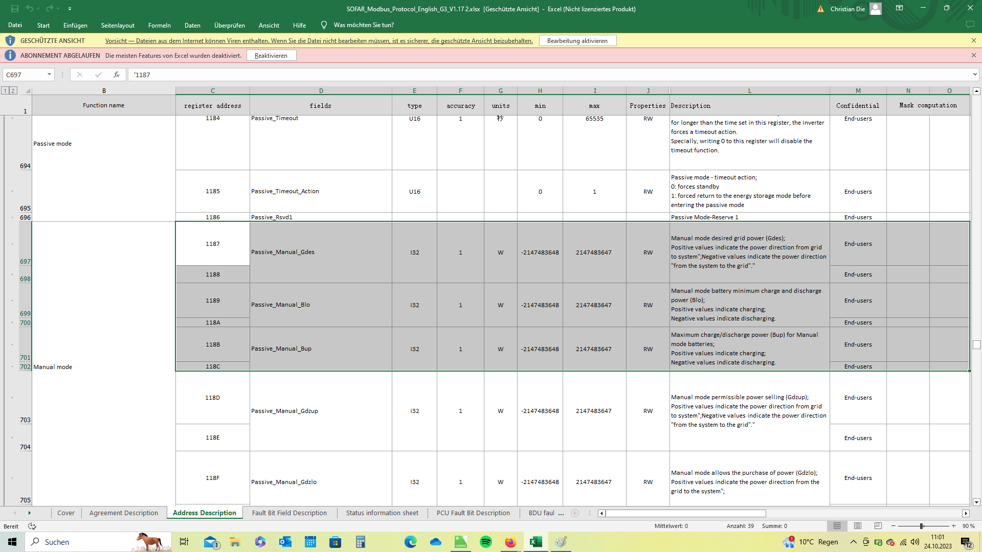

Ich muss diese 6 Register (siehe Anlage) gleichzeitig schreiben aber bekomme es nicht hin.
Muss ich die 1187+1188 jedes für sich anlegen und schreiben oder zusammen da ja laut Beschreibung 32 Bits?
Mir ist das nicht ganz klar.

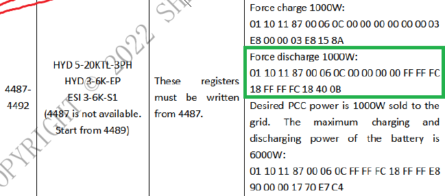

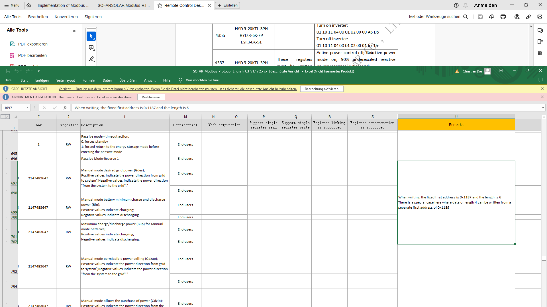

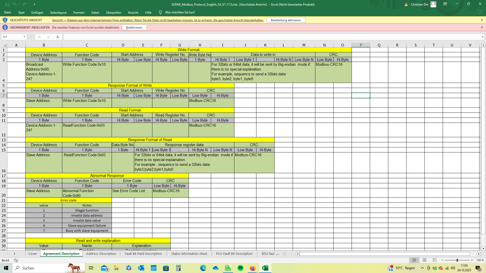

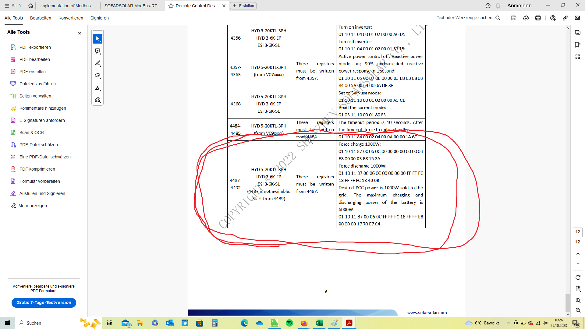

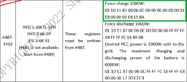

The following description is applicable to the 'Force Charge 1000W'. The green highlighted area are the Hex values that would be sent from an RS485 Extension. This matches the Excel information you posted earlier in the 'Manual mode' for Modbus commands.

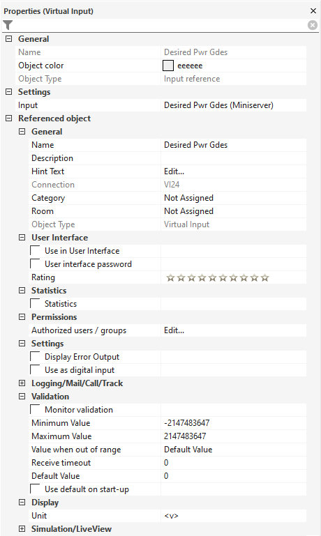

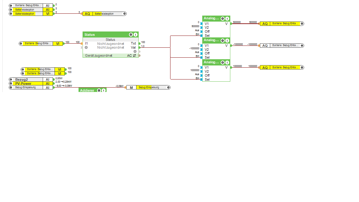

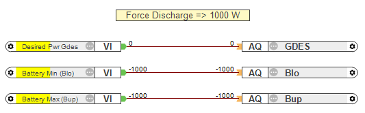

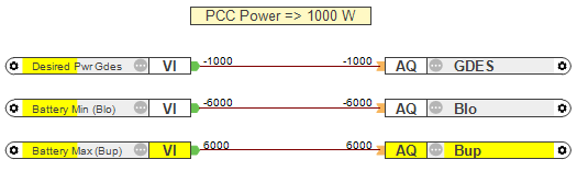

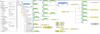

I recommend using Virtual Inputs to drive the Actuators for testing and use the Loxone 'LiveView with Manual Valve Adjustment'. Then you can simply type in the values in the Config.
Virtual Inputs for all three actuators (just change the Name) -
Hello Tico, thank you very much for your work! I really appreciate that. However, it doesn't work. The three values have to be written at once. I tried this using an analog selector switch and also with the virtual inputs you created. Nothing works at all with 32-bit settings. With 64-bit settings, values come but they do not match the transmitted values. I have to say that I don't use a Modbus extension but a TCP converter from Waveshare. But that shouldn't actually be a problem since I can read and write simple 16-bit values. Is it possible that Loxone cannot write these multiple registers? Have you ever tried writing multiple registers in Loxone for something else? Thanks and greetings, Chris

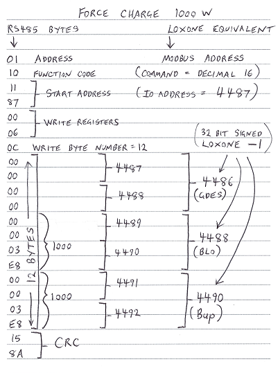

Looking through my projects, I don't have any 32bit actuators to test. I could be a limitation of Loxone that it can't do 32bit actuators. Can you instead write 6 x 16bit registers simultaneously? Is there a defined timeframe that all register commands must be sent in?
ie. Force Charge 1000W
Register 4486 = value 0
Register 4487 = value 0
Register 4488 = value 0
Register 4489 = value 1000
Register 4490 = value 0
Register 4491 = value 1000

Apparently you have to write the three multi-registers at the same time for the inverter to accept them.

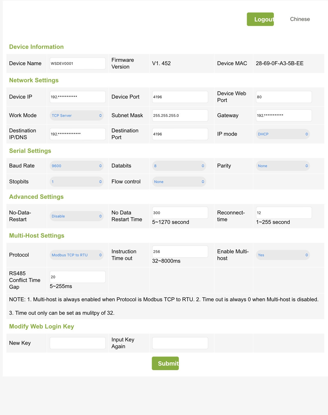

The Web Configuration of the Waveshare device appears to have many parameters. Combined with getting Loxone correctly configured, that's a lot of parameters to get exactly right. You might find the simplicity of going Loxone Modbus Extension direct to the device is successful.
Notwithstanding, you said you were reading values ok now. The 'Work Mode' of the Waveshare device strikes me as a possibility. Can you post the equivalent page of your settings -
I interpret GDES as the Grid Connection desired power flow. The charging current of the battery reads as being controlled by a combination of Blo and Bup. ie The Force Charge example above.

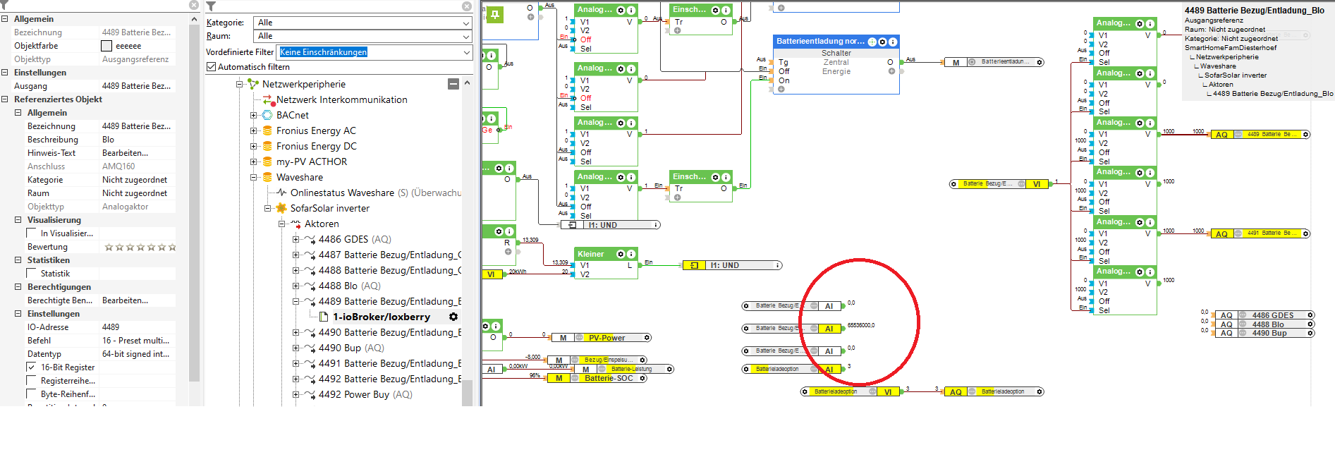

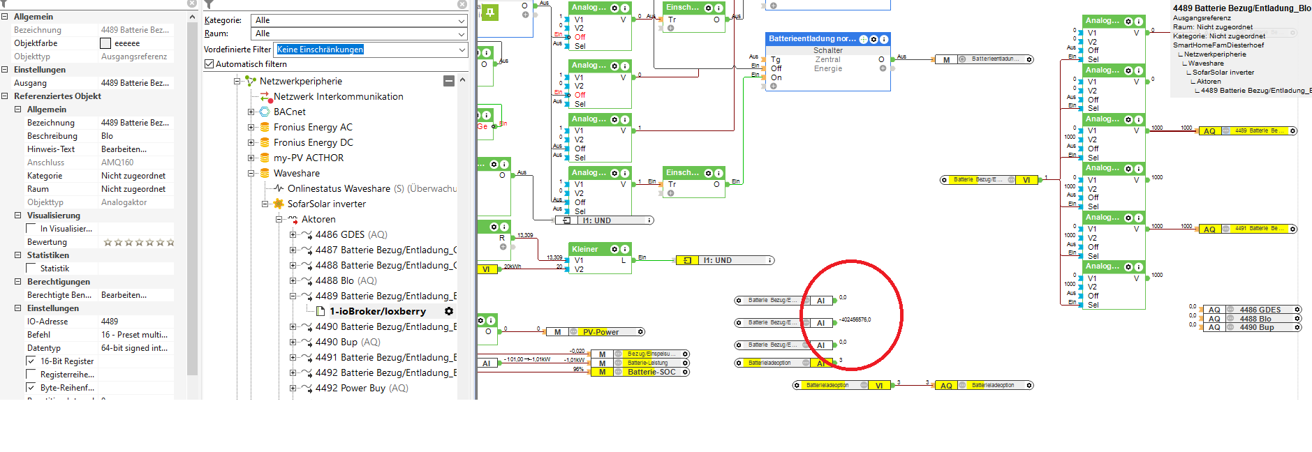

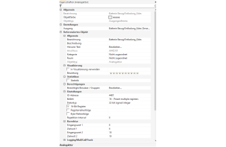

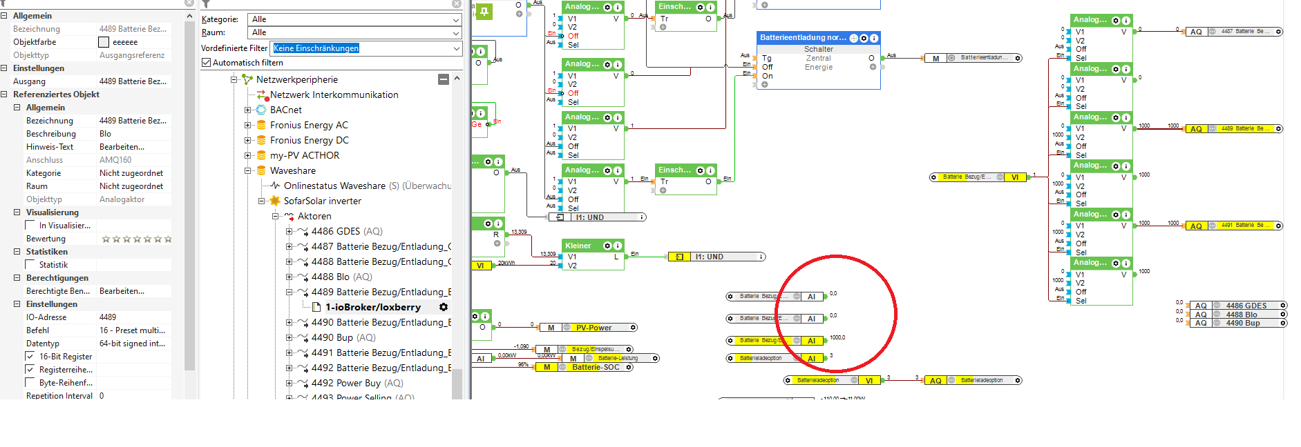

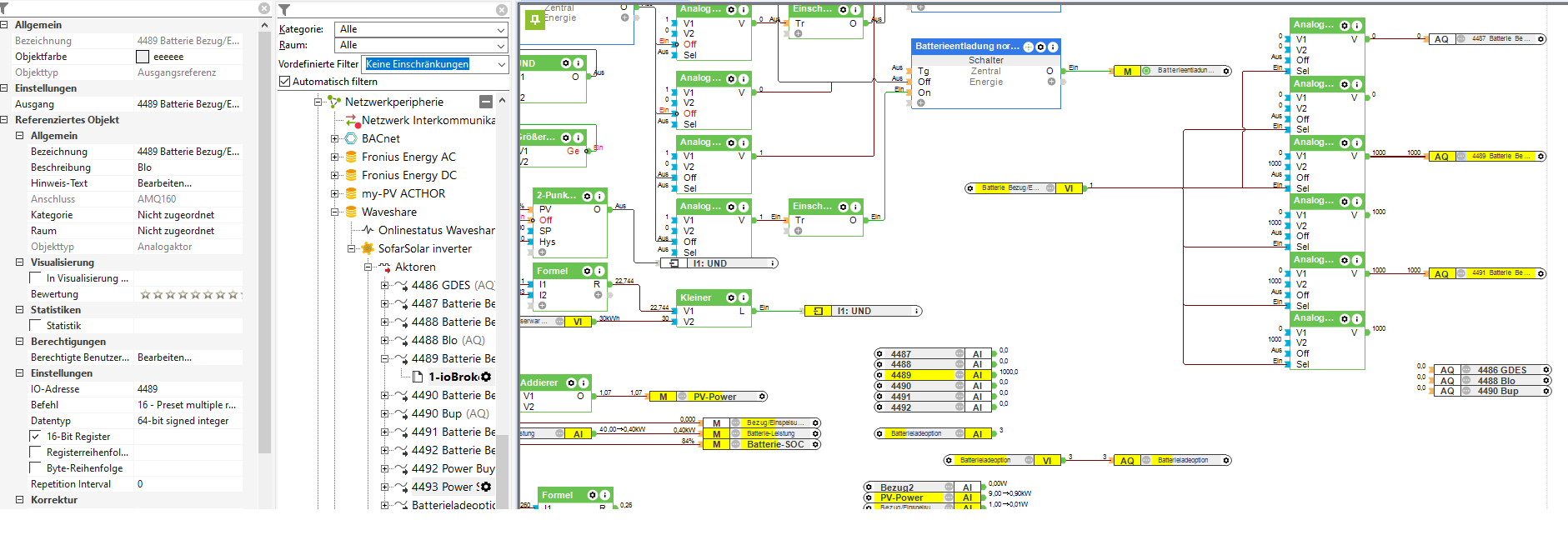

Hello Tico, here is the information you are looking for. I hope you can read a little something from my screenshots. You can only control anything with 64-bit settings. However, the values that are read do not match (red circle).

It is not so easy to map all changed parameters. Of course I tried all registers as suggested. also individually as 16-bit variants. Only with the 64-bit setting does something happen. Screenshot 1 drained the battery, screenshot 2 powered the battery from the mains and screenshot 3 shows no effect. but when unloading and loading this happened with the non-specified values. I know it may be asking a lot, but would it perhaps be in your interest if you could take a look at it yourself remotely? Maybe I'm just missing something? Thank you for your commitment! oh and about the addresses. I can create the ones that can be read correctly as normal. without deducting a spot. When writing the values, I also tried subtracting the addresses by one place. but unfortunately it didn't do anything.
Given that you have sensors that are reading correctly without deducting a spot, I will assume that writing to actuators should occur without deducting one place.
I will only address the first two screenshots where something is happening to the battery.
Those screenshots of the values being returned are helpful. I can see what you are sending as Actuator settings. I can't see what you have set up as Sensor settings.
The problem appears to be getting the bytes in the correct order for the sensors.

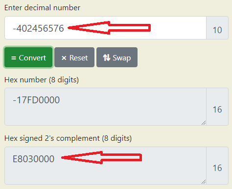

If you look at the first screenshot of the value returned -
Decimal to hex number conversion calculator and how to convert.

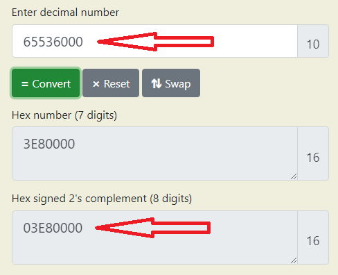

Then consider what Loxone is 'seeing' in the 12byte value field - it reads down the column and re-orders the bytes according to your settings.
The sensor is reading hex values of E8 03 00 00, but 1000 has a hex value of 03 E8. The hex value 00 00 03 E8 will be read as 1000 (leading zero's are ignored). ie. reverse the byte order of the sensor to read 1000.
I think you said this scenario was draining the battery.
Then look at the 2nd screenshot of values returned -
65536000
We see 03E8 which is equal to 1000. But it is also picking up an extra 0000 (which makes it decimal 65536000 in Loxone).
I think the way forward is to create six sensors (one for each register); 4487, 4488, 4489, 4490, 4491, 4492
Unfortunately it took a while to respond but unfortunately i was unable to attend. I just played around with your values a bit again. I created the six sensors as suggested. On the screenshot you can see them and the received value. The old values were somehow no longer displayed to me.
But now it doesn't change anything about the behavior of the battery. I can't load/unload anything anymore. I don't know what the problem is and how I can move forward now? Thanks anyway for your help. Maybe you can think of something else?
I don't have a lot to go on unfortunately. I would suggest experimenting with the Actuators until you can reproduce the forced charging and forced discharging. Only when that occurs can headway be made.

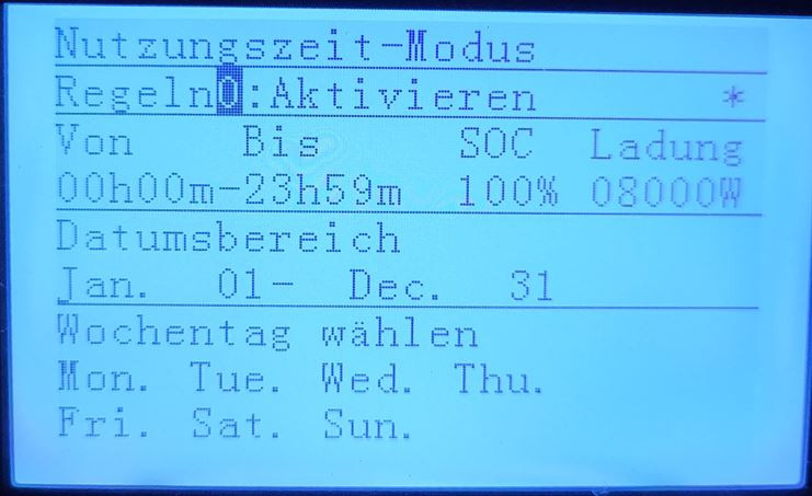

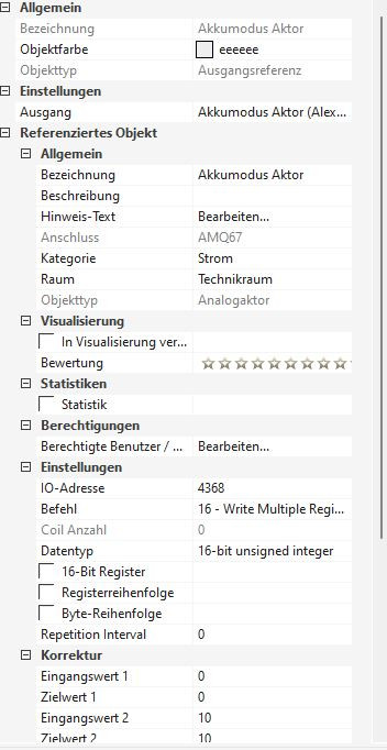

Servus,
Da ich es mit Loxone nicht schaffe, diese Parameter zu verändern bzw. gleichzeitig in mehrere Register zu schreiben, schalte ich nun nur zwischen Nutzungszeitmodus (1) und Self-Use Modus (0) hin und her. Das funktioniert ganz gut. Die Ladeleistung kann ich zwar nicht variieren, das stört aber nicht wirklich. Die habe ich nun fix eingestellt auf 8kW. Der Register den ich als Aktor nutze ist Nr. 4368.
Damit die Steuerung über Loxone funktioniert, müssen am Wechselrichter einmalig die Zeitparameter gesetzt werden.
