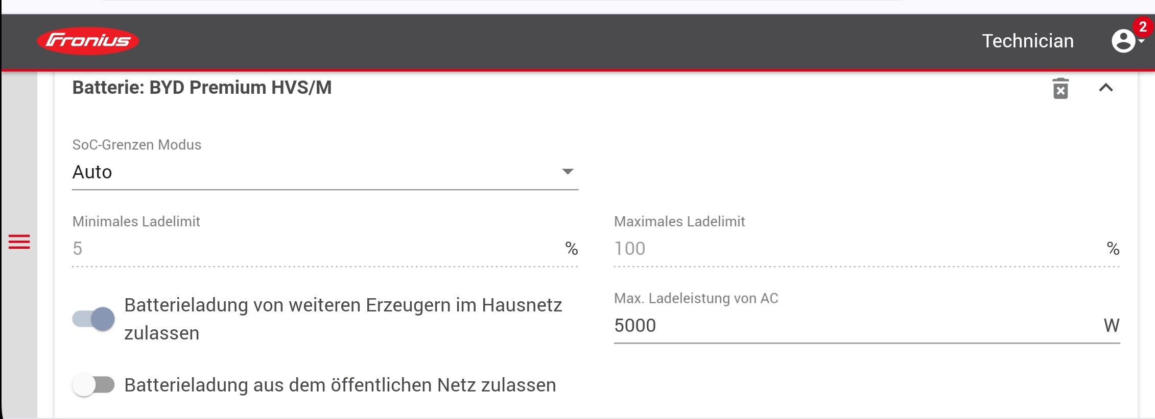

          I have two independant Fronius battery systems. One system (System 1) is set up conventionally and linked to a Fronius Smart Meter. That system works in the sense of how Fronius designed it.
          The other Fronius battery system (System 2) is controlled entirely by Loxone and doesn't have reference to a Fronius Smart Meter. Both systems are linked by the logic of Loxone.
          If System 1 is charging at X rate, System 2 is controlled by Loxone to charge at 0.5X. Likewise for discharge. The protections for the battery are inherent in the Fronius inverter to Battery link. You are correct, the inverter's automatic systems take care of the low voltage protection.
          This link might provide further background -
          You can set 0% Minimum SoC, but the battery will only discharge to the low voltage cell limit of 2.7V. Practically, this works out to be about 2-3% SoC. 0% SoC and 2.7V doesn't exactly match because discharge stops when the lowest cell voltage reaches 2.7V. There are multiple cells in each battery module that will be have a slightly higher voltage (and more energy remaining).
          • looxer
            • 23.09.2018
            • 48
            Many thanks Tico. So in essence, I can remove all the battery protection from my loxone implementation and run the battery from 0 to 100%, as long as I have the minSoC settings configured an set to Automatic on the inverter, right?
            • Tico
              • 31.08.2016
              • 1035
              Correct, you don't need any low voltage protection in the Loxone implementation. It is my understanding that the battery will be protected in both 'SoC-Grenzen Modus' Automatic and Manual Mode. The Manual mode only exists to provide a user selectable battery range. ie. 20% to 80%.
              One aspect you may wish to check is the Calibration Charge. After a set passage of kWh's, the 'stock' battery runs through an automated Calibration Charge to 100%. This is important for cell voltage balancing and resetting the 100% SoC reference.
              Do you have any notification in the Fronius/BYD system when the battery approaches 100%? Is it automatically doing a Calibration Charge for the final few percent SoC when in manual mode?
