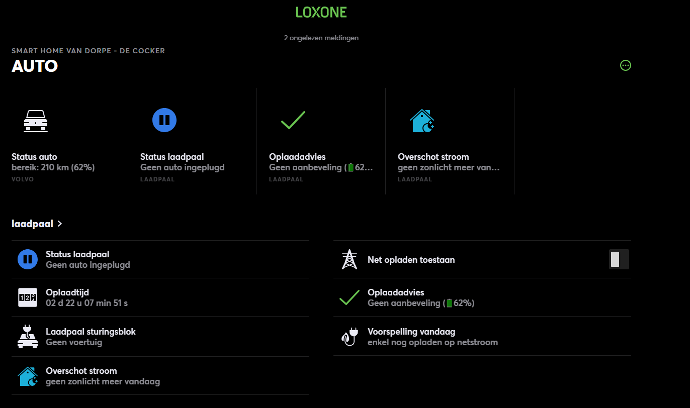

      I didn't integrate it in Loxone itself.
      I used volvo2MQTT on my HA
      Home Assistant addon for connecting AAOS Volvos. Contribute to Dielee/volvo2mqtt development by creating an account on GitHub.
      This I linked to my loxberry mqtt in the config.
      If you have nog loxberry, you can also send values directly to your loxone from HA using the following method:
      Hi all. I recently bought a Loxone miniserver in a transition from HA to Loxone. Some devices, like my digital grid meter, are not easily integratable in Loxone (but are in HA). I’ve been investigating a lot on how to easily send data from HA to Loxone. I’m not a big fan of more “heavy” solutions like Loxberry/MQTT, a combination of VO/VI’s in Loxone, etc. However, I managed to find a very easy, fast and lightweight solution for this: send sensor values directly to a VI in Loxone. 1. Add a ...
      I used some of the car-value in my Car-category in the loxone app
