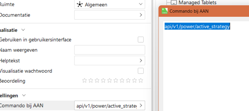

    Dear All,
    I am becoming a bit crazy when using the virtual output command. I hope that someone can give me some advice, so I will become able to send a command to my home battery.
    When starting with the Virtual Output command, I import the URL (including the login and password), to connect with the home battery. This URL is confirmed to be working
    Then I should insert the virtual output command:
Ansichten: 72
Größe: 171,0 KB

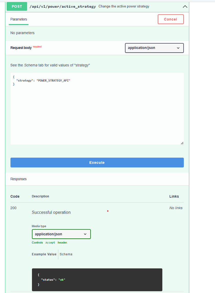

    Below you can find the documentation from the battery supplier Sessy. In this direct URL into the Battery API I can test this, and this works.
    But now I need to perform the input in a correct way in the Loxone Config
Ansichten: 142
Größe: 39,6 KB

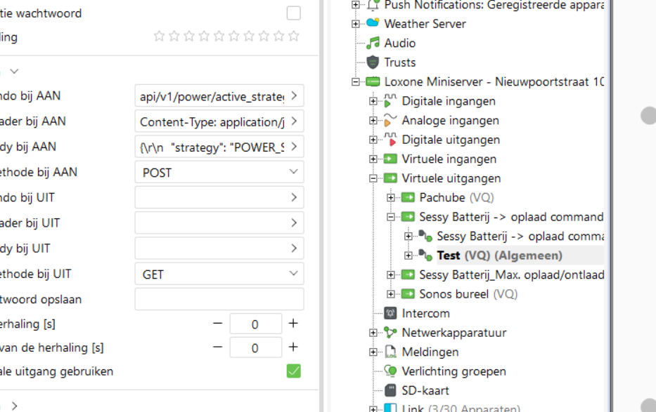

    Below the following try, but without succes. So what am I doing wrong here????
Ansichten: 70
Größe: 59,2 KB

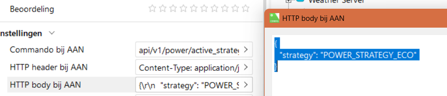

Ansichten: 64
Größe: 61,6 KB

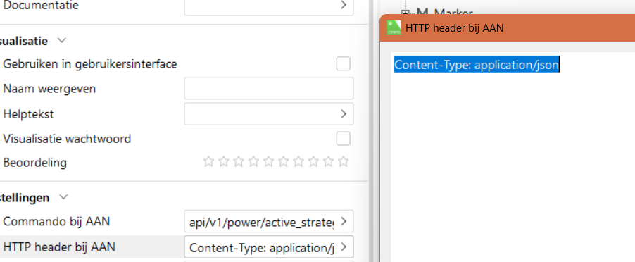

Ansichten: 62
Größe: 50,9 KB

    If you don't put the r and n behind the bracket and before the end? So that you just have the body?
