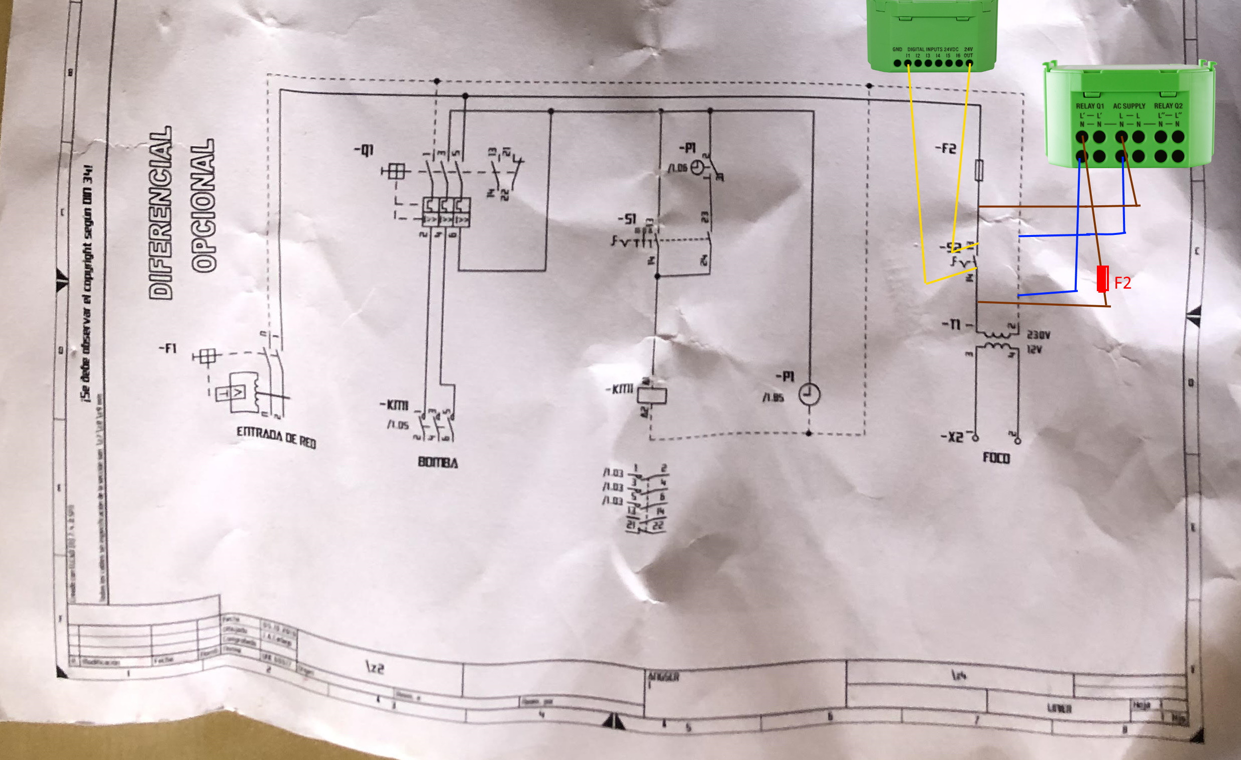

    I'm trying to put the pool lights on loxone but I don't quite understand how I have to wire it. They are 12v lights, I have the switch in the house and I want to manage it with the app since the house is buried and is difficult to access.
    I am attaching the plan of the box to see if anyone can help me to see how to make the connections between the lights and the Nano io AIR.
    Thank you very much for the help.
    Sorry for my english, is the google translate
    Your scheme is not very clear (letters are unclear), but from my perspective, on the left is the RCD and main fuse.
    The phase wire connects to another fuse F2 and further to the current light switch S2.
    You require to disconnect the phase directly before S2, and connect phase and neutral to IO Air.
    The transformer then will be directly connected to the switched outputs of IO Air (L’ and N).
    The original switch now is not connected anywhere. To use the original switch, connect the IO Air’s 24V-Out and I1 to the switch.
    All further programming is done in Loxone Config.
    https://www.loxone.com/dede/kb/inbet...e-nano-io-air/
    Disable the RCD and/or fuse before doing anything, otherwise you’ll get grilled 🔥. 🥳
    On any doubts, call an electrician.

      PS: If possible, it would be preferable to place the F2 fuse between IO Air‘s L’ output and the transformer.

        I attach an image with the connection that I have understood, is it correct?
        Feel free to comment.

          Looks great 👍 🙂
          Of course, all the old connections between the primary side and the secondary side (from the old plan) are away.
