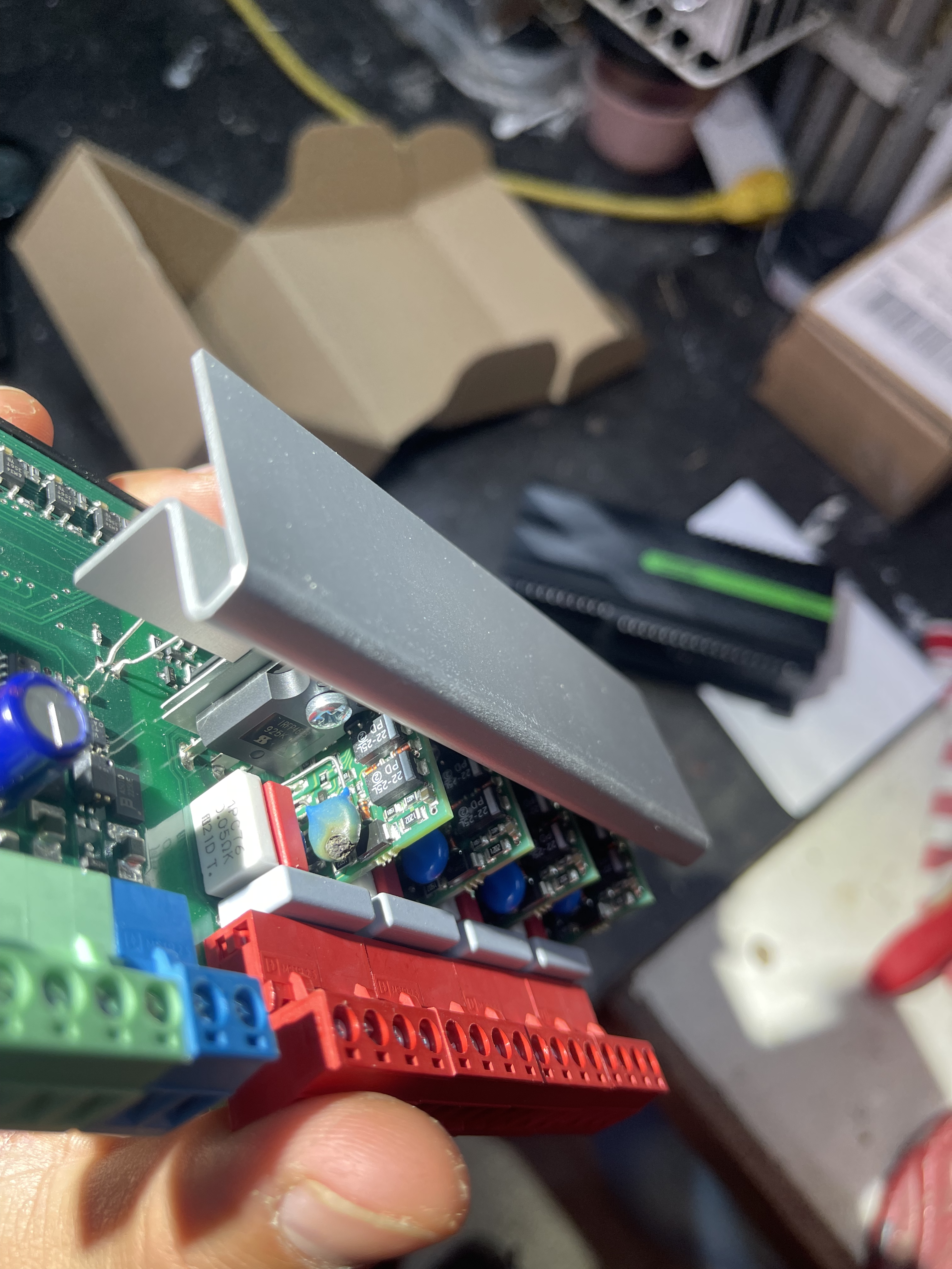

    Hello,
    In my brother's project, we have Kreon built-in spots in the ceiling. These are old-style GY6.35 12V halogen bulbs driven with magnetic Niko transformers.
    We have 17 of these lamps. Most of them work perfectly.
    However, 3 lamps cause the dimmer extension to burn. I'm not kidding. They woke up in the middle of the night with the fire alarm blaring and their utility room smelling like smoke.
    The dimming channels look like this. As you can see, the blue thingy is completely charred. We have another dimmer extension with two of these burnt-through channels. All channels are configured with Load Type "
    Low voltage halogen lamps with magnetic transformer (MLV)
    .. as per the documentation.
Ansichten: 270
Größe: 11,76 MB
    has anyone encountered this yet??
