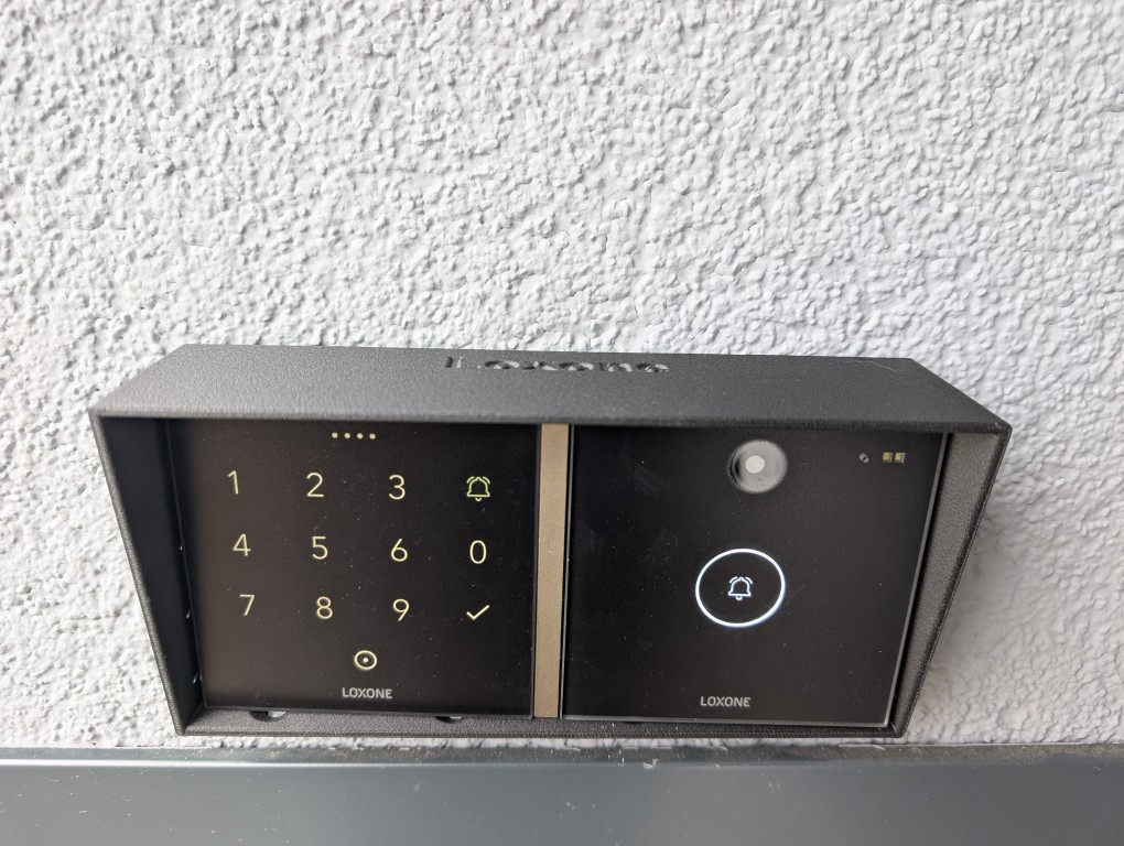

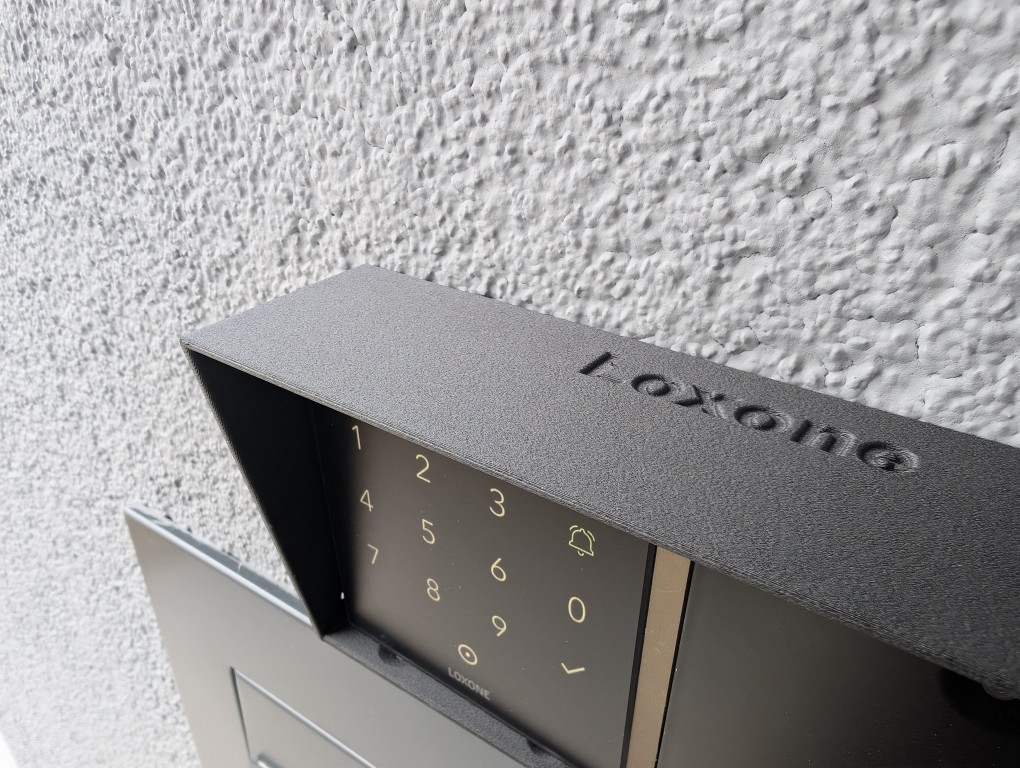

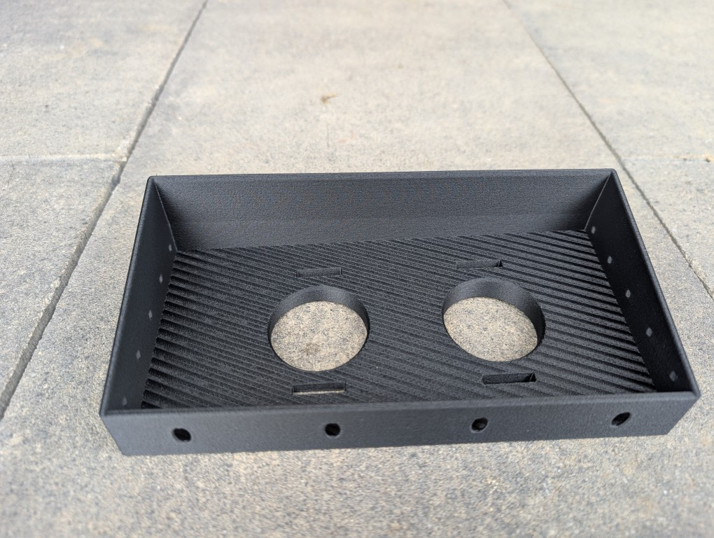

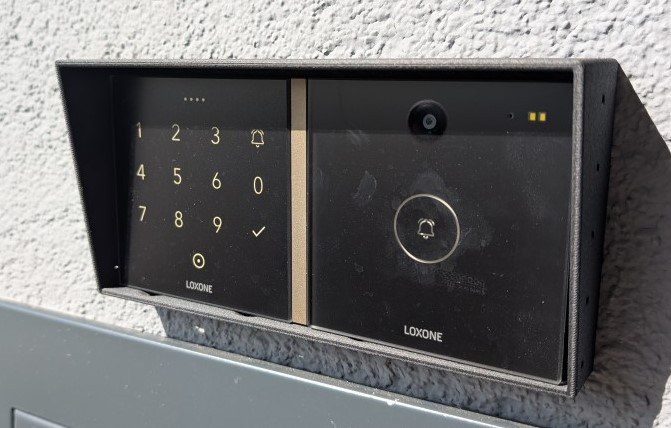

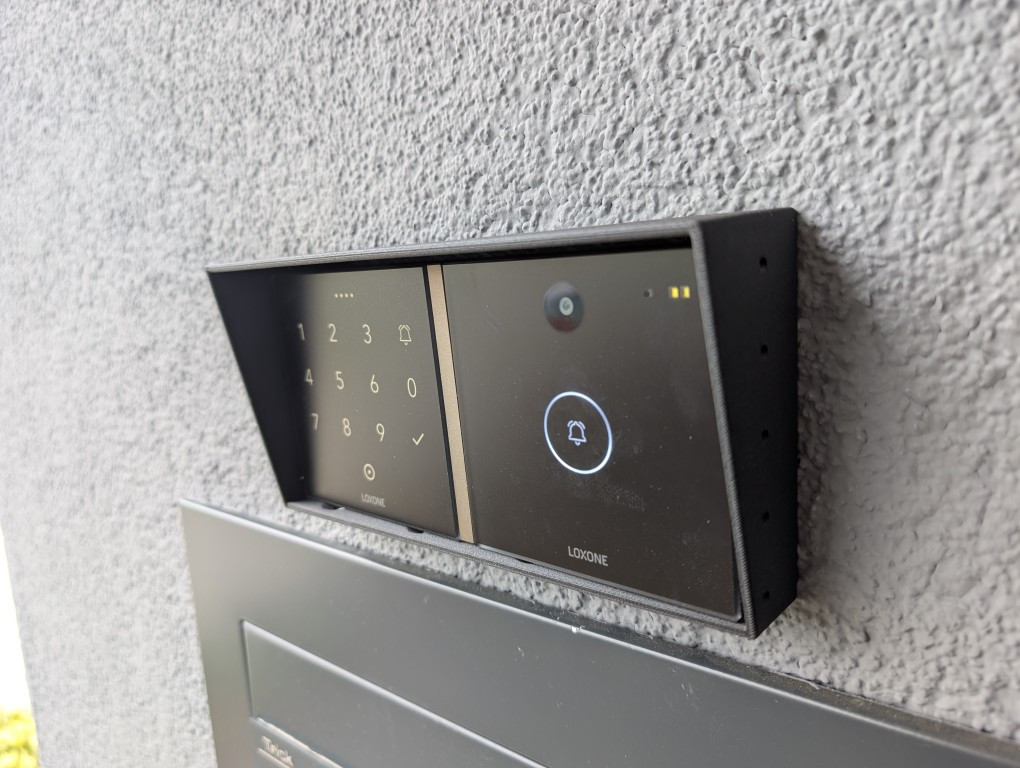

    Our Loxone Intercom is quite exposed to sun in the afternoon and also to rain (when it comes from the sun). Also is there are some children due to the angle they can not be seen via the camera.
    So I decided to design a customized protective cover with the following features:
    - protects against sun (especially the camera lens) and therefor temperature and rain
    - water drain if still water comes in
    - changes angle of the Intercom to the outside and downwards to see less from the sky and less from the door but more from the people in front of it!!!
    - vent holes for air flow
    - holes for installation and cables
    - super nice design
