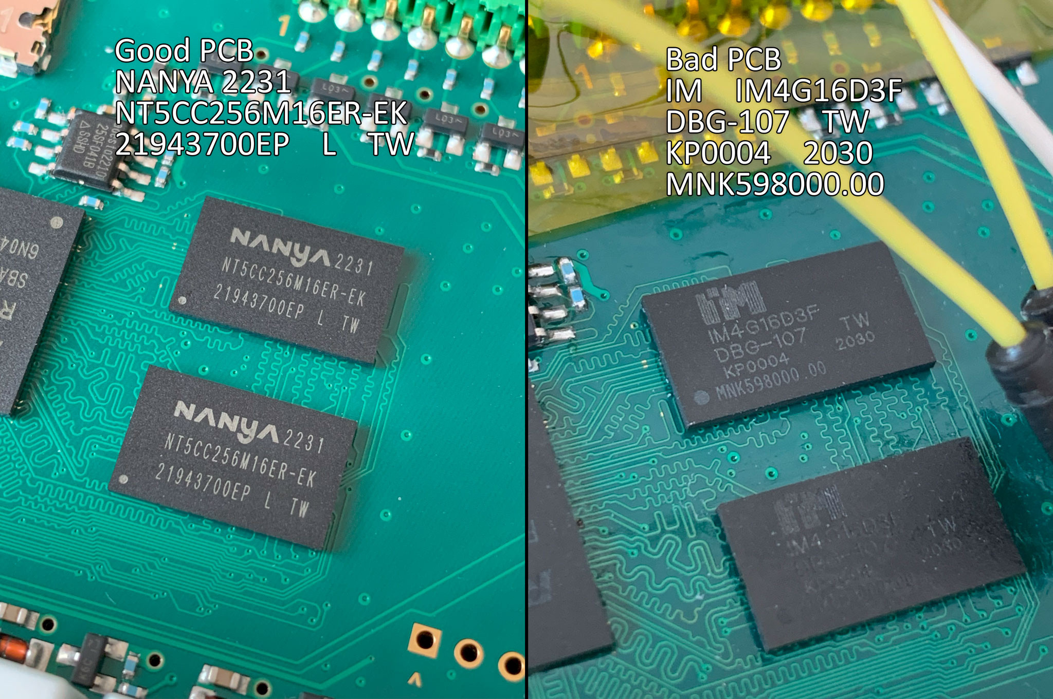

    If anyone has the SPI chip firmware for the Loxone Miniserver Gen2 and is willing to share it, I would greatly appreciate it.
    I already have the firmware for a unit with NANYA RAM chips, but I'm specifically looking for the firmware for a unit with IM4G16D3F RAM.
    I guarantee that I will not use the Miniserver's serial number for any purpose, or you can clear it before sharing if preferred.
