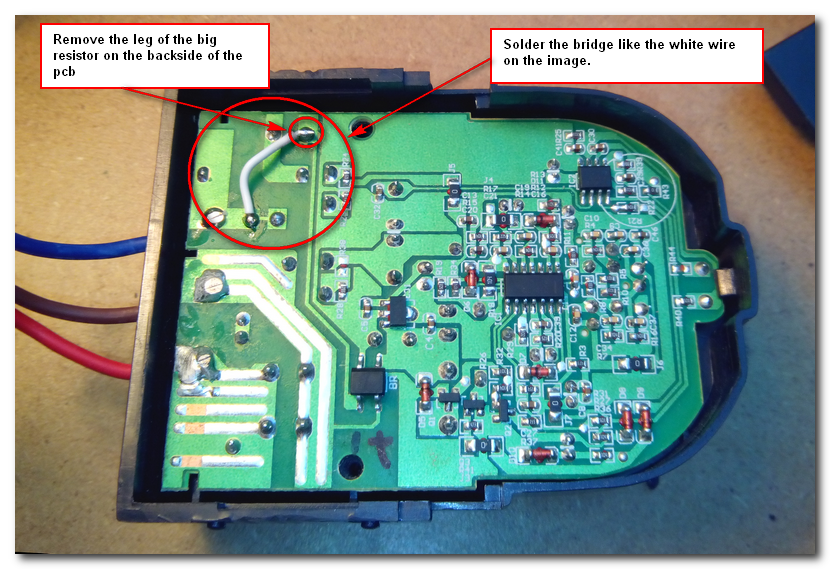

          If you are not afraid of a very simple modification, than you may look at a Niko PIR sensor 350-20158. http://www2.niko.eu/enus/article/350-20158
          This is a 230VAC outdoor PIR but works internally on 24VDC, you need to desolder one leg of a big resistor (no need to remove it) and solder one wire on the PCB. This results in a fully functioning 24VDC PIR for your Loxone.
          See picture below.
Name: Niko Niko PIR sensor 350-20158 hack.png
Ansichten: 4337
Größe: 681,3 KB
          What you do is actually bypassing the resistor which is normally fed by 230VAC and you place 24VDC on the rectifier bridge. (I marked + & - on it on the PCB if you notice.)
          I have 2 of them working fine, they cost around 59Euro I believe and you can adjust the sensitivity and time delay on the front of the sensor.

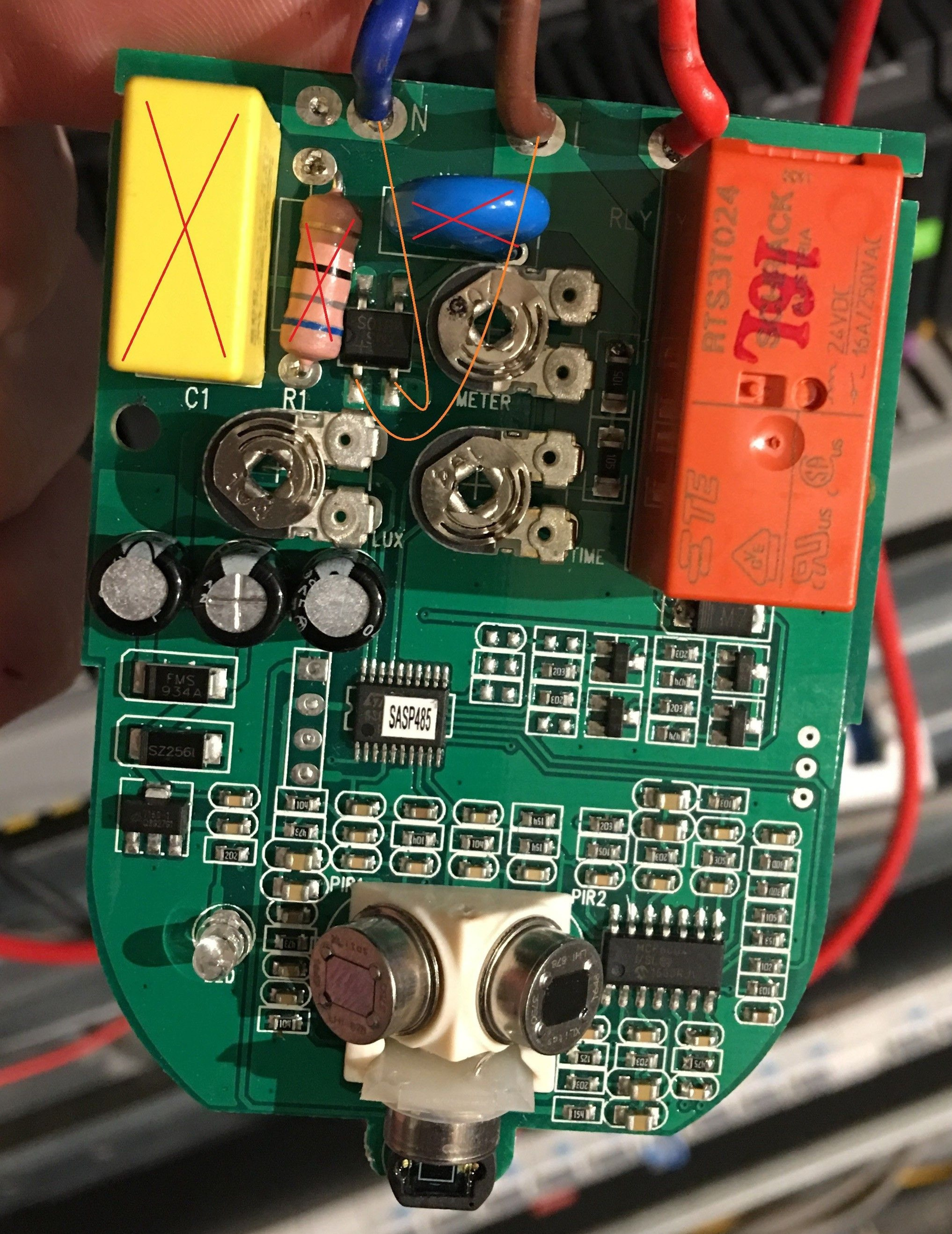

                      I've ordered 1 piece of the Niko outdoor motion sensor, to check if it is still able to modify from 230v AC to 24v DC.
                      On loxwiki they noticed the PCB design has changes since then
                      I will keep you guys posted about the Niko modification.
                      But in the mean time, are there any other dark outdoor motion sensors working on 24v or able to modify from 230v AC to 24v DC?

                        Before mod, measured the output after the bridge rectifier.
                        When motion detected (relay powered on) +/- 27v DC
                        When no motion detected (relay powered off) +/- 7v DC
                        I guess this could be related as it is a simple small transformerless power supply.
                        Previous advice to remove some components of the new PCB design sounds good, as they all are related to the “transformerless power supply”, to test it I removed:
                        • Suppression Capacitor 0,33uF mpx 250v (yellow)
                        • Resitor 68 ohm
                        • Metal Oxide Varistor vdr 10d471k (blue)
                        • Bridge rectifier mb10s (black)
                        But without luck, 24V DC is supplied with an external PSU.
                        No sign of life…​
