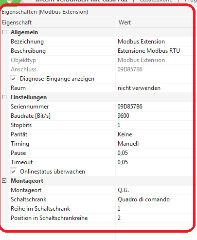

    Dears,
    I'm trying to integrate the Deltaohm HD3910 sensor, which I bought with Modbus communication. Here attached u can see some screenshots of Loxone Config setup and the DataSheet of the HD3910.
    I'm not able to get the values out of it... I always see 0 from all 3 registers available.
    - I've left the sensor attached to the Loxone 24Vdc and connected the Modbus wires to a usb-Modbus converter, using ModbusDoctorV2 application on the PC: from here everything works just fine, same speed and parameters (Address 05H, 9600, 8-n-1) I've used with Loxone Modbus extension.
    - Since I also have other 2 devices connected to the Modbus extension, and they're working fine. I've double checked the Address and they're 1, 2, 5.
    - I've terminated the last device with a 120R.
    I really don't know what else I can do here... on Config there's no helpful monitor, and I don't want to go ahead using a Modbus protocol analyzer...
    Thanks!

    Please check the Sensor manual, on page 4. At the top (1.) you can read:
    By default, the parameters are:
    19200, 8, E, 1
    Your Modbus Extension setting is different !!! ( 9600 )
    For a first test i would change the Extension settings to 19200 to see if this helf in receiving data, if so, then i would reconfigure the sensor itself to work with 9600, 8, n, 1.

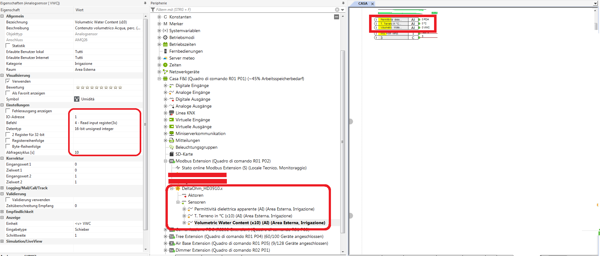

                Did you try to enable the settings for the register order or the byte order, to see something is wrong there?
                In addition, I would try different wait and timeout settings to give the sensor more time.

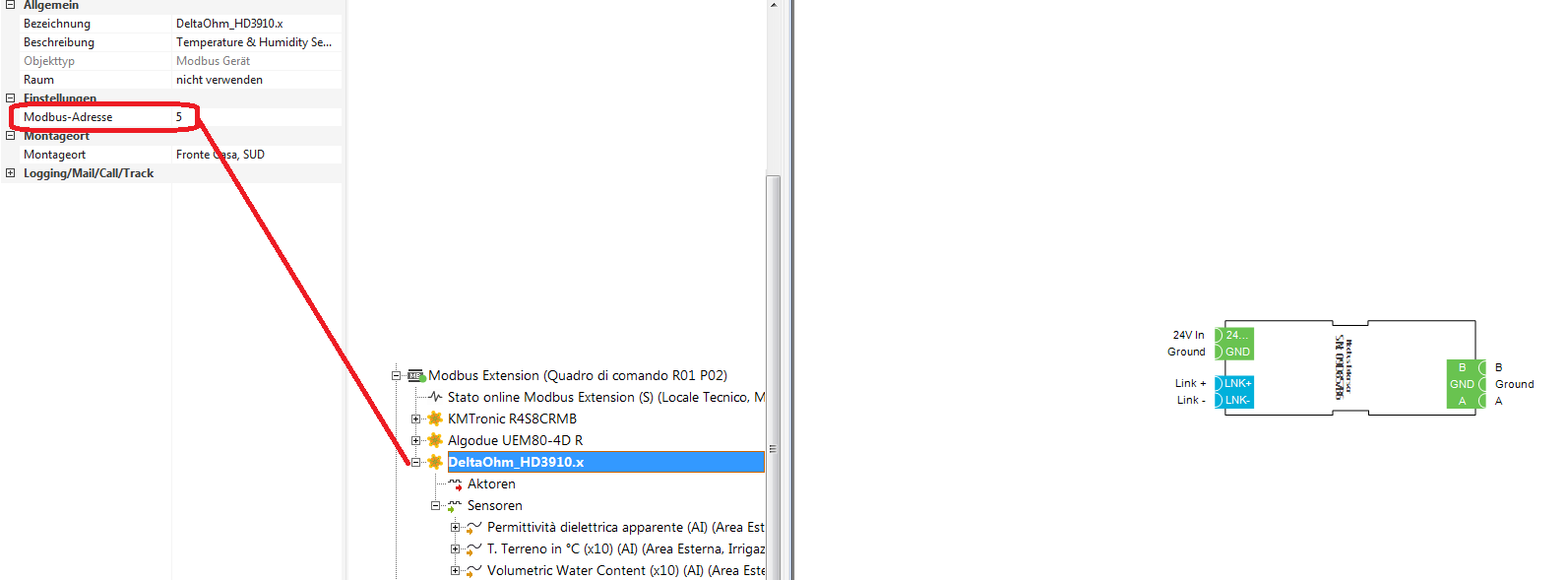

                  Also are you sure the address is correct in your last screenshot is address 5, but in loxone you are using Adress 1?
                  • Pippo74
                    Pippo74 kommentierte
                    Sure :-( ! I've just included the configuration screenshot since I forgot in when I raised the Question at the beginning.

                    eh eh, things are becoming quite complicated here... I've tried to play with diffent polling time and delay on both Modbus extension and device, without any result...
