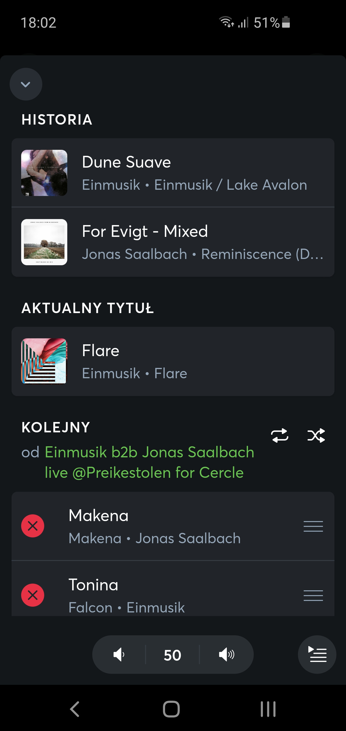

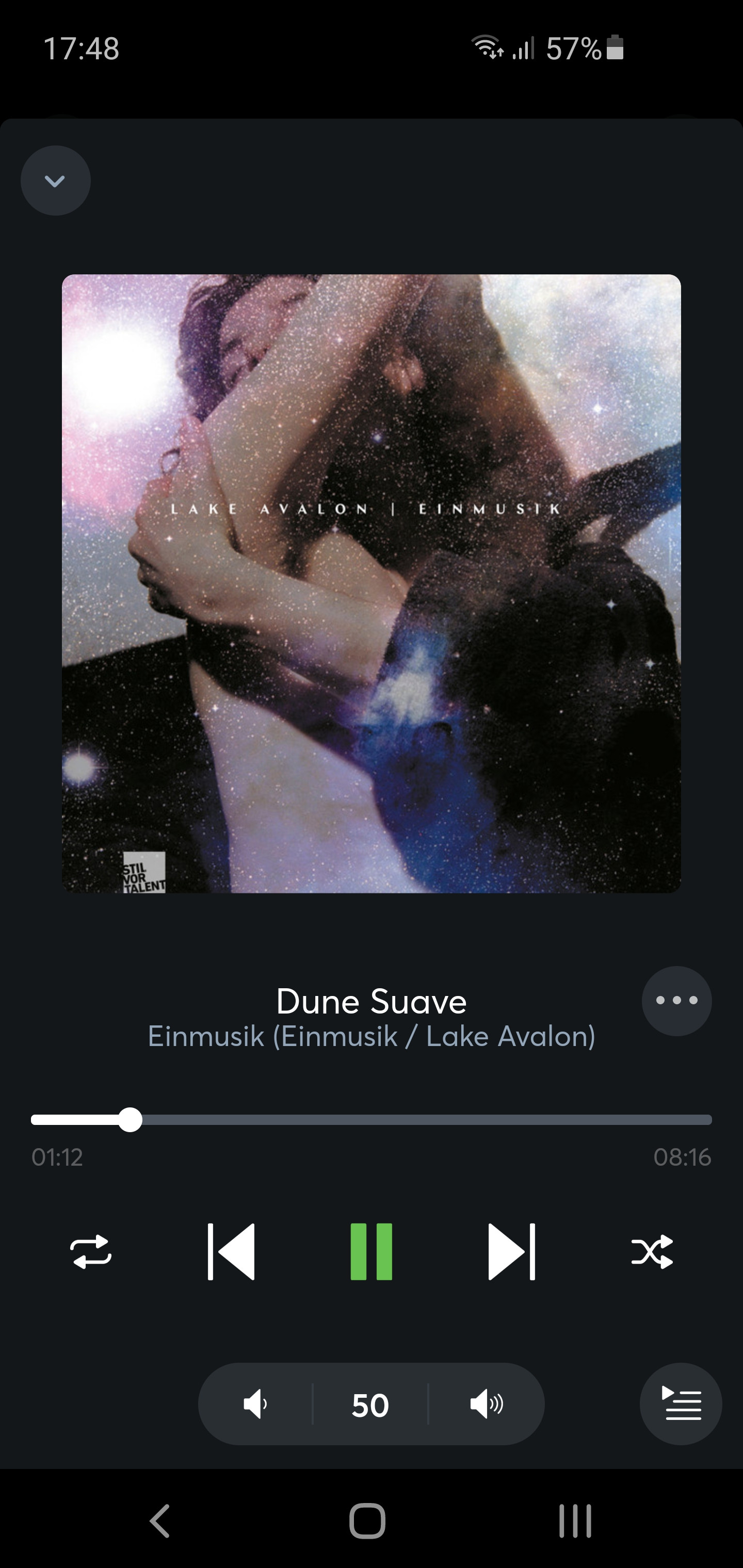

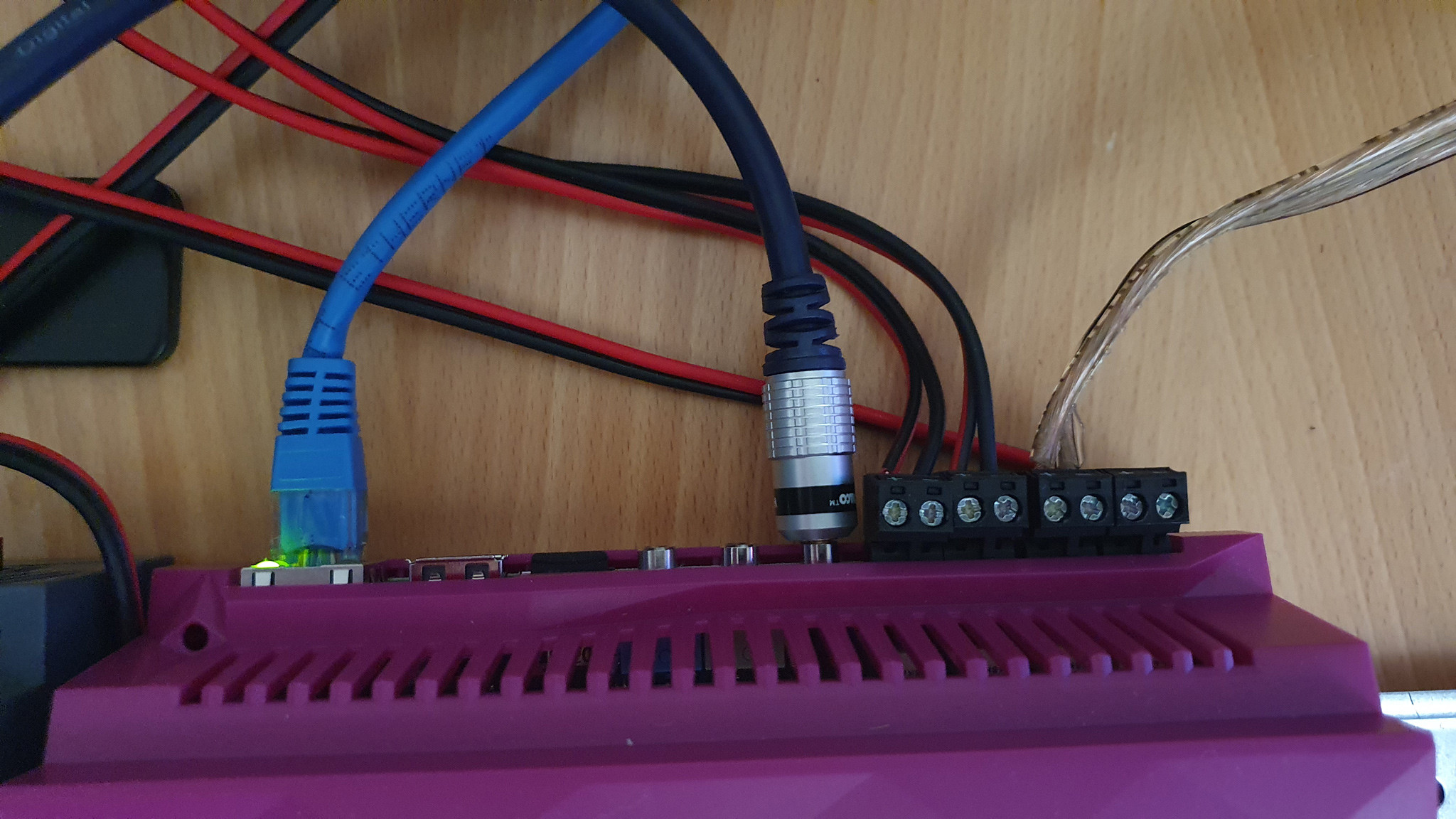

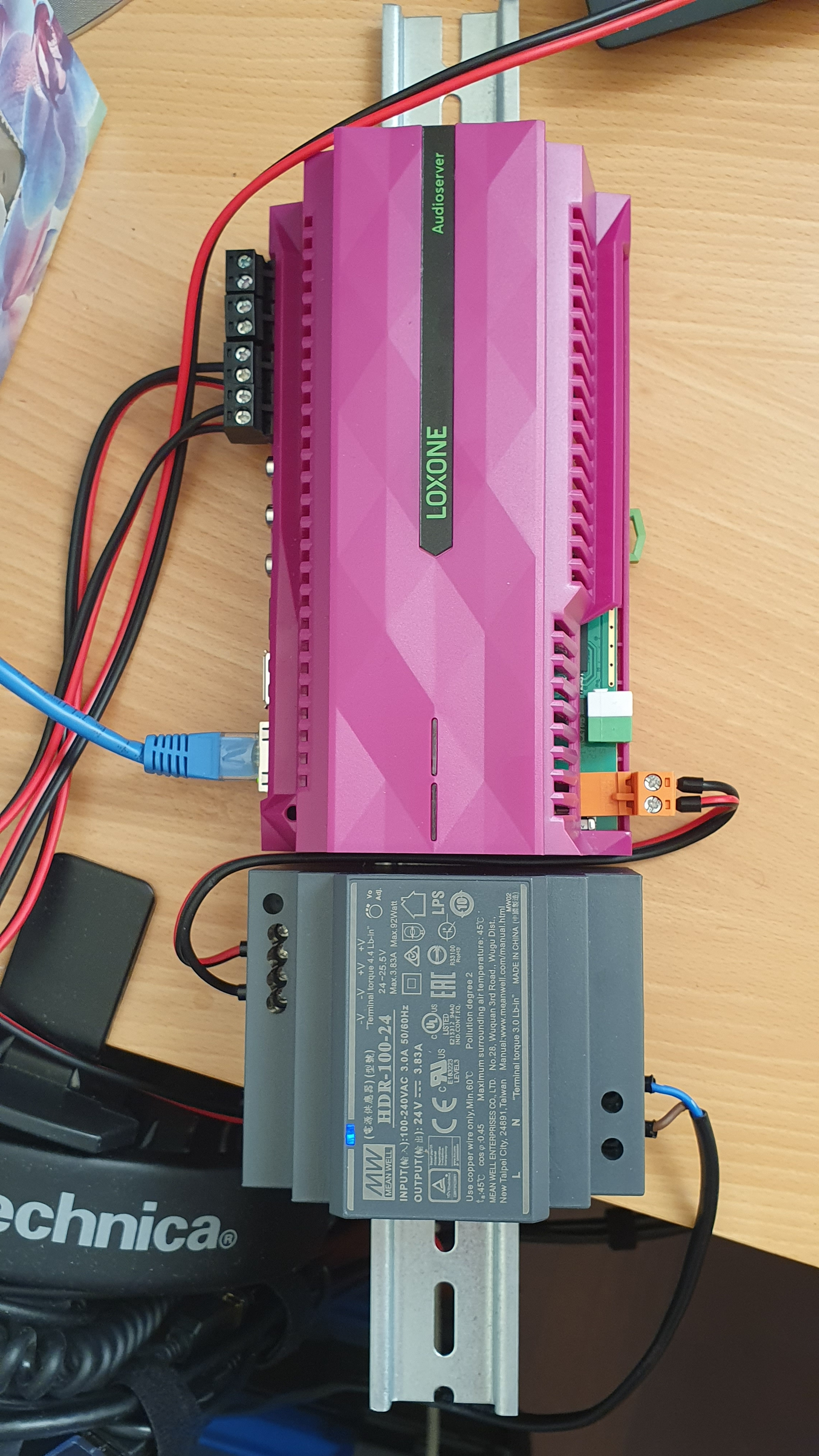

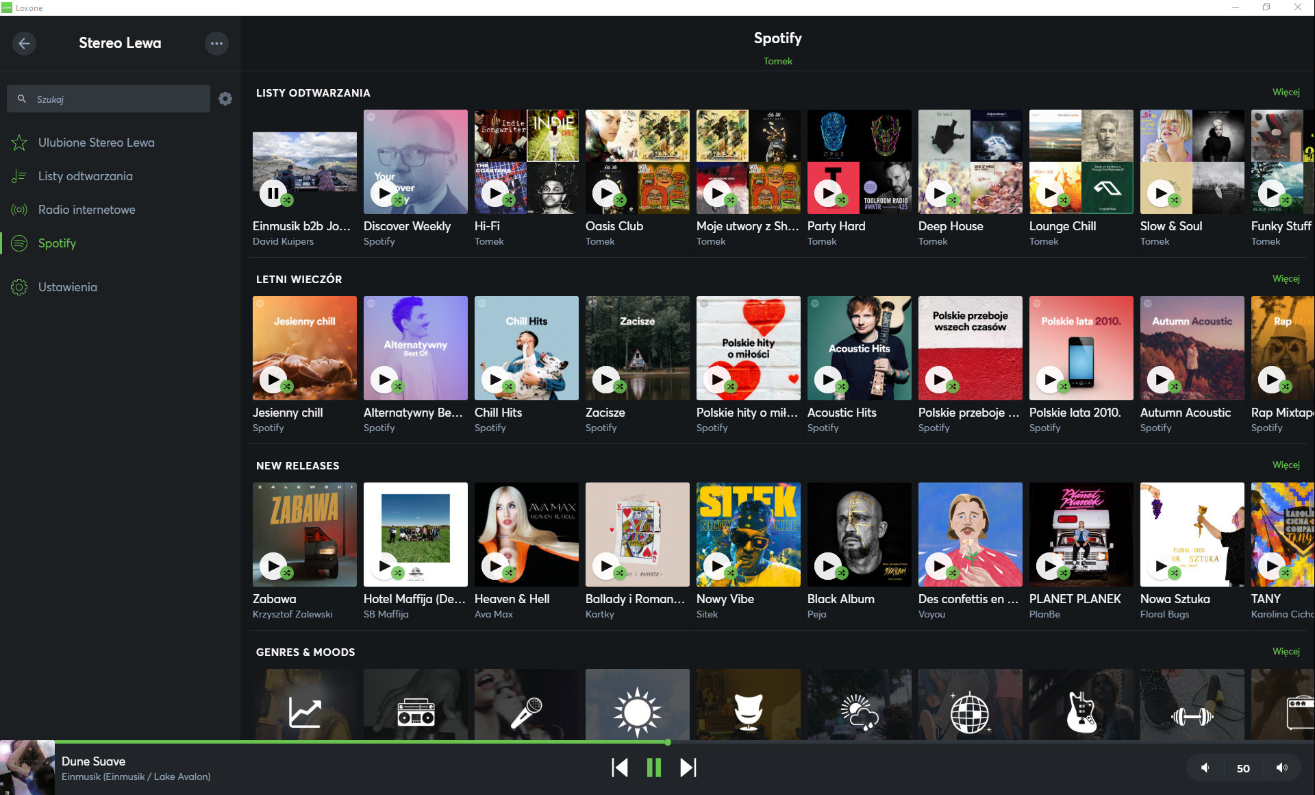

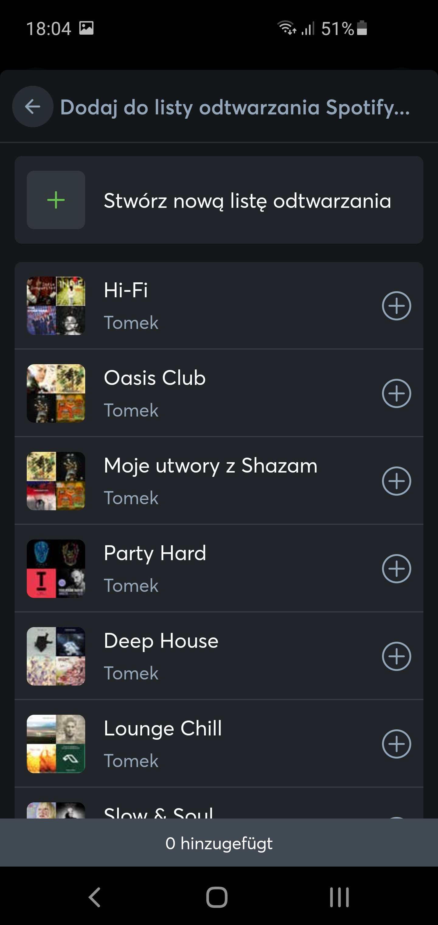

      So I received my Audioserver today and I must say, that I'm mostly satisfied with it so far.
      After connecting it to a pair of random and rather shitty speakers I've been playing music on them for two hours Audioserver seems to drive them quite well.
      My first observations:
      Pros:
      • Audioserver setup process is a breeze
      • Speakers I've used for testing were load enough. I believe AS amp power is enough for most.
      • Binding Spotify account to Audioserver is a breeze
      • Level of integration with Spotify is truly amazing. I wasn't familiar with Loxone Music Server, been using only MS4Lox before. Creating playlists or adding songs to Spotify playlists from Loxone app is wow to me.
      • Whole UI of new Audio Player block is good (with minor grapes that are easy to be fixed or improved in future)
      • Current playlist, with songs history and songs queue is superb!
      • Voice recording feature for voice communicates distribution is great!
      • Spotify Connect works well both ways
      • Power usage seems to be insanely low: 2.8 W in idle, ~5.0 W with 2 speakers playing
      • Stereo downmix works fine and is a breeze to configure
      Cons / Limitations / Bugs / Things to be improved:
      1. No volume slider anymore. Just (+) (-) buttons. Loxone, why did you change it? I'm not sure if that is any good yet, but I'm sure it brakes UX compatibility most popular player UI's (Spotify, Tidal, Sonos)
      2. Players don't remember volume settings. You set default volume and the player always starts with that default volume, even if it was paused for 5 seconds. Stupid.
      3. Shuffle function seems to be different to what I know from Spotify. At least in my Audioserver it's not a "state" of playlist, but a pulse action in Loxone to mix queued songs over every time you press it. Not sure if this is a bug or it was been changed by Loxone intentionally.
      4. Small green shuffle icon showing up on every single Spotify playlist in my app is totally unclear (see screenshot #2 below). I just still don't get it, how does it work and what does it mean.
      5. Audioserver resets its hostname all the time to a default ASXXXX where XXXX end of mac address / serial number. You see it in Spotify Connect as target (ie. Bedroom @ AS0D34 instead of Bedroom @ Audioserver). Update to this: it resets hostname to default if you set a name to "Audioserver" - seems that this name is forbidden, haha. That's silly.
      6. No Spotify cheating anymore (like it was with LMS and Spotty plugin). One Spotify account = one player (or player group?) streaming at a time. This is pretty clear but brings many complications such as a need to share all playlist among all Spotify family accounts and other (like new songs being added to common playlists from different accounts). It will be a mess.....
      7. I don't see a way to group zones in the app [yet?]. As far as I know previous Music Server has had it. I know Sonos app has it. It would be a shame to Loxone if Audioserver didn't have it. Yeah, I know you can group players from Config, but the point is to do it on the go from mobile or from logic.
      8. So currently the only way to group players / zones is using Audio Player Fixed Group block in Loxone Config. Fixed Group has no UI representation at all. Player group control is somehow hidden in the UI - you need to enter one of group players and in the bottom left corner on mobile (and bottom right corner on Windows app / web) there is this yellow group icon. Taping or clicking it pop-ups a layer with group and individual players controls. This is the only way to control whole Fixed Group start / stop / volume from the user interface and I find it not very intuitive and not exactly convenient (but I need to use it for some more time to judge). Also, volume setting is not remembered (see #2), so after you tune in volumes of your players in group, you loose it all just stoping/pausing your music :/
      There is so much more I didn't test yet, such TTS, alarms, doorbells, etc. But I definitely will
      To me, if Loxone sorts out those issues / limitations above and adds Airplay2 support soon, people will love this product.
      I attach some screenshots and a short videoclip from my tests (headphones rather required):

        To my current knowledge, audio UI is in every interface
        But its a bit different in Windows app, Web interface and on mobile devices. At least that's what I've discovered so far:
        1) Windows app: when you click the cover in the bottom left corner (or to be specific: left side of bottom bar) - you get the current playlist (with history and next songs queue). When you click it second time - list is replaced by the player.
        2) Web interface: when you click the bottom bar (anywhere) - you get the current playlist (history, queue). Second click closes it. I see no way of displaying the player view on the web.
        3) Mobile: when you click the the bottom bar (anywhere) you get the "Spotify-like" player view. To get the playlist you need to click the icon in bottom right corner.

              I have finally managed to connect Audioserver to Yamaha AV receiver (RX-V685) over S/PDIF.
Ansichten: 3127
Größe: 485,0 KB
              I works, but I have one important note and one bad observation:
              1. I was prepared to connect it with a standard 75 Ohm S/PDIF Coax cable that is RCA-RCA. No use here. You need to have a non-very-standard Mono-Jack 3,5mm <-> RCA cable as SPDIF output in Audioserver is NOT RCA but Jack. Yeah, documentation says that, but who reads it first ;-) So that's just a pro-tip from me - buy a proper cable first.
              2. There is something very wrong with volume level on S/PDIF output of Audioserver (it's MUCH to low). With a decent 5.1 speakers set on my Yamaha AVR, I had to set volume on the Player in Loxone to almost 100% and then ~ -25dB on Yamaha, to make any real use of my speakers set. Similar to shitty 4" Harman/Kardon speakers connected to Audioserver Amp on 35-40% volume. Changing Gain settings in Player parameters doesn't seem to have any impact on S/PDIF output.
                Anyone has similar observations?
              Zuletzt geändert von TomekWaw; 26.09.2020, 16:29.
                orli kommentierte
                Looks to me for a Support Ticket @Loxone....
