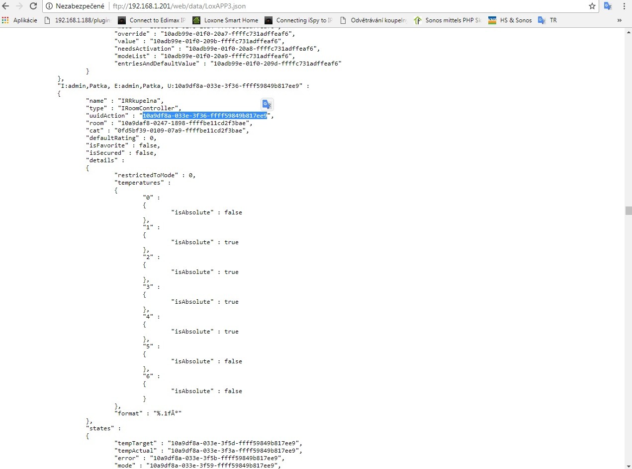

                  I have exactly same problem and I have no nano Air but normal loxone relay (Relay extension). How you solved it please?
                  • ager
                    • 15.11.2017
                    • 48
                    #448
                    Zitat von Peter B
                    Über UUID Ich sage "Alexa stelle Heizung Büro auf 22"
                    das ist der Befehl bei mir: http://User:PW@IP/dev/sps/io/0f4988bb-00c2-7ee7-ffff60abc14e2b3b/${intensity.percent}
                    das steht im Json File
                    "name":"Sollwert Büro","type":"ValueSelector","uuidAction":"0f4988 bb-00c2-7ee7-ffff60abc14e2b3b","room":
                    Sorry for english but no way in German
                    I dont understand.
                    If I am using:
                    http://username:pw@192.1.1.1/dev/sps...g/settemp/1/23 it is working for me.
                    If I use: http://usernameass@xx.xx.x.xx/dev/sps/io/10a9df8a-033e-3f36-ffff59849b817ee9/settemp/1/${intensity.percent}
                    it is working to me in HA-bridge.
                    In both case I am using UUID of IRR as you can see in the picture.
                    But it is not working by alexa. What I am doing wrong please?

                      Hello again. So finnaly this command (last one in me post):
                      Working with alexa but I cant say degrees. (nothing or percentage is working).
                      set:
                      1. Alexa, set the living room thermostat to 23 degrees. (not working)
                      2. Alexa, set the living room thermostat to 23. (working)
                      3. Alexa, set the living room thermostat to 23 percent. (working)
                      Increase:
                      1. Alexa, increase living room thermostat temperature by 2 degrees (not working).
                      2. Alexa, increase living room thermostat temperature by 2 (working).
                      3. Alexa, increase living room thermostat temperature by 2 percent (working).
                      Decrease:
                      1. Alexa, decrease living room thermostat temperature by 2 degrees (not working).
                      2. Alexa, decrease living room thermostat temperature by 2 (working).
                      3. Alexa, decrease living room thermostat temperature by 2 percent (working).
                      Do you have same or I am doing something wrong please?
                      Thanks for any help!
                      • Muto
                        Muto kommentierte
                        That´s working as intended as Alexa is not aware your "living room thermostat" is a thermostat. Alexa thinks it is a hue lamp named "living room thermostat". Ofcause she can set it to 2 (percent) because she thinks she is dimming the hue lamp (to 2 percent). But she is not able to set it to 2 degrees as this does not make sense for a lamp
