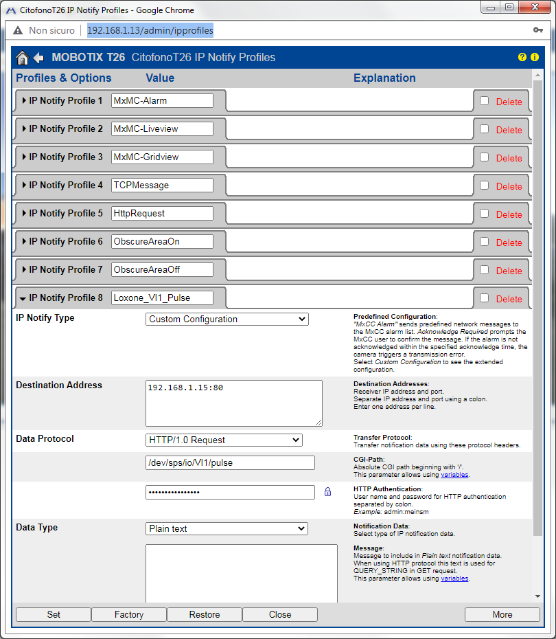

            Gents.
            may you please give me a way how to configure a Virtual Input in Loxone Config how to get the Bell from a Mobotix T26 ?
            I've defined the Virtual Input in Mobotix:
Ansichten: 187
Größe: 104,8 KB
            Should I define a standard Virtual Input or an HTTP Virtual Input from Loxone and in which way?
            Thanks a lot.
