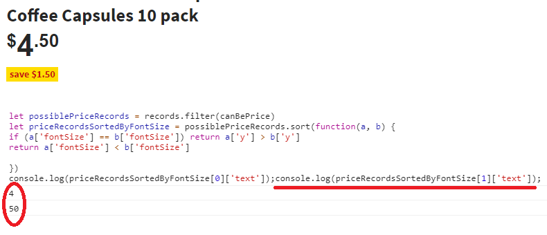

    I'm curious if anyone has employed a web-scraper on the Loxberry? By this I mean extracting data that is beyond a normal Loxone Virtual HTTP Input.
    My goal is to extract the price of my favourite coffee capsules and send an email alert/notification through Loxone if they go on sale. My automated house runs on caffeine before electrons...
    I've analysed the 'view page source' of the online shop but the price-point is completely obfuscated.
    I have found the attached JavaScript snippet that pulls the price from any given web-page. It does this surprisingly successfully.
    https://www.scrapehero.com/how-to-sc...merce-website/
    Installing Puppeteer and operating the script in a headless mode seems a viable option on the Loxberry. Unfortunately it's also beyond my meagre skills.
    There is a tutorial for Node.js as well. Node.js is installed on LoxBerry 2.x.

      Notwithstanding, I did manage to use their script to get my coffee capsule price (with a minor tweak) -
Name: Web scraper.png
Ansichten: 401
Größe: 26,6 KB
      But as you say, this might be a very different challenge from a non-browser based intercept.

        But now I'm stuck....
        I can successfully copy/paste the coffee scraping script into the console in Chrome browser and see a result.
        I can successfully run the Loxberry Puppeteer installation with the example hotel scraping script.
        I'm having no luck guessing where to cut out the hotel specific part of the script and replace it with the coffee script in Puppeteer.
        I've tried the most obvious location at line 16 below // get the hotel elements. That's returning an error as pictured below.
        Working coffee scraping script in Chrome developer console -

        Non-working coffee scraping script in Puppeteer -
        PHP-Code:
