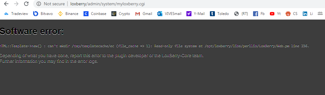

    Hello, sorry for the English, I'm a new LoxBerry user.
    My LoxBerry worked fine for a few days but after adding and removing new plug-ins I now can't use any of the System Settings. Can anyone help me please?
    I also can't shut-down the LoxBerry.

    Please run the health check: https://www.loxwiki.eu/display/LOXBERRY/Healthcheck
    seems that your filesystem is broken.
    ps: please no double posts.
      l tried the Healthcheck method using PuTTY because the LoxBerry Widget is not working.
      This is the result:

        Hello, I did a sudo reboot command using PuTTY and all the widges are OK now. Thank you for the help.
          • 5359
          I wonder that the healthcheck says rootfs is writeable while your error message says it isn't... Good to know that the reboot fixed the problem.
            Das fs, dass „read-only“ war, war tmp, also die Ramdisk. Also wird die wohl voll gewesen sein, oder?
            Stimmt, war /tmp. Wobei es komisch ist, dass die ReadOnly war und nicht nur "full". Naja, geht jetzt ja wieder...
