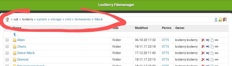

    Hello,
    I installed LMS on the Loxberry.
    Everything works fine, but now I want to acces my music that's stored on my NAS.
    I tried to mount the folders via the "netshares" plugin.
    That worked. But I still can't view the folders via LMS.
    Do I need to mount the folders another way?
    Somebody told me to use fstab. How do I do this?
    Thanks in advance
    If you see the share in the Netshares widget, it is already mounted.
    Now open the Filemanager widget, and browse to /opt/loxberry/system/storage/smb/YOURSERVER/YOURSHARE/YOURMUSICPATH
    You should see your music files and folders.

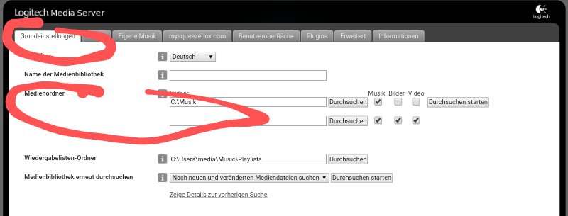

    Now you need to set this path (/opt/loxberry/... like above) in the LMS Settings at the Basic Settings tab. There the path to the music library has to be set. Possibly, a restart of the LMS service is required.

      Dear Christian,
      Fantastic! A restart of LMS solved it.
      You spared me hours of headaches :-)
      Thank you very much.
