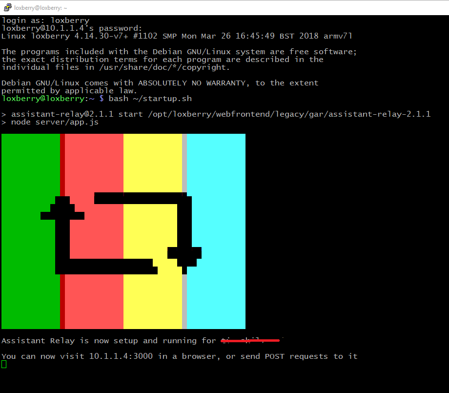

    I can start the Google Assistant Relay manually if I run -
    bash ~/startup.sh
    Klicke auf die Grafik für eine vergrößerte Ansicht  Name: assistant relay working.png Ansichten: 1 Größe: 38,1 KB ID: 172713

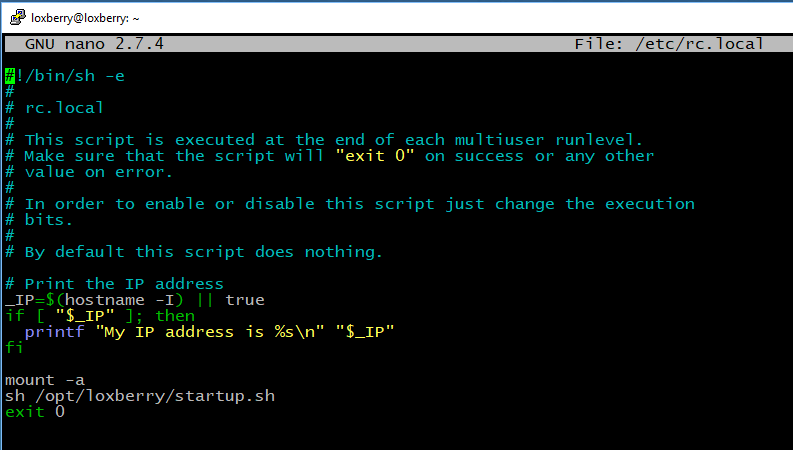

    I've edited rc.local and added the following -
    Klicke auf die Grafik für eine vergrößerte Ansicht  Name: rc.local editing.png Ansichten: 1 Größe: 27,3 KB ID: 172714
    It stills refuses to start automatically on Loxberry reboot.

    after starting up manually you are getting back the command line? It looks like you don’t. If you don’t get back the command line, you have to add a blank and a & at the end. So it tells the shell to run the command in background. Your script is runnable itself, so you don’t need to add the sh before.
    Try it with ‘/opt/loxberry/starup.sh &’ in the rc.local. But remember, it is possible that your script will be deleted in /opt/loxberry during a loxberry update. Move it to your legacy dir and the run it from this dir.
