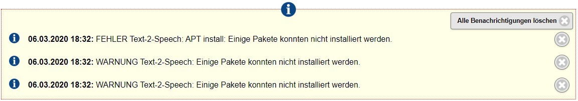

    Text-2-Speech und Sonos funkt gerade nicht bei mir
    Bei mir hat Sonos in Kombination mit Text-2-Speech und Kalender-Plugin (Müllansage) immer super funktioniert. Aber nach dem großen Loxberry Update ist da irgendwie der Hund drinnen.
    Da meine Vermutung war, dass es am Text-2-Speech Plugin liegt habe ich dieses mal neu installiert und siehe da schon die Installation konnte nicht korrekt abgeschlossen werden.

    Hat jemand eine Idee was hier das Problem ist ?

    Hello,
    I have the same problem. Can anyone help me to resolve this. TTS has always worked weel, but for any unknown reason, it doesn't work anymore. I have reinstalled the plugin and i received the same errors as Gregor. When I send a TTS command via the browser, it also doesn't work anymore. Only the gong or any other MP3 file stored on the loxberry works. When i monitor the sonos app while sending the TTS command, i see an error message indicating that the MP3-file has an unknown format.. Can anyone help me to resolve this issue ? Many thanks
      • 6357
      In much posts you can read, that RespVoice has changed his API and does not work. You have to use another service

        • 7
        Hello, thank you for your fast response. I have changed the provider to 'voice-rss', but the problem is still there. I can play every mp3 located on the raspberry, but TTS doesn't work.... I see still the same error in the sonos app when i launch the command from a browser to test the TTS. any other suggestion ?

          It works !!. My TTS volume was too low to hear the voice. Thanks for your help !!
