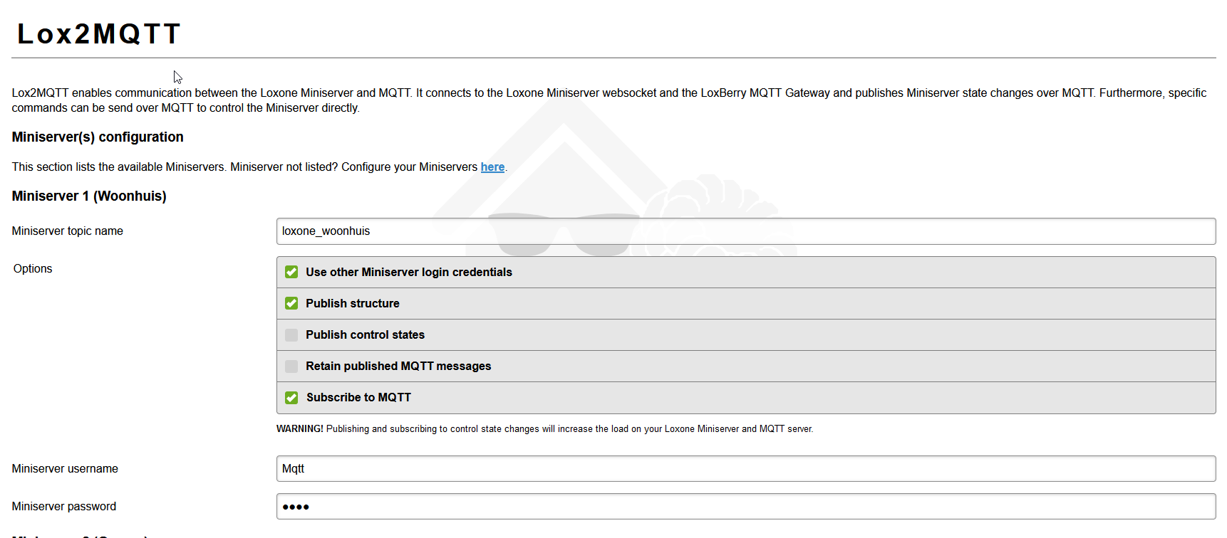

      O don't get this pluggin running.
      I use 2 miniservers ( 1 Gen 2 and 1 Gen 1 )
      Can you help me a bit? Wat is wrong on this?
Ansichten: 435
Größe: 79,2 KB
      I see a lots of errors but dont now how i can fix this?

      • nufke
        • 10.11.2018
        • 67
        I see in your log file that the plugin tries to connect to 2 websockets at the same IP address but with different ports: 192.168.10.241:80 and
        192.168.10.241:443​. Are you sure you connect to 2 different miniservers? I would expect 2 different IP addresses here.
        Furthermore, the plugin does not support secure TLS for the Gen2 miniserver, which means you cannot connect using port 443. For your Gen2 miniserver you also need to switch to port 80.
        I also see you use login to your miniserver with account name mqtt. Not sure if this is intentional, meaning you might only do this when you have a separate LoxoneConfig account name mqtt for this type of communication. I would first try with the miniserver admin account.
        As a start, I recommend to start with only the Gen1 miniserver and admin account, and if this works start adding or changing things.

            Based on the shared log snippet, it looks like the websocket connection to the Miniserver is not established, so I expect an authorization issue. The websocket communcation and authorization is managed with an external library (codm/node-lox-ws-api), and not part of the plugin itself. Note that the plugin uses token-based communication with the miniserver, so you should at least have version 9 or higher on your miniserver.
            I've updated the version of the external websocket library, please try version 0.4.3 of the plugin. In case the issue remains, please share the first 10 lines of the log file at plugin start, starting with the text "Lox2MQTT 0.4.3 started".
            Another thing you could try is to test with your Gen2 miniserver (as the problem might relate to the Gen1 communication).

                So Gen1 and Gen2 (test separately) not working? Please disable other login credentials so it uses the same as loxberry.

                  Yes i try the Gen 1 and Gen 2 also on 2 different loxberry installations. Also when i enable or disable the credentials option.
