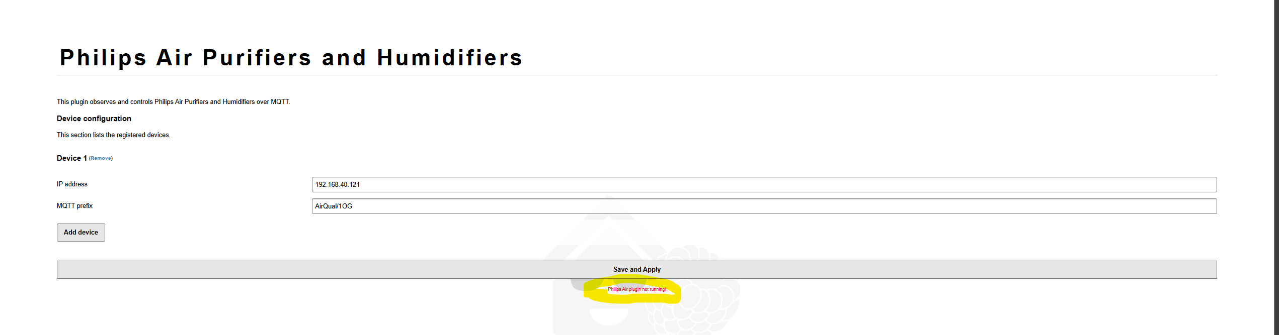

    Hi nufke,
    thanks for your work but the Plugin doesn´t start on my Loxberry. I only get a message like you can see in the picture. I already tried to restart the loxberry. Do you have any clue how to activate it?
Ansichten: 115
Größe: 55,5 KB

      Latest version v0.0.4 should resolve an install and build error when using newer nodejs versions. Please check if this works for you. If not, please send the log file.

        Hi there,
        thanks for your quick response. Yes now it looks pretty fine. MQTT topics can be found in the broker. Now I can try to set it up in my Home. I´ll give response to the items and commands because I am working on a AC4236/10.
