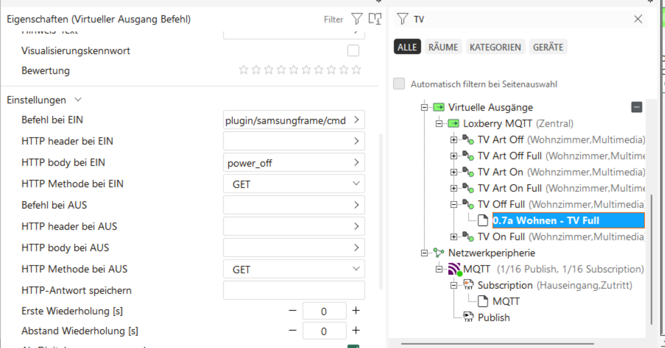

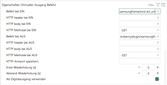

              Looking very interesting and pairing and testing via plugin page worked! But Sorry that I have to asked, but where do I configure the Output in Loxone? As an Virtual Output and if yes how or via the MQTT Publish Config in Loxone?

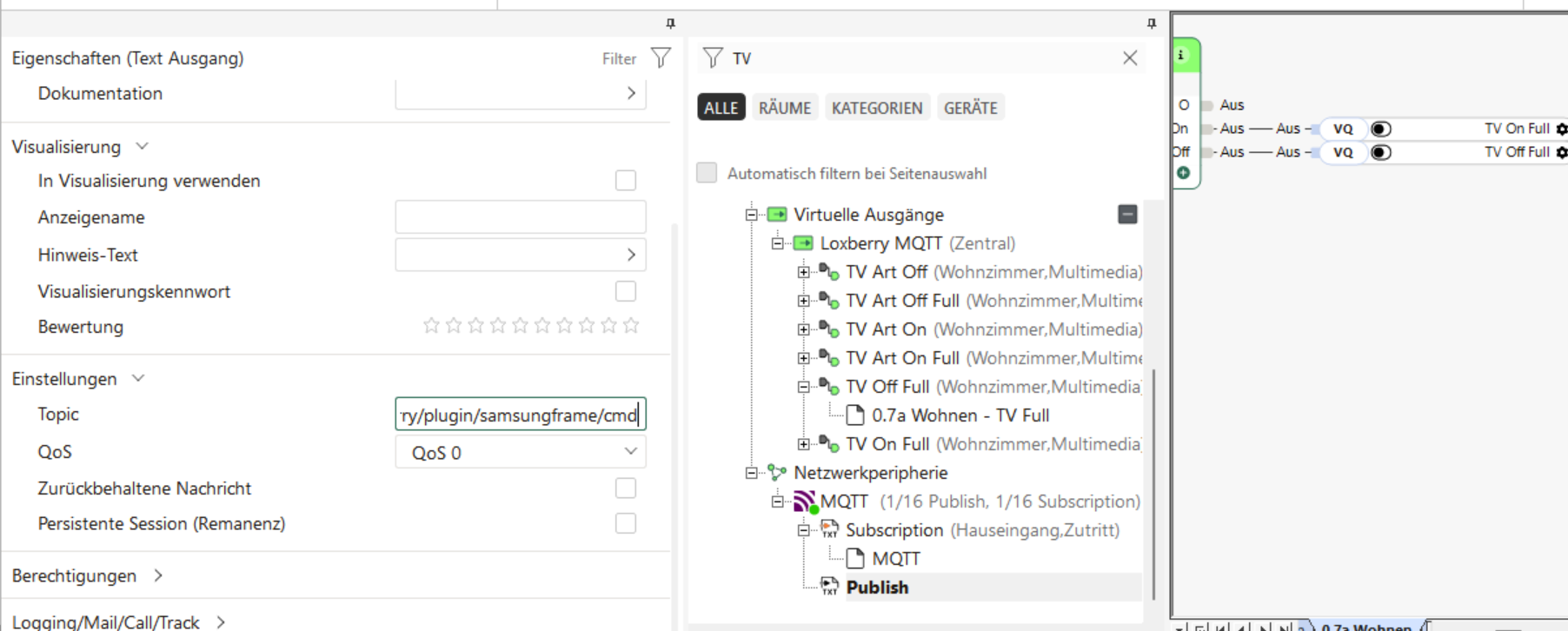

                You wil need to use MQTT , not Virtuals.
                loxberry/plugin/samsungtvslkmaster/cmd

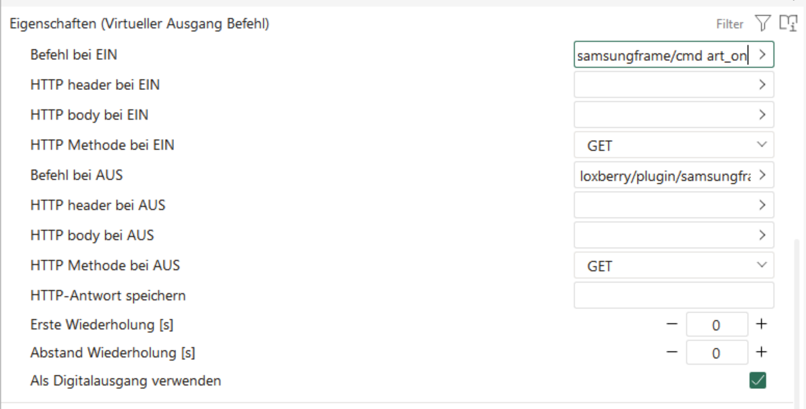

                  Thanks I was able to get this (Art On/Off) working yesterday with Virtuals to the Loxberry I am using.
                  Only thing which is not working even trough the plugin page http://loxberry2/admin/plugins/samsungframe/index.php ist power_off and power_on.
                  (BTW: And from time to time my 2022 65" Frame is showing the "LoxBerry Allow/Deny Popup" again in the top right although the pairing is stable)

                    Hi everybody, I'm happy to see how many of you are using the plugin already.
                    SchmuFoo The plugin caches and stores the token, so it shouldn't ask to allow after initial pairing. I have no such issues with it at least.
                    I also have the 2022 frame version, and I am using power_off command without issues. (I use it in combination with all off button)
                    Regarding the power off/ on not working, that's strange, because it's one of the most basic functionalities. But if it's not working from the app, it wont work from loxone either. Are you on the latest version?
                    Best is to switch to the latest (unreleased version). It has some more logging and might have some bugfixes (can't remember, but I think I fixed some smaller issues in that version). I will release is soon enough.
                    On that latest version, there is quite some info added to the logging, which comes in handy to identify issues.
                    I did configure everything using virtual inputs/outputs (see https://wiki.loxberry.de/konfigurati...lp/widget_mqtt for details). For me the integrated loxone mqtt functionality didn't work stable.
