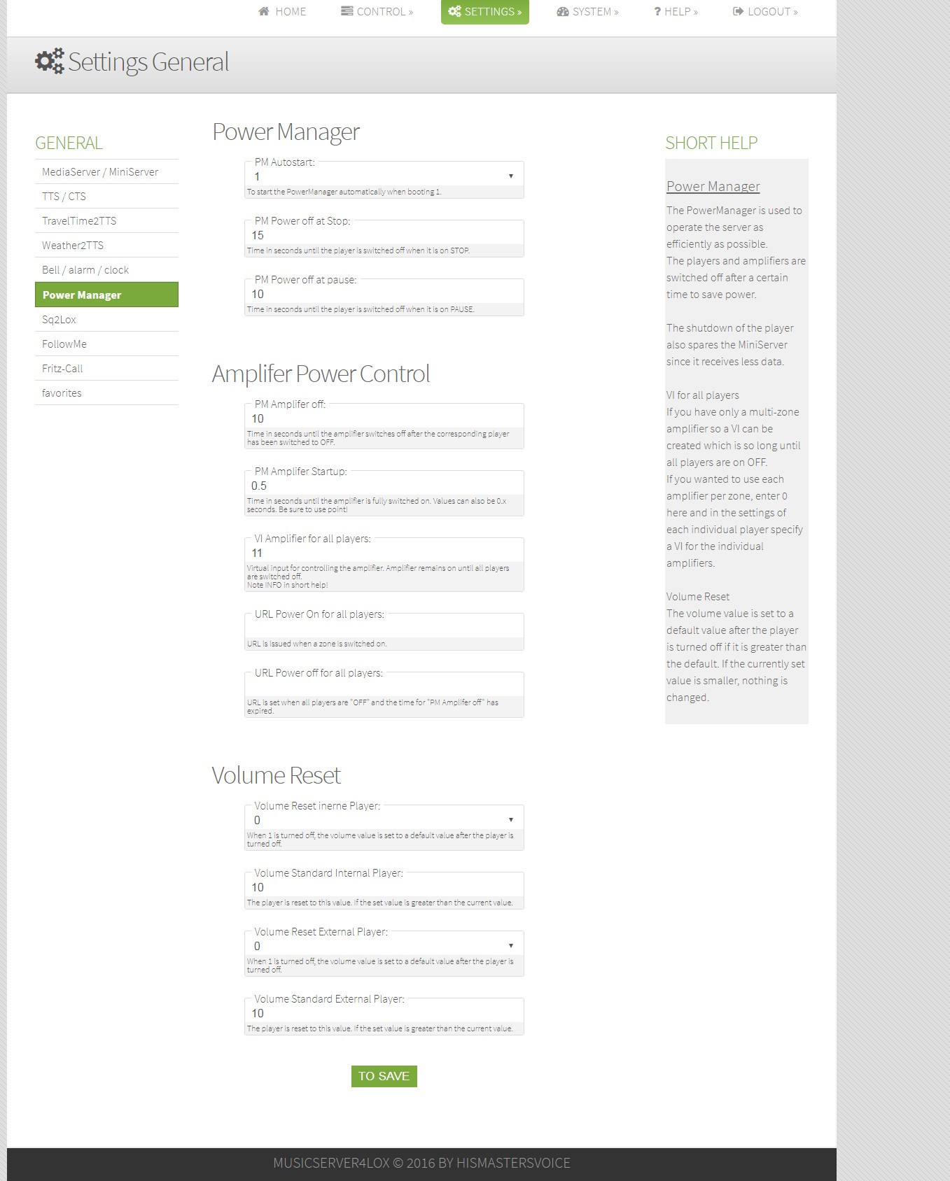

    Screenshot of your settings please...
      Power manager attached.

        I tested the function on my system, and it works without any problem.
        Try to setup a longer time eg 60 seconds.
        The VI is at on as long a player is @play or pause.
        After that the time begins to count.

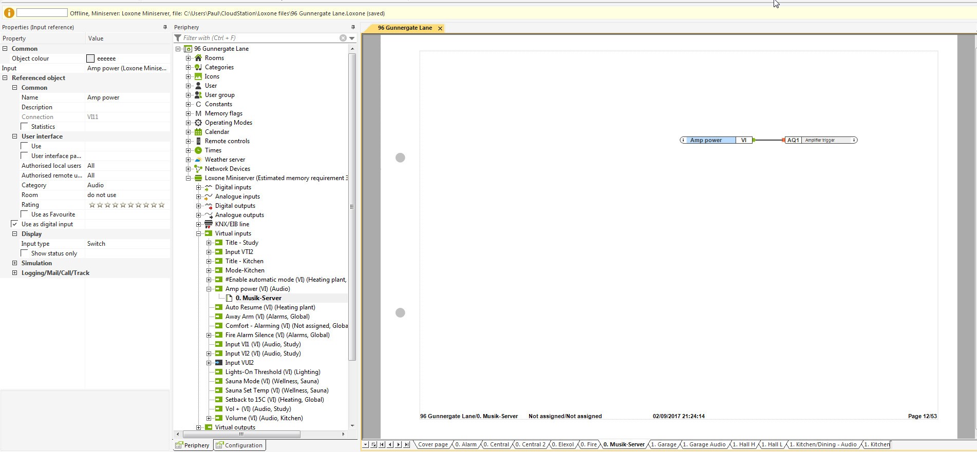

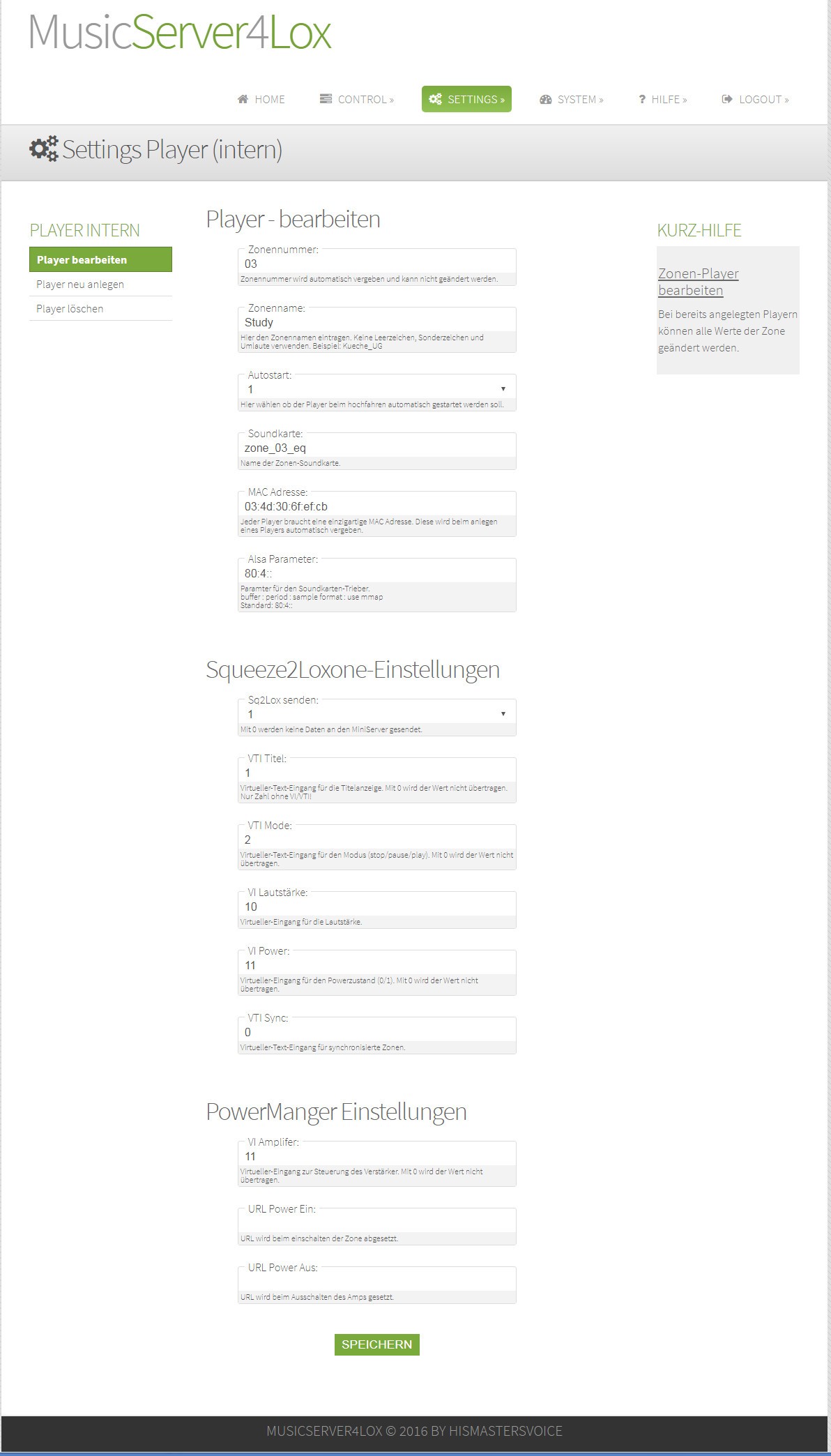

            Can you send me a Screenshot from 1 or 2 player settings.
            Also a Screenshot from the Loxone Config.
              Screenshots attached.

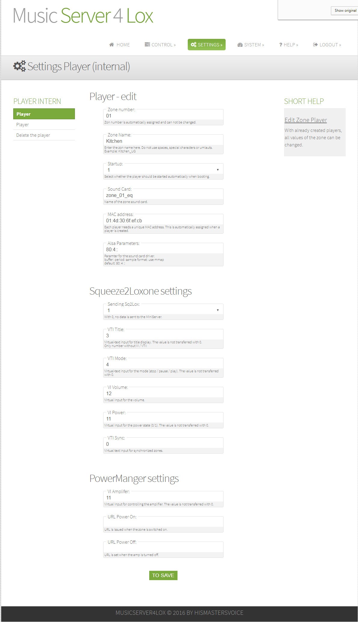

                Send me the files
                /opt/music_server/sq_cfg/zone/sq_zone_01.cfg
                /opt/music_server/sq_cfg/sq_pm.cfg
                  Yes version 0.49
                  I think I see the problem, LOX_VI_AMP[1]="0", in the zone_01 cfg file should be 11.
