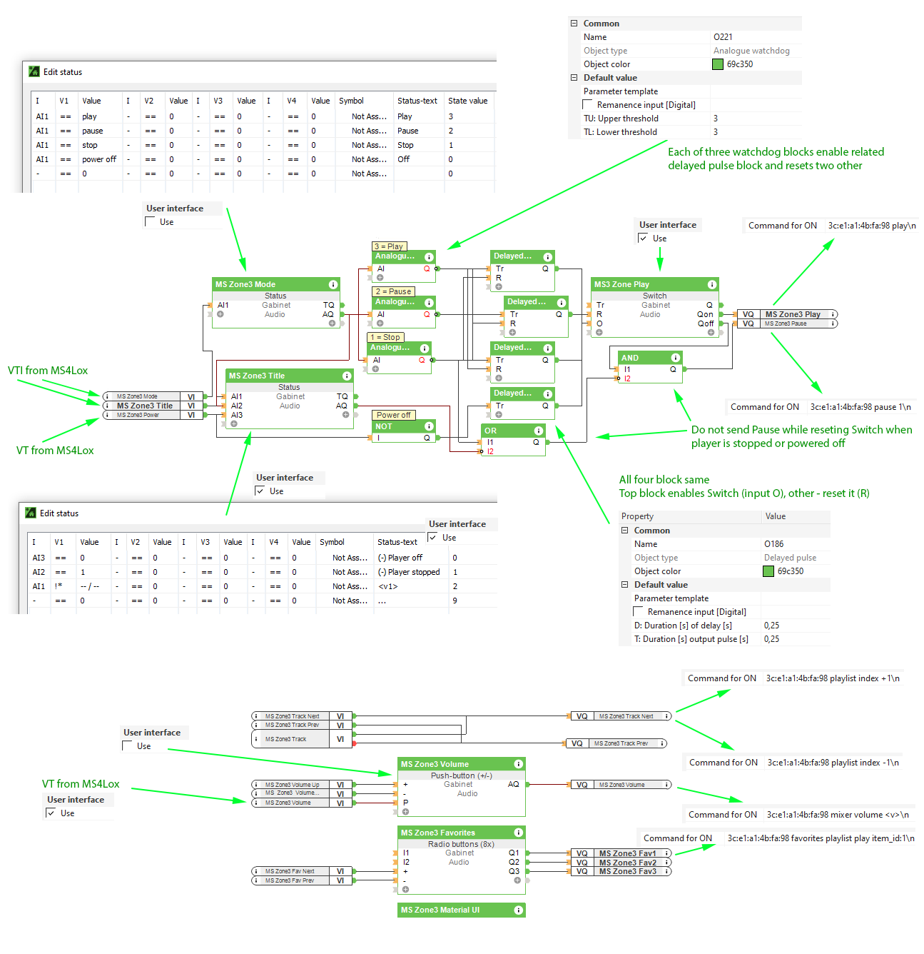

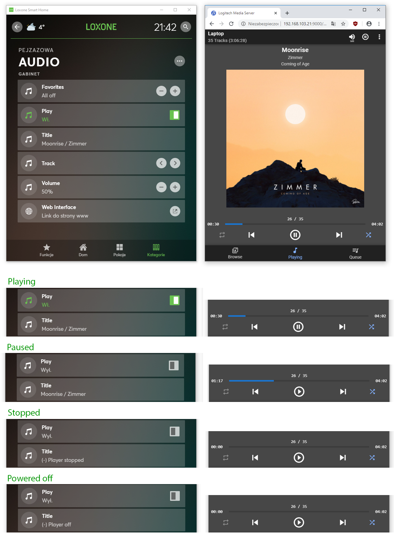

    Just wanted to share with you my little and amateur solution to minimize number of buttons required to control a zone in Loxone app.
    Same as in Spotify I don't care about stopping music (pausing is good enough) and also I don't care much if player is stopped or powered off as powering off might be automatic anyway. Having this in mind I tried to fit as much as it gets into two tiles / blocks and I've managed to fit: Play, Pause, Title, Stop status, Power status and indirectly Play & Pause status. Solution is probably not perfect but looks slick and seems to work fine (both ways: Loxone --> LMS, LMS --> Loxone).
    I hope someone might make use of it.

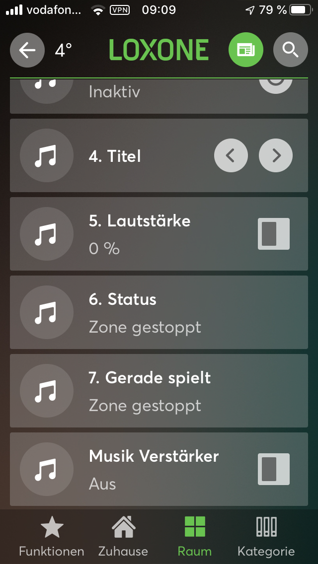

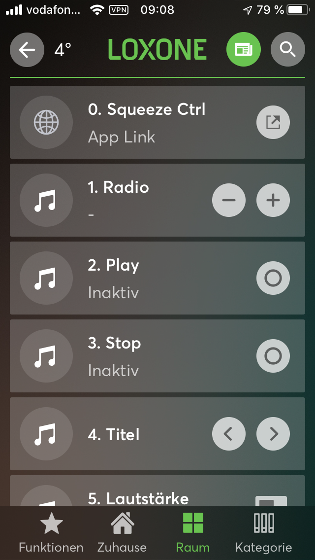

    I like it - quite compact! Attached is mine and I hate it ;-)
