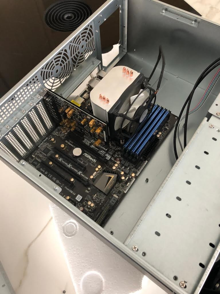

    HW-setup:
    - I5 3570K, on a asrock Z99 extreme4 motherboard, 16GB of RAM. (overkill I know, but we might install other services later on)
    - Asus Xonar AE 7.1 PCIE soundcard

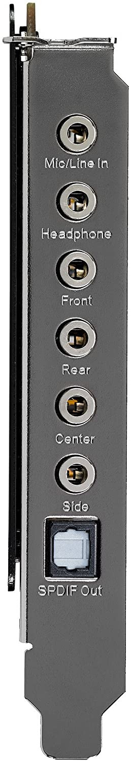

    That's the point we ALMOST gave up, and we started to bruteforce the settings in order to see what could finally make it work. The setting that did make it work was the selection of only 6 channels out of the 8 of the Xonar AE soundcard. Poef, the players started, and I could create 3 players (3 channels of my amplifier). Very strangely the players started, but the amplifier did misteriously not receive any signal out of player 2 & 3 (channel 2/3 & 4/5 of the soundcard). We tried connecting all possible outputs of the soundcard, it just did not work. Only the "headphone" output of the soundcard gave a sound output.
    Click image for larger version  Name:	716zyDZg0DL._AC_SL1500_.jpg Views:	0 Size:	96.2 KB ID:	261400
    It felt like MS4L selected the wrong audio card, like only the "headphone" was usable for some reason (i am no expert but i suspect that for debian there are 2 kind of devices, the "stereo/headphone" device and the "7.1 surround" device and MS4L could not choose the second one). (i do not have the support data any more of this configuration, you will understand later on why).

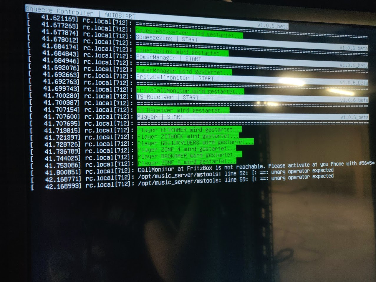

    - DON'T change the language settings directly from the GUI. We did that, and i think there was no language file and that make the WebGUI unusable (white screen), reboot did not help. We had to delete /opt/music_server and reinstall to fix it. (probably there are more elegant ways to fix it)
    - strange stuff at boot: mstools line 52 & 59 "[: ==: unary operator expected" but did not make it stop to work, so we ignored it for now.

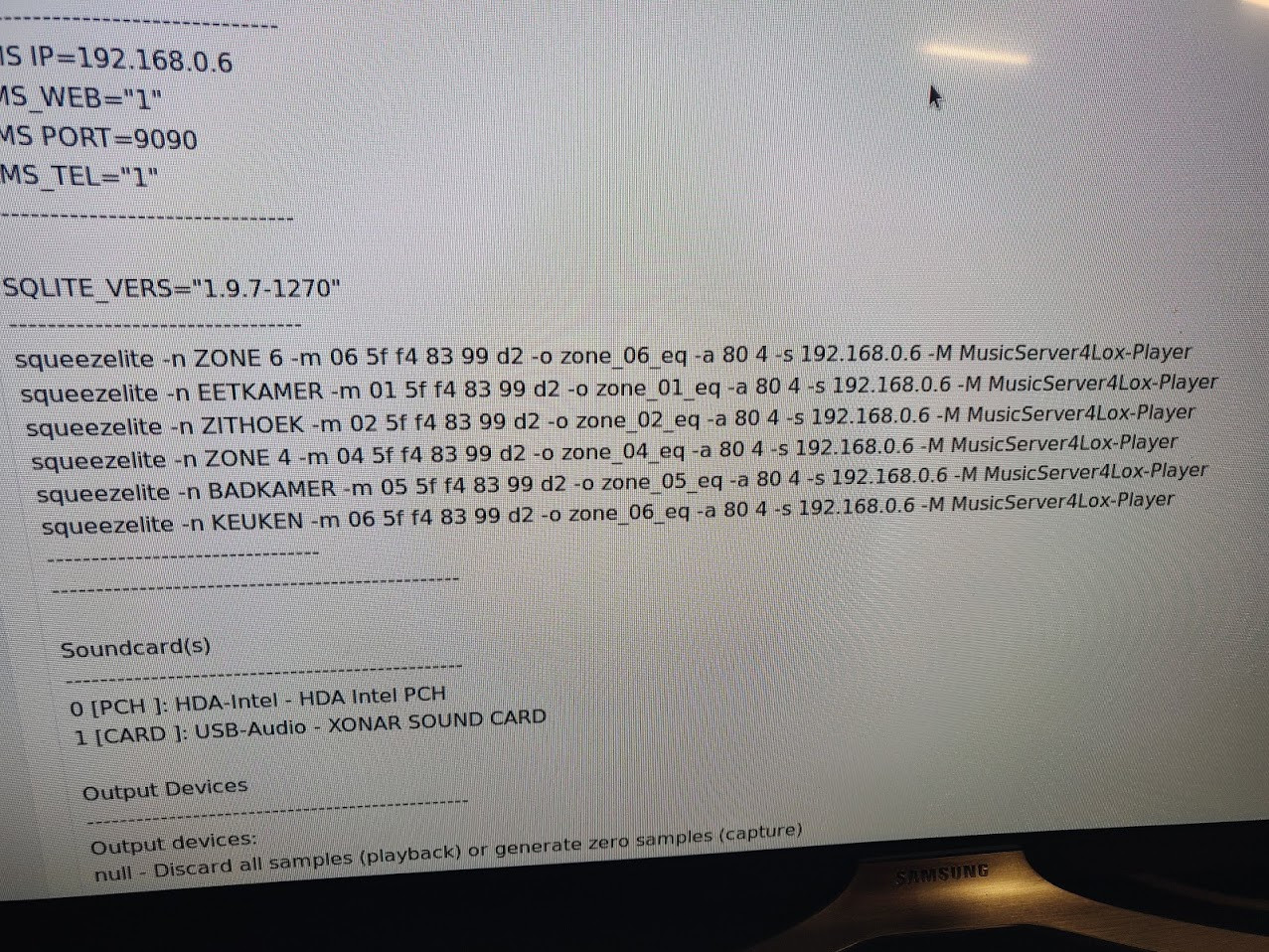

    - strange stuff in configuration data, we renamed a zone (ZONE 6 > "KEUKEN") but both are visible in the configuration data (ZONE 6 is not visible in LMS or MS4L dashboard, only KEUKEN is visible as a player)
    [EDIT] This fenomenon has disappeared
